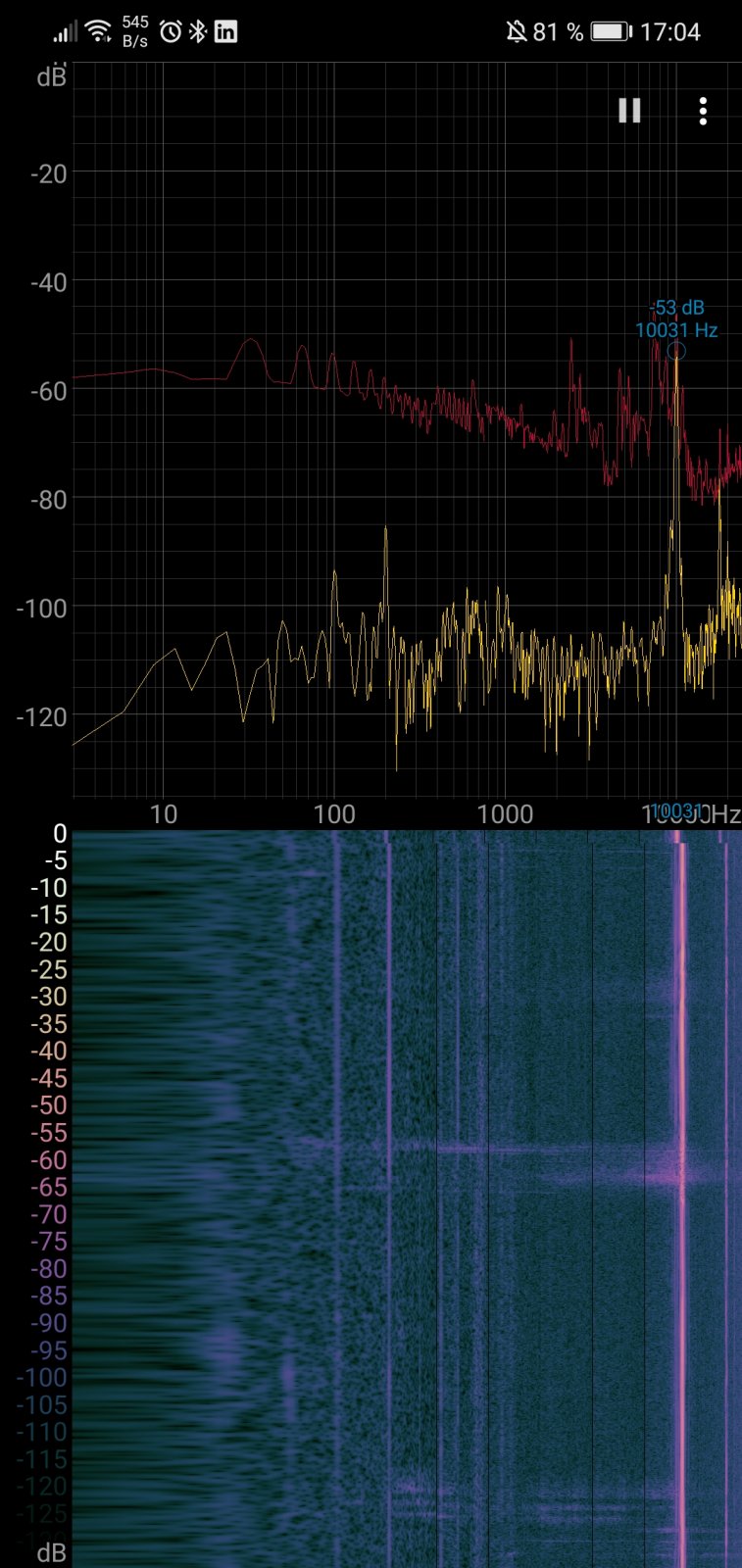

    My AASD-15A servo drives making noise (some people refer to it as a 10khz whining noise). Could you please let me know if you know how to fix the problem or reduce the noise?

    Your ground connection is floating!!!! Means it goes nowhere in your electrical panel of your house. See this video where I deliberately disconnect the ground and my servo does same trilling noise:
    Better get an electrician to check it out...

    I´ve got the same problem.
    Its exactly at 10kHz
    My earth (called PE in Germany and usually yellow-green cable) is connected correct.
    I also turned the plug in the socket to change power an neutral conductor.
    What i´ve seen is, that it only makes this noise when the AMC is powered. Could it be a ground difference between AMC and the ASSD15A?
    I use full pinned 2m DSUB Kabel where the shield is connected. So this should be no problem.
    I´ve also tested it with a power supply instead if USB to the PC but without noise reduction.
    My motors are connected with a fully shielded power cable an shield is connected on both sides.
    Do you have another ideo for testing?
    thanks in advance
    Peer

    I think i have the same issue. My ground is ok for sure as i had photovoltaic installation done a year ago and they added additional earthing outsider the house and made measures (around 8ohm). But when i check emf with a phone it shows reasonable values (around 30-40 uT).
    This whinning is annoying however i play in headphones so its problematic only at the begnning and end. Would like to get rid of it obviously.
    The fact it's there only when AMC is connected is because AMC has to drive actuators to standby position and then servo drivers are active.

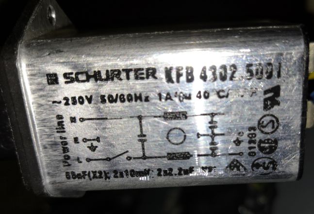

    Hi
    I have tried a Power inline filter but without any improvements or changes
    It´s still whining
    Maybe my problem is, that my house has no direct earth pin.
    My ground (N) and earth (PE) is only after a Earth leakage circuit breaker (FI) separated.
    So there are only the 3 Phases (L1,L2,L3) and the neutral conductor (N-PE) coming to my house.

    The EMI filter (line filter), is used to prevent EMI noise transmitted back to the power line and affect other devices connected on the same line like computer speakers, peripherals etc.
    The 10khz noise is going to be there, but what I'm talking about on my video is to make sure to have proper ground to avoid the "trilling" 10khz noise that is more annoying and more audible.
  13. SeatTime
    2,572
    +2,855 / 40 / -0
    Agree, the only way to get rid of the 'PWM' noise is for the manufacturer to change it to 20K or more.

    The EMI Filter was just a test if it helps with the earth line problem.
