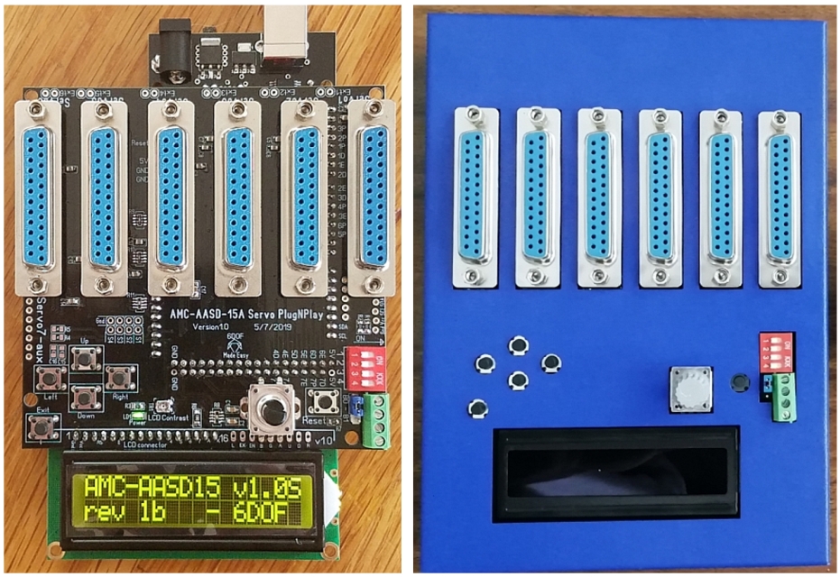

    My AMC controller has stopped working, specifically - the port servo number 3 is not responding, when I connect DB25 cable to it it doesn’t want to park or calibrate, the servo drive only displays X. The rest of the ports are fine. I suspect its because some motherboard connector is lose, as when I try squeezing the AMC controller it sometimes shows the park position. It is definitely not the fault of an actual DB25 connector, it is something else. Can you guys please help me somehow to find the fault and fix it ? :sos The AMC controller is only 3 months old :(

    One of the pins is not touching correctly it seems.
    1. Can you carefully pull apart the two boards (smaller Atmega1280 board that has the usb connector, and the top pcb that has the db25 connectors) ?
    2. Then take a photo of the bottom of the larger board to see if the db25 connector is missing any solder on its pins.
    3. Plug them back together and test again...

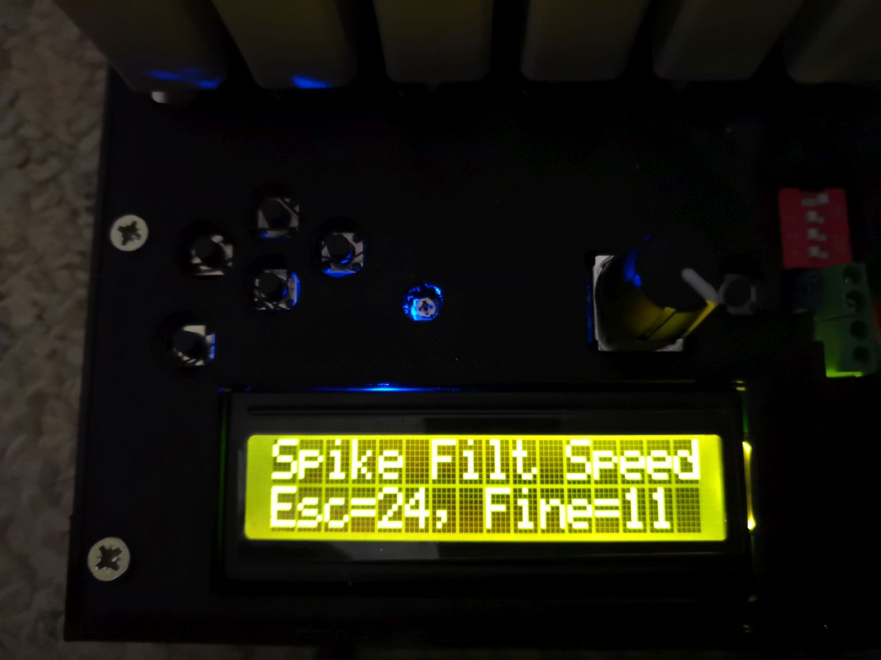

    Hi @Thanos
    can you please explain how to set the speed of the spike filter?
    What does "Esc" and "Fine" mean?
    Thanks in advance
    Peer
  9. Thanos
    Jul 6, 2017
    1,381
    Electronics Engineer
    United States
    2,931Coins
    +1,080 / 10 / -0
    Under Spike Filter speed menu:
    ESC sets the "Escape" speed that the actuators move during the spike filter trying to reach the real time target.
    FINE sets how close to real time motion data targets the actuators need to be to jump to live data. It defines the smaller distance before that actuator "locks" into the target position and jumps only if ALL the rest axis are also in locked distances... its less complicated that it sounds, lol.
    The servomotor speed is proportional to the rate of the pulses it receives. So the AMC sends the pulses with max rate possible to be able to synchronize the motion to all actuators and keep the positions as close to real time with the game motion cues.
    Less pulse rate is used when spike filter is active for example where the controller is not reacting real time but "following" slowly the real time positions, to create artificial motion instead the huge spike jump. But the slower motion is lagging behind, so its temporary until it catches up with real time positions again.
    So anything less than full speed pulses, will be lagging behind in normal use and will clip out vibration details of the road etc... you could use the pulse filter parameter in the AMC, which adds some ramping in the accelerations, to make motion a bit more smooth, but as I said will filter out some of the details.

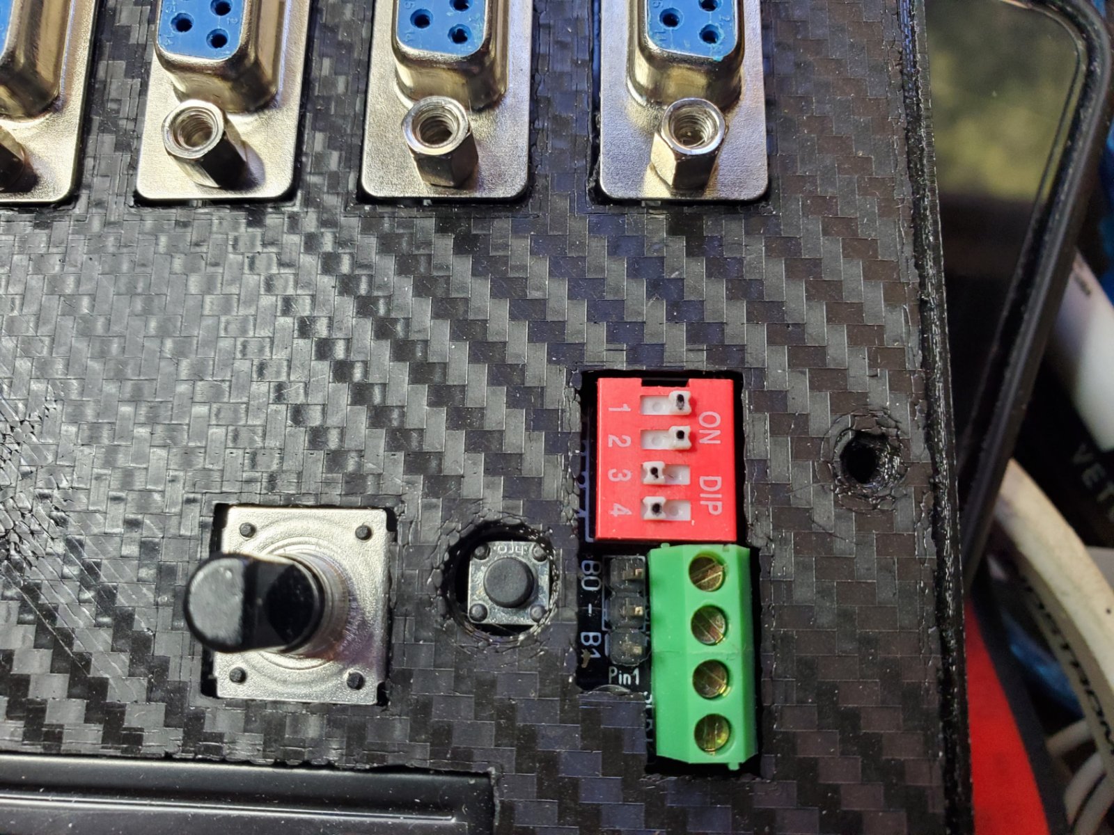

    Just make sure the DIP switch #2 is ON
    Thanos
  15. mark_44
    mark_44 New Member
    Jan 30, 2020
    19
    161Coins
    +10 / 0 / -0
    Ah yes, that was it. I turned it off during the update
    :rolleyes::blush

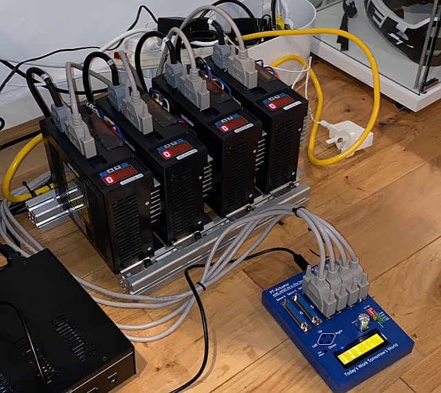

    Goodmorning everyone. reading the thread I understand that to connect the thanos AASD15A board it is very important to use a good quality USB cable (A / B) and also a performing USB socket. Right now I am testing my first actuator and I have found that the card does not work with any USB cable on all my USB ports. In some cases the card does not connect, in some other cases it connects but in the test phase on simtools it loses the signal and game engine crashes. Yesterday using a USB cable I think cheap (the blue one that comes with the arduino boards and is 30cm long) and connecting it to a usb 2 on the motherboard the AASD15A works well without any crash. I would kindly like to know if you can suggest me a good quality USB A / B cable (3m long) to use. I was also reading that it would be appropriate to use a powered usb hub. Which one do you suggest? Thanks. Gigi
