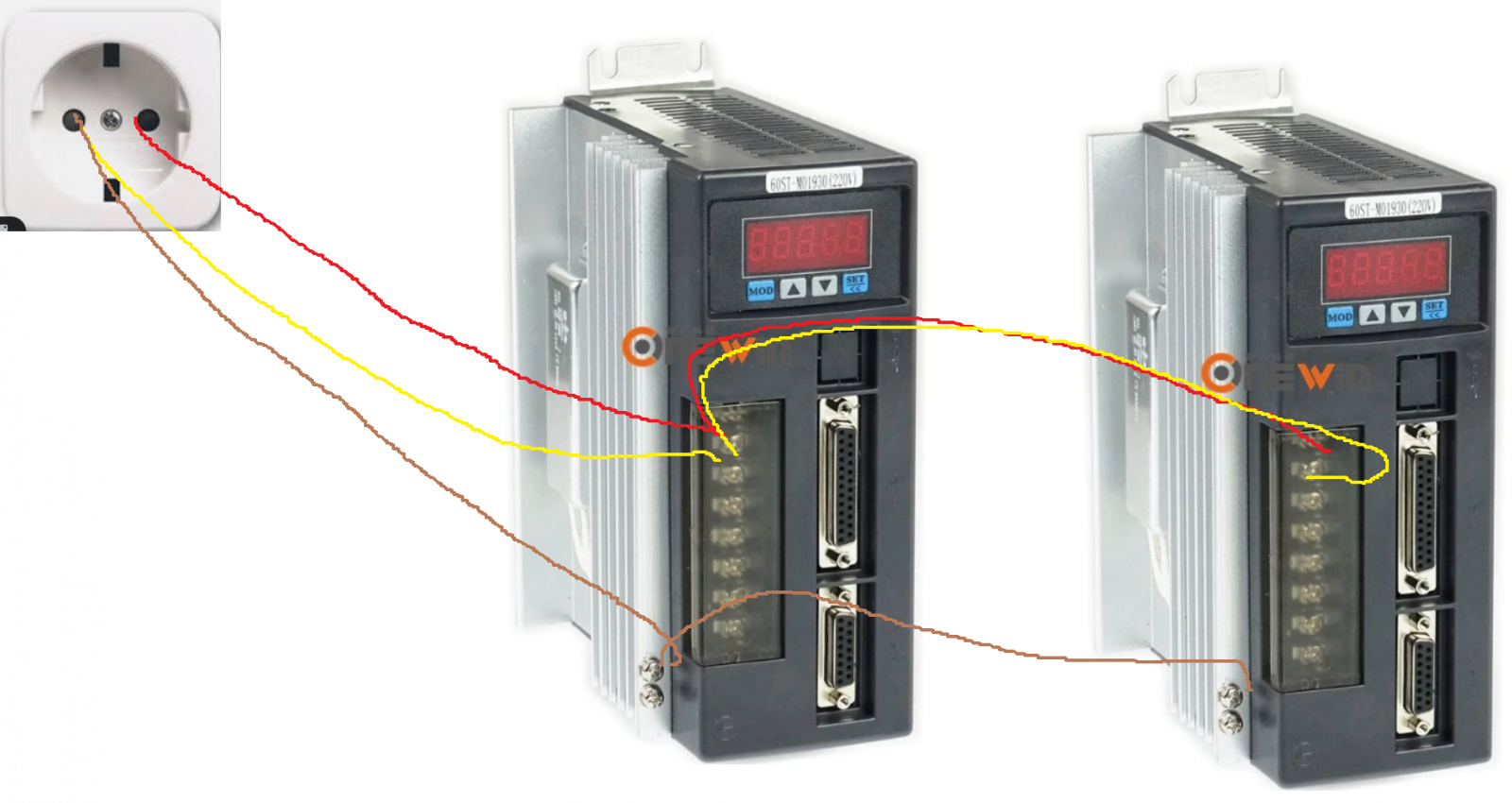

    Is it possible to power multiple Servo drivers from one power socket? For example bridging two drivers?
    Or is one powersocket + EMI filter required for each of the servo drivers?
    Greetings

    One plug and filter for all drivers is the way to go.

    In my case (6x1000W) it was theoretically possible for the six motors together to trip the 3800W breaker, but since they will normally never draw the max current all at the same time in reality it was OK to supply them all from a single line (240V, 16A).
    There is however a reason to at least allow for them to be switched individually: When I switched all six controllers simultaneously over a single switch, there was a short initial draw of current that tripped the breaker every time. Switching them on one-by-one, even within just 2 seconds worked fine.
    So, in my experience I'd say you can supply all six from a single line, but you should still be able to switch them individually.
    Cheers,... :)

    This is an interesting observation. In my experience I have 14 servos on one 10a breaker and it only occasionally trips the breaker when I switch them all on at once (via a contactor) and never in use. Most of the drives are AASD15A but 4 of them are AASD20A. I wonder what the big difference is between our setups.

    So if i would wire the power like this it would be fine? Obviously this is w/o the line filter and actuators connected.

    I assume there are capacitors that are being charged when you switch on the drives. I am using 6 AASD20A. Maybe these have different capacitors...

    If you look in the manual and the general consensus it would be wise to put a breaker in between the drives and the plug. But yes what you drew will work.
    If you're worried about what size breaker just put a 10a on there. I had a 15a on mine and was curious if I put a ten on instead, if it would trip. As a mentioned above, it only trips when first turned on, and only sometimes.

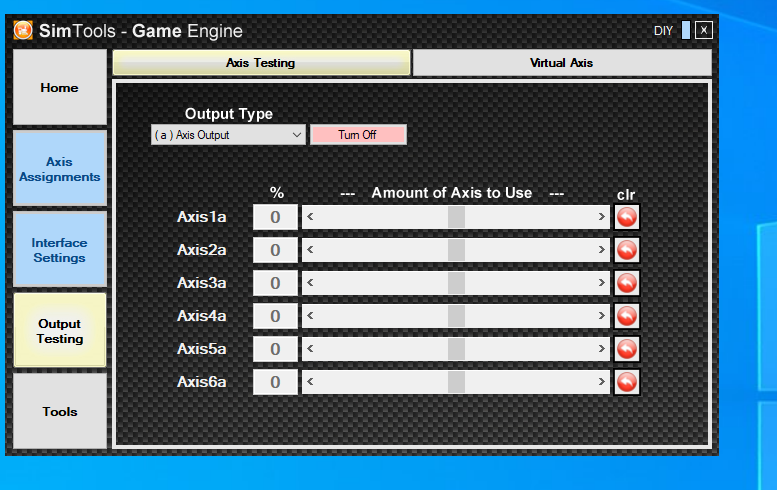

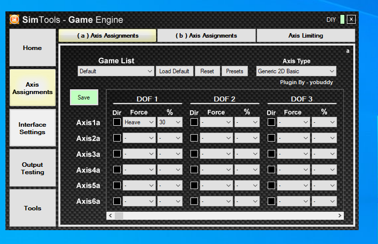

    Hi, I just finished my first actuator and had issue in Output Testing in SimTools. Actuator is not responding when I moved the slider. Here's some pictures attached and sorry I'm new to this and just building my actuators.
    Anyone can help me much appreciated. Thanks

    Hi, did you see the instructions in the manual? It could be the language system locale issue. Or missing FTDI drivers..
    https://github.com/tronicgr/AMC-AAS...5A_4DOF+TL+Surge-SRS-Simtools_manual_v2_6.pdf

    Hi thanks for your reply, I found out that my servo motor still in jog mode, after changing this every things works fine.

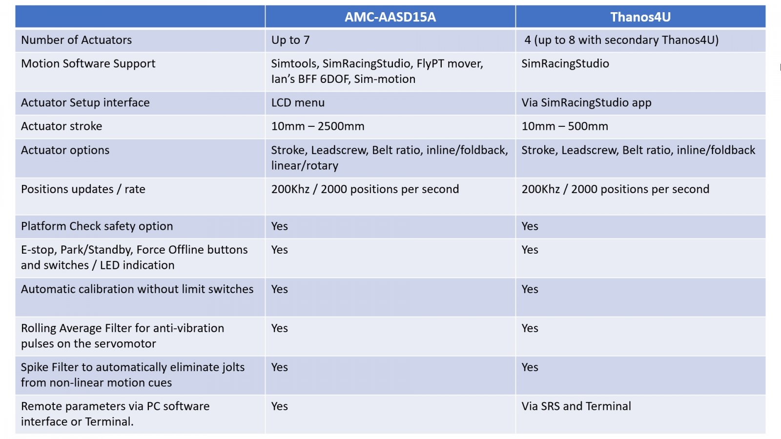

    Hey guys! The new Thanos4U servo controller is here:
