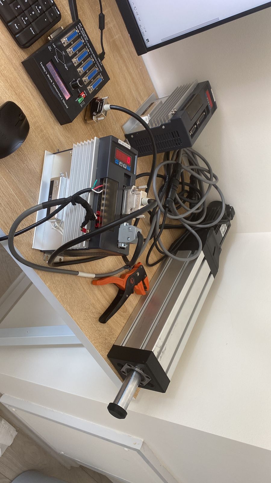

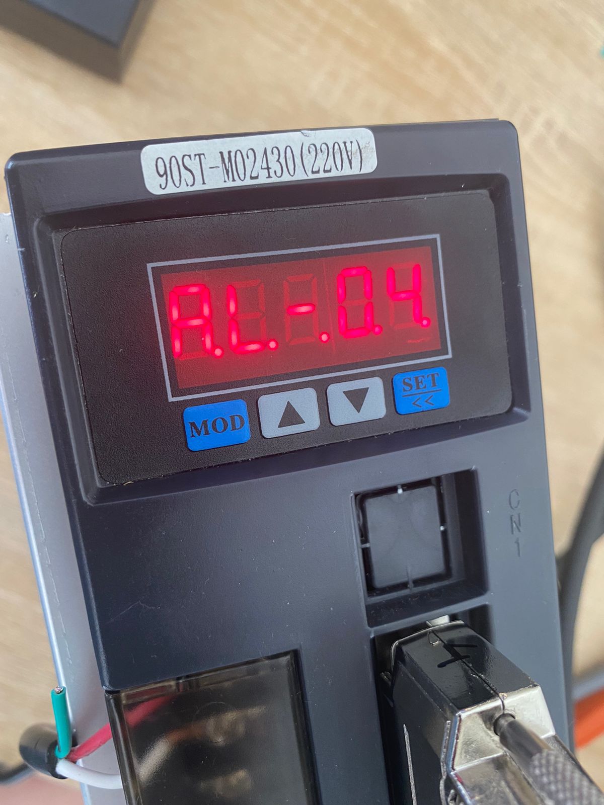

    Hello Thanos, first of all thanks for your great contribution to simracing.
    I needed to bother you with a query;

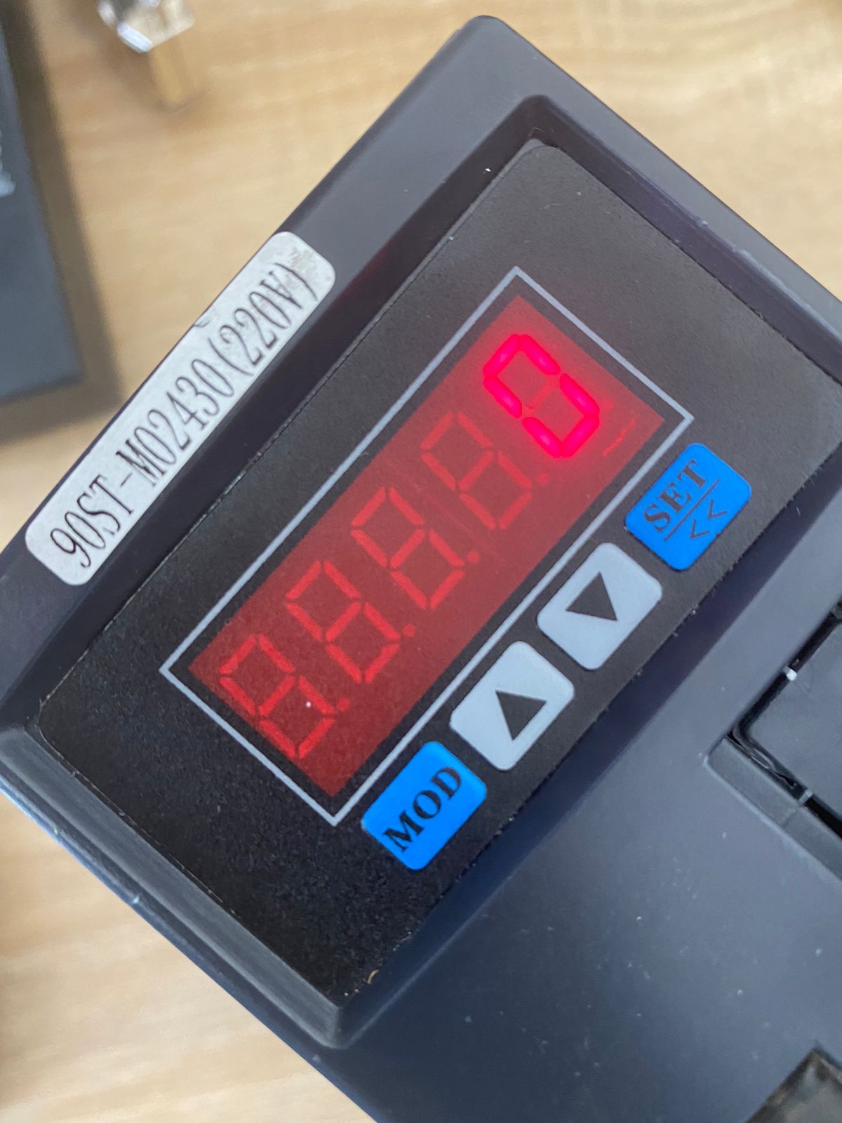

    A few days ago I resumed the progress with my simulator, in my case a 4dof type SFX-100. I had it working for a while without any problem, due to specific issues I had to move house and disassemble the entire simulator. These days when it comes to reconnecting everything I found the unpleasant surprise that the actuator driver n°1 presents the error code AL-04 when turning everything on. If the driver is only turned on without connecting it to the AMC-AASD, the driver shows zero on its screen, the error appears when it is connected precisely to the AMC board. I tried this with two diferent computers. As extra information I can tell you that the driver did not crash, it was not exposed to moisture or anything strange, the other 3 drivers and actuators work perfectly. I leave you some images below. I would be very grateful if you could help me to know if it has been corrected or if the driver cannot be used directly. Also all the parameters (Pn) are ok.
    Thank you again for all your great help. Greetings.
    1° Connected to AMC-AASD Error AL-04 with 5 points. a958d481-c269-46a8-8aad-597106fd623a.jpg
    2. No connection between driver and AMC-AASD 44221121-2bdd-4335-9b21-f891c3b4ffef.jpg

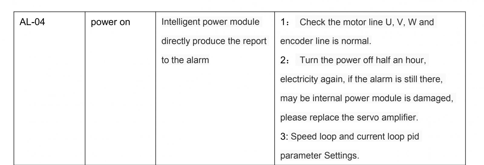

    You said "reconnecting everything" ..
    Perhaps you wired wrong order the power motor cable U, V, W , or a connection is loose. The reason the alarm comes when you attach the AMC-AASD15A, is because the AMC-AASD15A activates the motor power to calibrate...
    You can verify the issue by trying to manually JOG the servo (Fn002 JOG Trial operation -
    Use the Up and Down arrows to spin the motor)

    Thanks for your answer Thanos, I am completely sure that everything is connected well, in fact if I try another driver everything works perfectly. I try to do the test (Fn002 JOG Trial operation -
    Use the Up and Down arrows to spin the motor) but immediately the alarm code AL-04 appears :(

    Ok. Since even JOG fails on that servo drive, it could be a wrong setting somewhere.
    Try to Factory reset the AASD-15A parameters
    Select Fn004
    No need to enter a value. Just press/hold the Set button and it displays Pni n then press/hold Set again.. displays go... done... Remove power and plug back in..
    Then enter the suggested parameters from the AMC manual.
