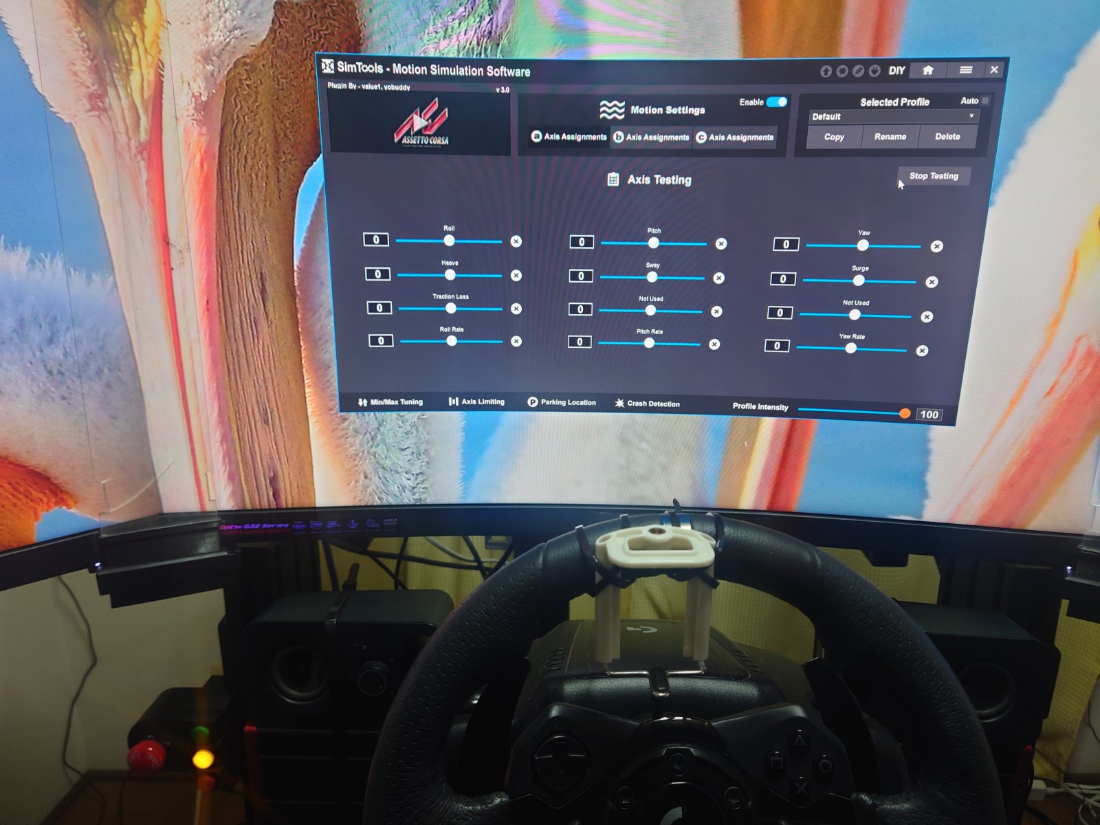

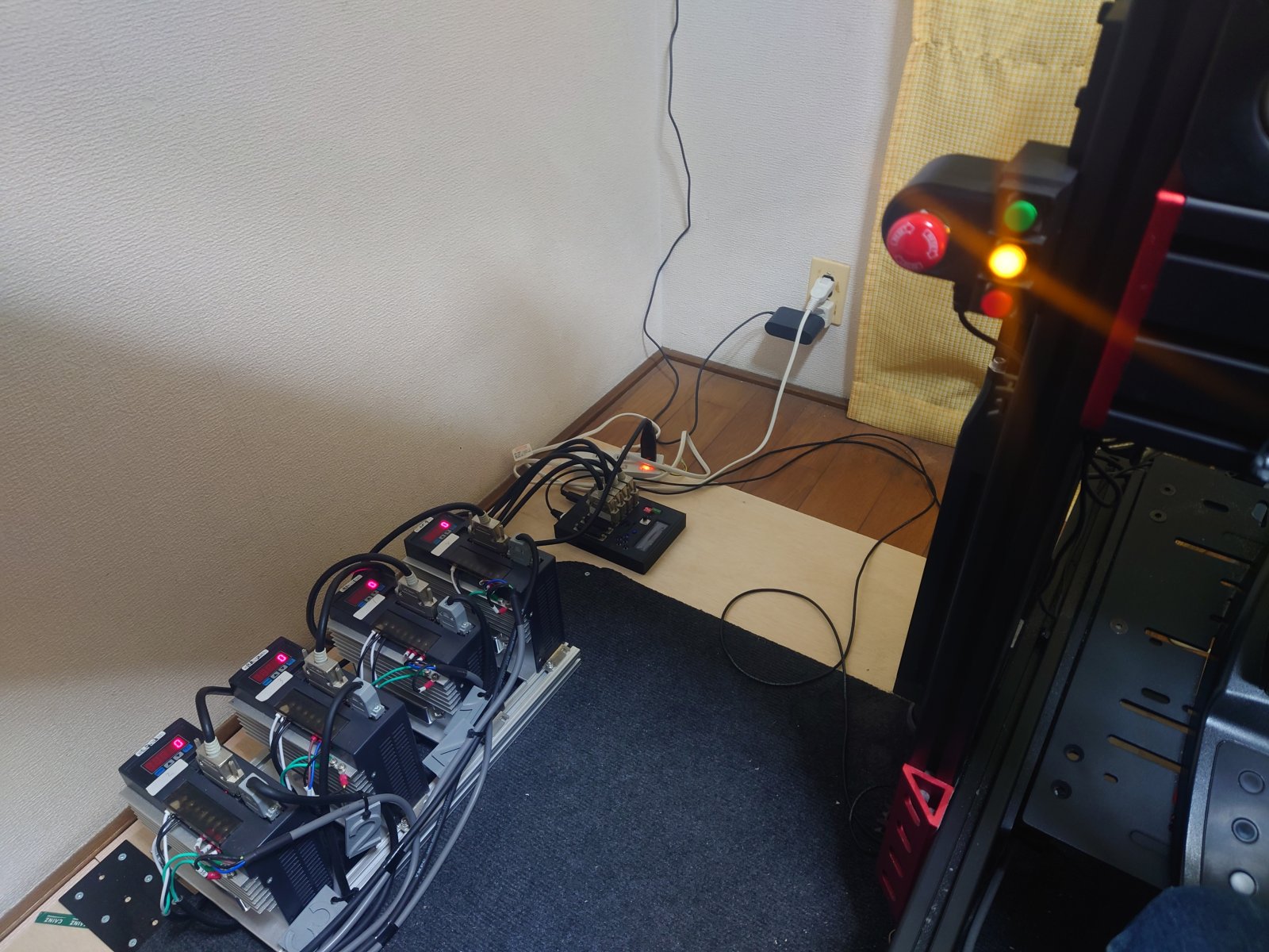

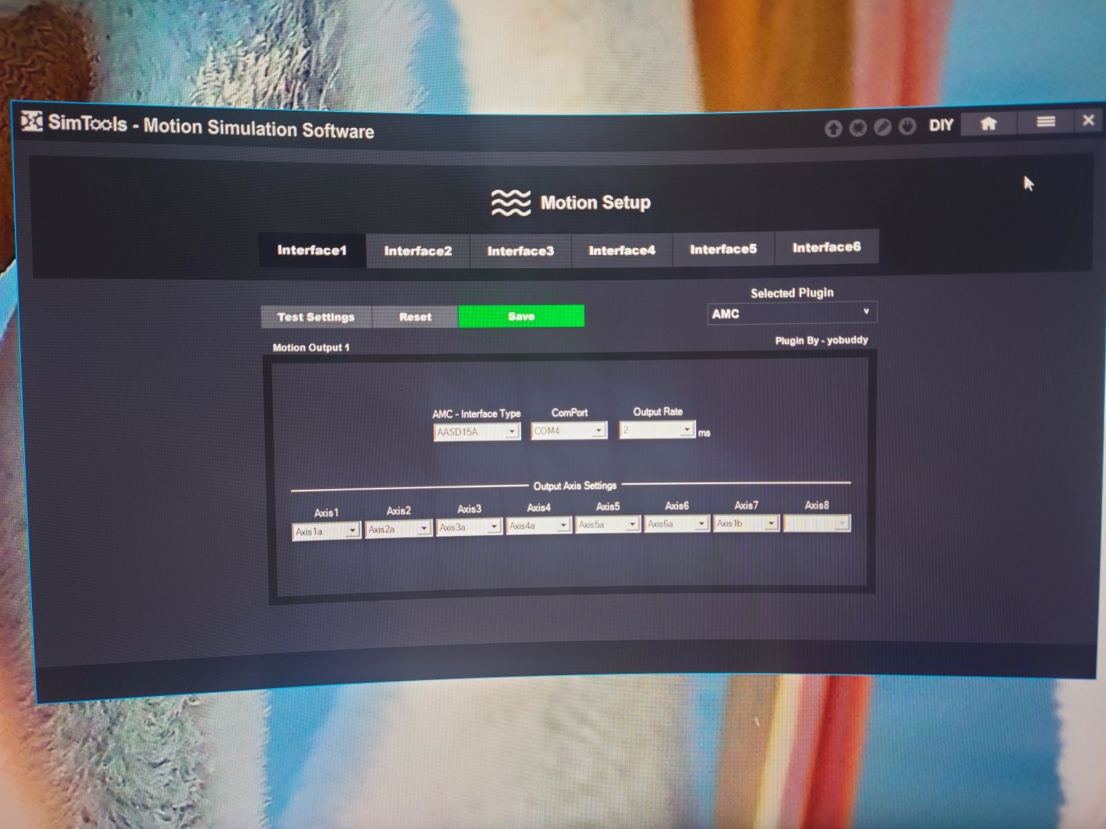

    Hello. I was enjoying the simulator with simtools3 and Thanos. I changed my computer and now the simulator doesn't work with simtools. The simulator works with simhub. I have uninstalled SIMtools3 several times but it still didn't work.I have uninstalled SIMtools3 several times but it still didn't work.The OS is Windows 11 24h2, the CPU is u7 265k and the motherboard is Intel Z 890.

  17. Thanos
    Jul 6, 2017
    1,379
    Electronics Engineer
    United States
    2,917Coins
    +1,079 / 10 / -0
    Probably missing FTDI driver?
    Does it move using the manual motion test tool?

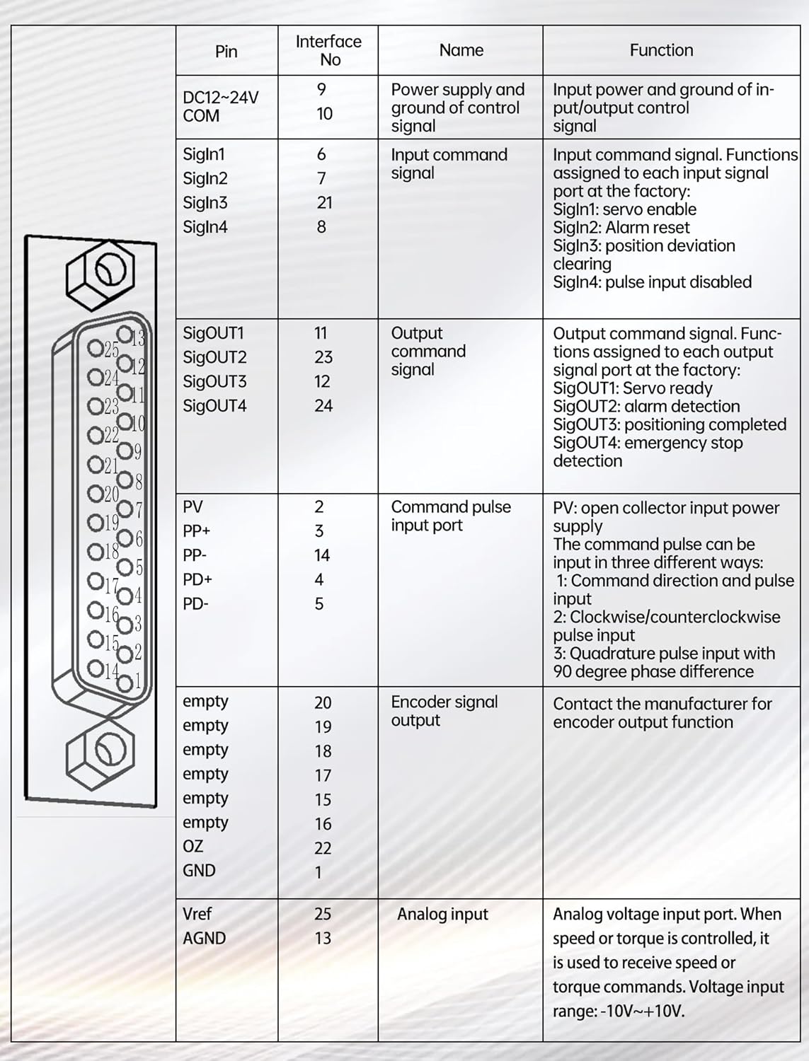

    Hi Thanos,
    I was looking through this thread and you mentioned the AMC controller works on some other servo drives. Unfortunately with the tariff stuff going on the AASD15a ones are pretty expensive right now. I did find a motor with a similar spec to the 80ST-M02430's, but the driver is a S2-SVD15A.
    It looks like the pins match up with the diagrams you have for the other drives compatibility. It also has similar functions. Is the compatibility between drivers pretty straight forward and just setting the correct parameters on the drives, or would i be going down a rough road? The difference from my estimating on shipping/tariffs is ~$1200. I was able to get the manual and pinout for the S2-SVD15a if you're curious.
    I did have another question about the diagrams on github showing compatibility between other drives. You have pin9 showing DC5V. The AASD15a manual has it listed as DC12-24V, same as this S2-SVD15A. Is it supposed to be DC5V or does it not matter?
