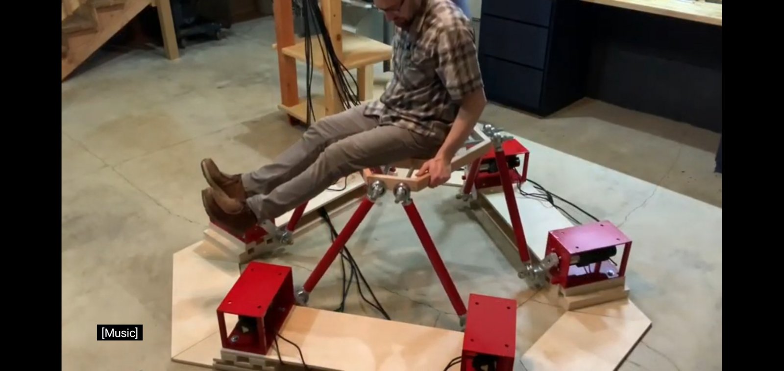

    Here is a most complete video explaining all the parts of the huge 737 6DOF platform that Mike from New Mexico is building. Plus some bonus demonstration taxing and takeoff.
    Thanos
  8. Thanos
    Jul 6, 2017
    1,380
    Electronics Engineer
    United States
    2,925Coins
    +1,080 / 10 / -0
    Part two of Mike's 737 6DOF, demonstrating a few things that got cut from the first part:

    Mike really needs to use a coord. Channel.
    Normally at least 15% pitch is needed while there is a 0,25G thrust applied.
    As the ressources are not big, he can use maybe 10deg. At least something...
