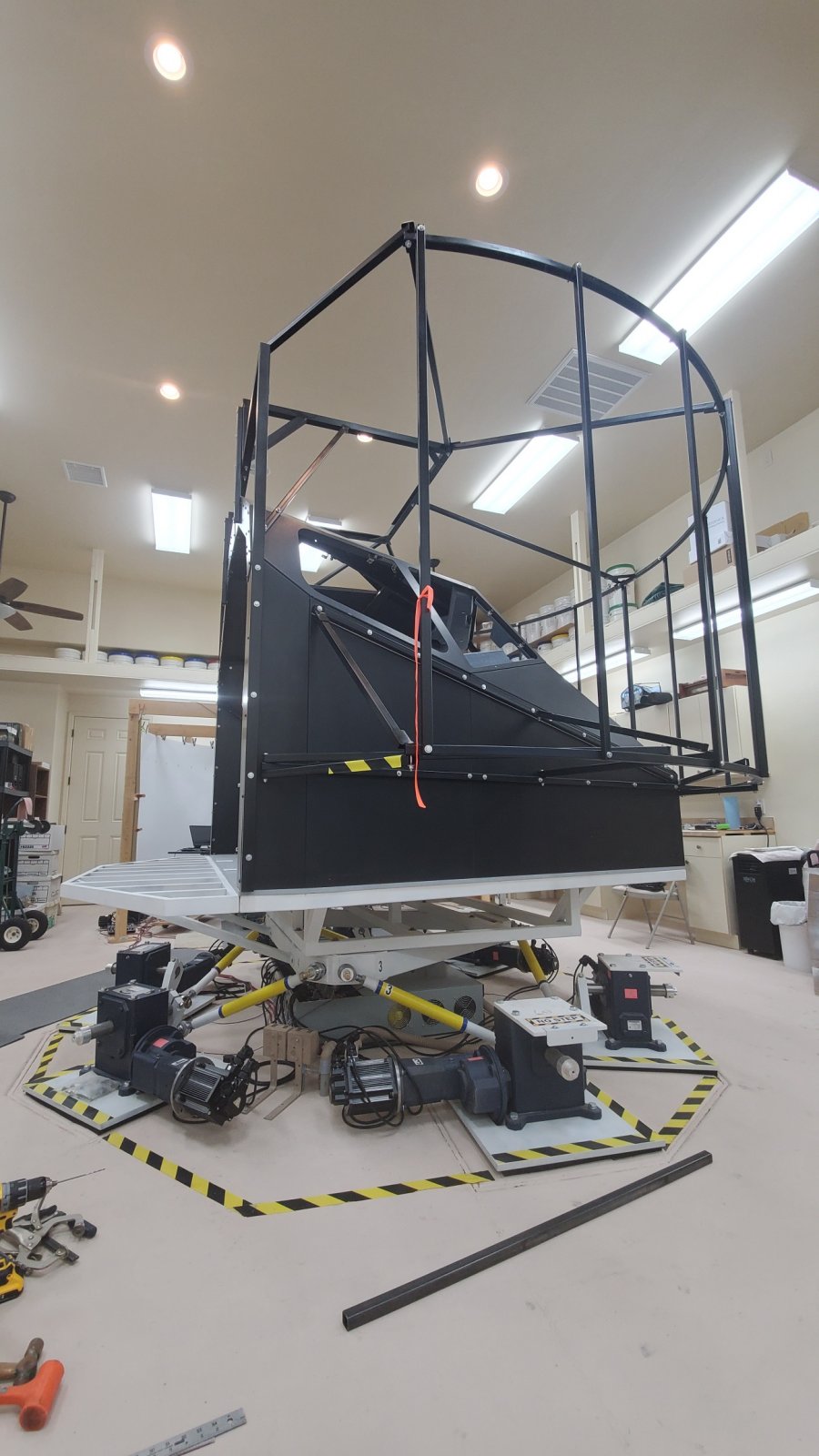

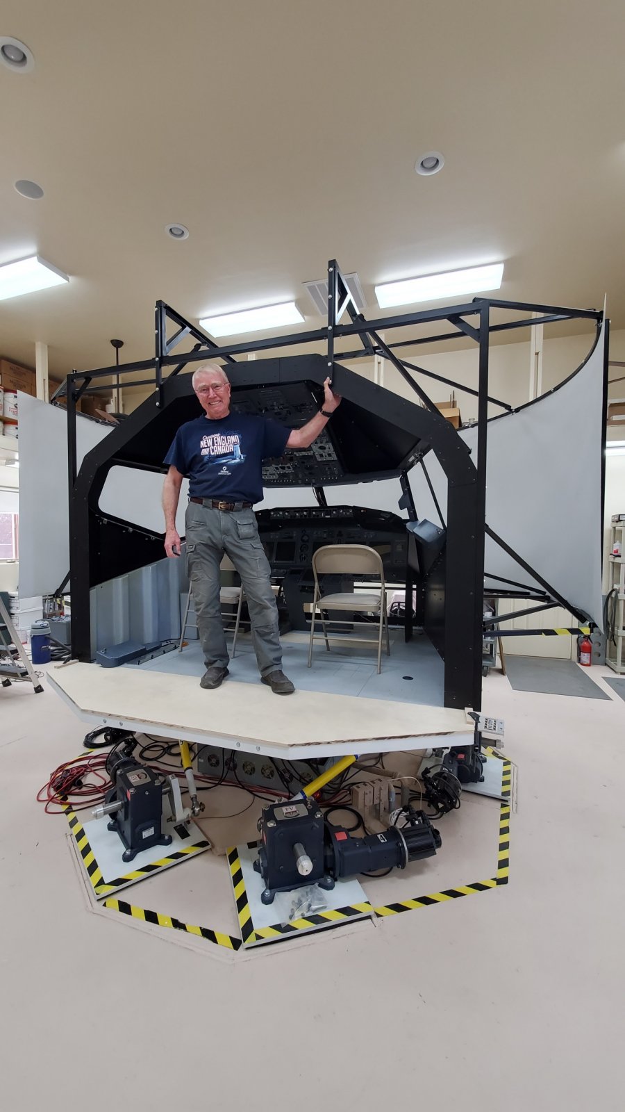

    Realistic Level D cockpit, requires realistic, almost 270 degrees peripheral screens. The frame is ready for mounting...

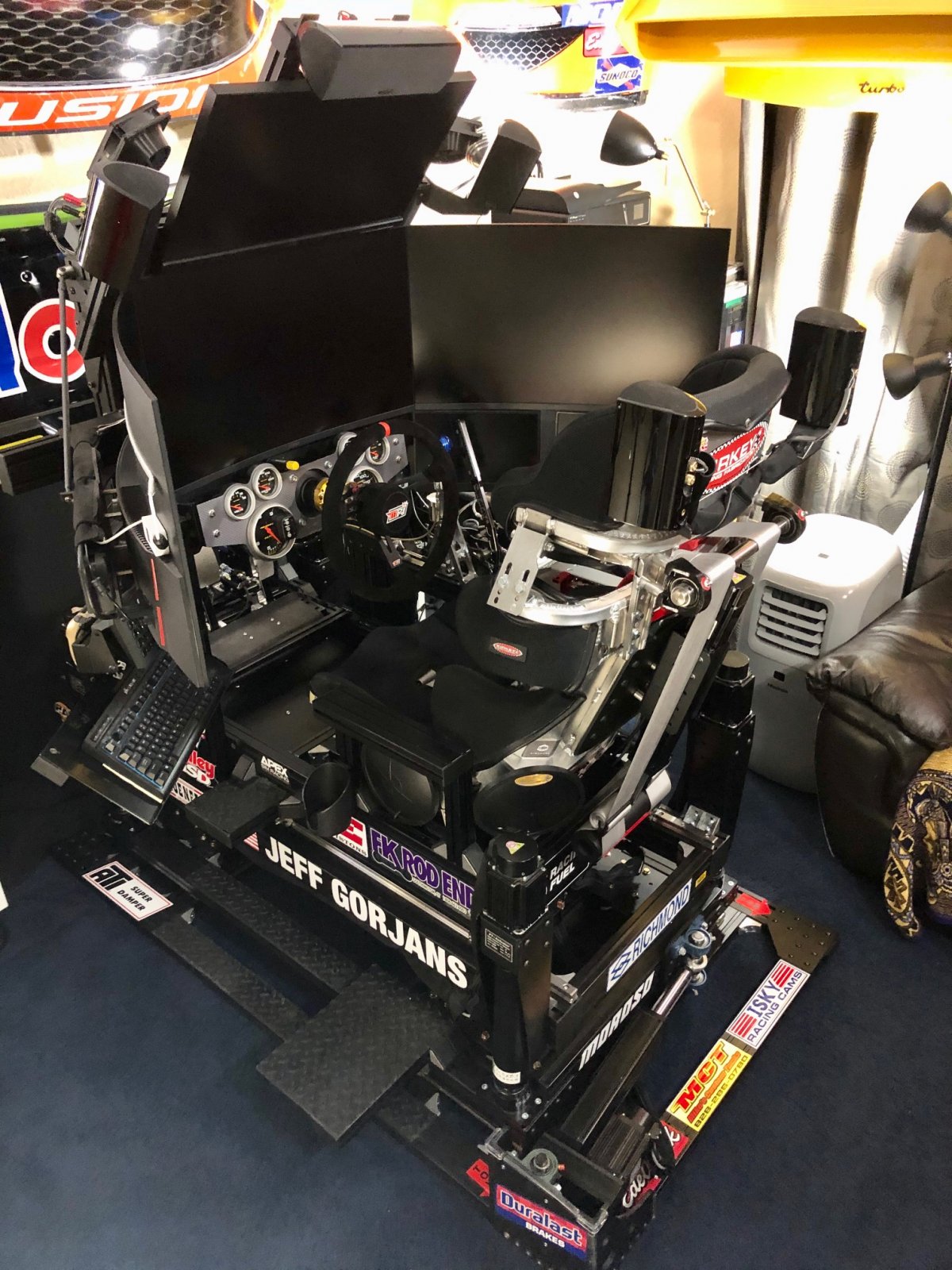

    Mike's 6DOF platform with AASD-15A servomotors is almost complete, screen is mounted and calibrated and cockpit instruments are installed in the nose section... All this while in self-isolation. Stay safe from the Coronavirus!!!

    Thank you Jeff! Amazing setup and presentation video!

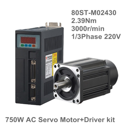

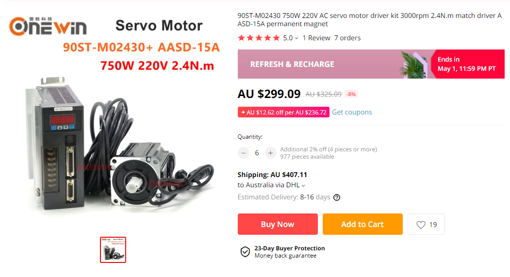

    Hi @Thanos
    Im in the market now for 80ST-M02430
    Ive noticed the adverts are showing 2 versions of the drivers.
    Is there something different about these that makes one better than the other?

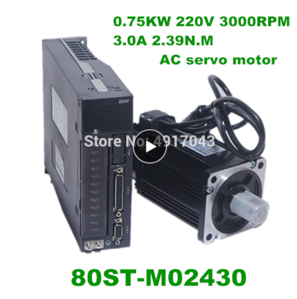

    Trouble is that seller is +33% more cost.
    I appreciate that a recommended seller by you has value but Im willing to take a chance on another seller to save 33%
    Do you think the this one would be viable?
    https://www.aliexpress.com/item/4000793515498.html?spm=a2g0o.cart.0.0.46b13c00wmbniv&mp=1
    edit-
    I noticed that one driver has modbus support and the cheaper one does not.
    Do we need modbus support for your controller?

    You want the drive on top. Its an aasd15a.
    The one on the bottom is a different drive. It would probably work too but you run the risk its not plug and play. The pinouts for these drives change from brand to brand.
    We only have that crappy low resolution image to go by so there is indeed a risk. You could tell the vendor that you need the drive to say aasd15a on it or ask for a close up photo of the label. Dont expect much help from the cheapest deal on the net.
    No need for modbus support. Thanos uses step and dir, among other things.

    I see now looking at them more closely that we want the ones with the heatsink on the side.
    edit-
    Both sellers are representing that they are AASDA-15A and I noticed other sellers also doing the same with both images.
    It looks like there are 2 varieties of AASDA-15A but it makes sense the ones with heatsink on the side are the better pick.
