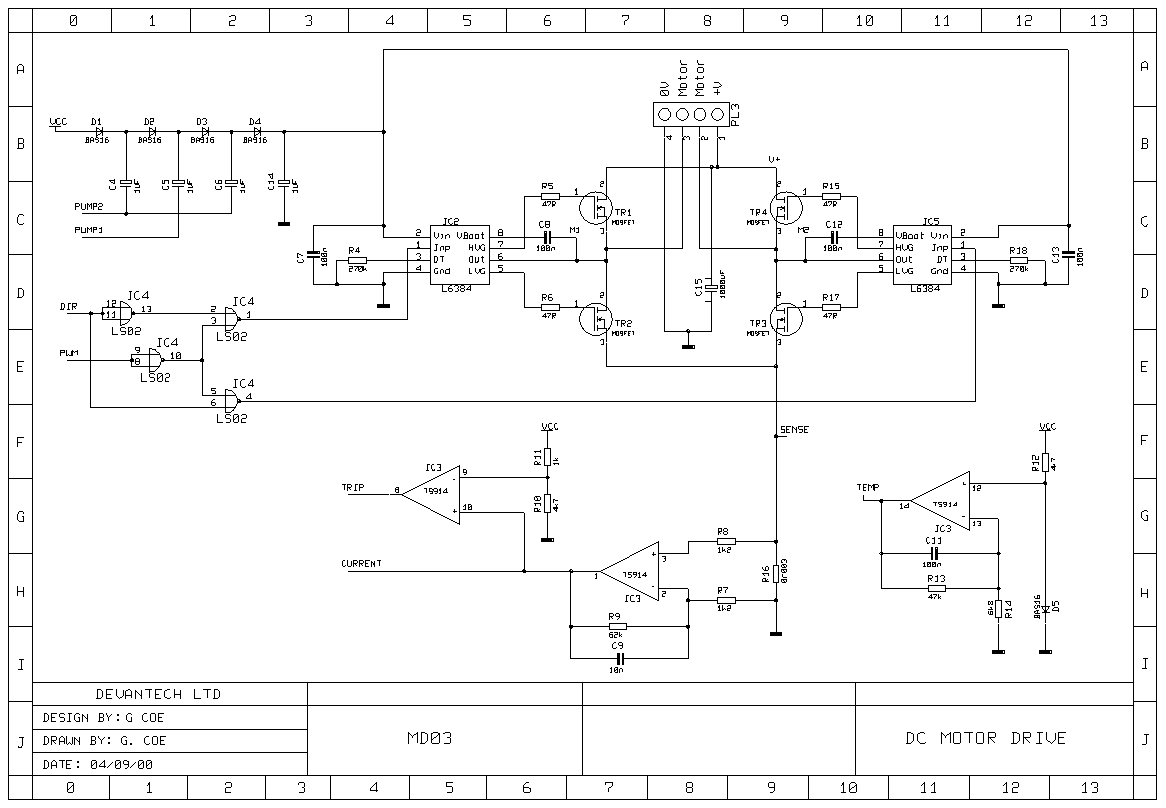

    Re: My AMC Compatible H-Bridge is blocked!!
    I have build the AMC Compatible H-Bridge, but there is a problem : the output OF IR2110 remain hight in any case for both h-bridge and I don't understand why ? when I move the bar of xsim the inputs of IR2110 change state but the output remain high !!!
    can someone tellme something about this?
    regards Tetesim

    You have to explain your problem better. Draw on the schematic or specify what outputs you are talking about, how you have things connected, etc.

    I can send you my pcb, but i must discover how send a file in your forum!!
    Perhaps you be successful to find the error! I must understand if There is an error in pcb project or there is a component wong or short circuit or something else!
    I have tried to power the logic of IR2110 pin Vdd (pin 9) with 12V of AVR controller and take 5v from the 7805 on the h-bridge
    I have tried the logic of IR2110 pin Vdd (pin 9) with 5 V of AVR controller and I have removed the 7805 on the h-bridge, but nothing to do!
    i have tried to power the the 74HC08 with 5 V of h-bridge and I have tried to power the 74HC08 with 5 v of avr controller, but the result is the same ; the pin 1 and 7 of All 4 IR2110 ramain fixed a voltage value!!!
    regards tetesim!

    And what is that fixed voltage?
    You can attach images to your posts under the Attachments tab under the text box.
    Post how you connect it to the AMC, where you take power from, everything that you can.
