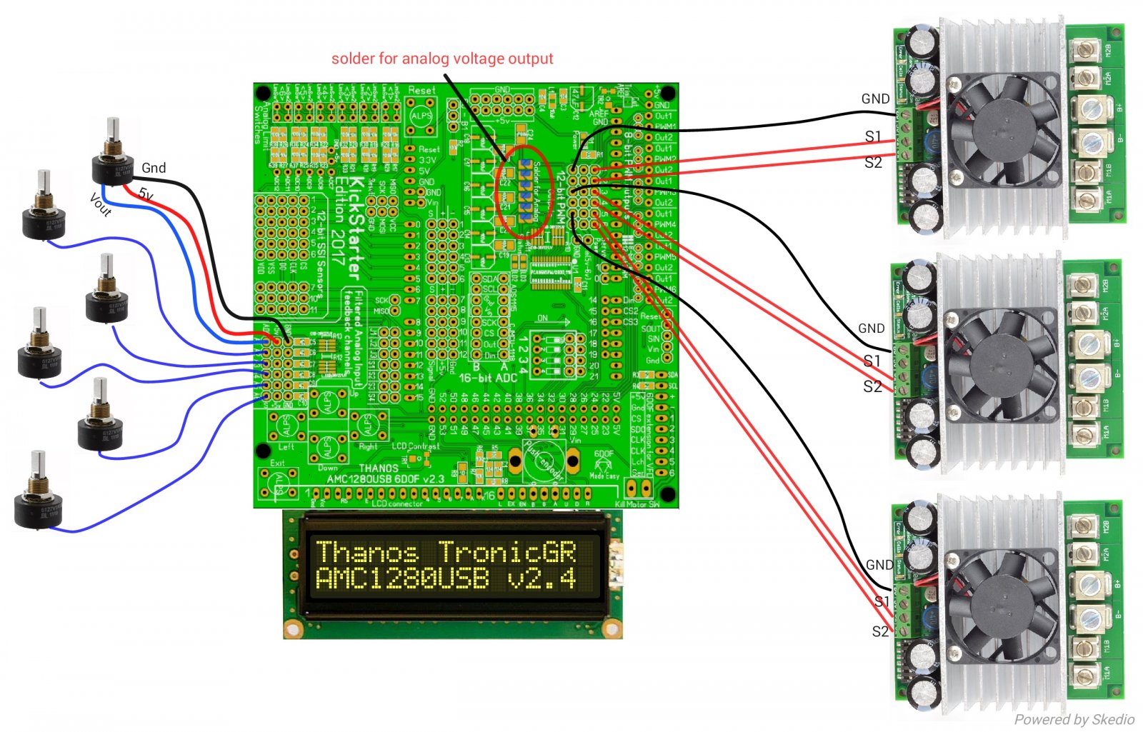

    Here is another connection diagram showing the important connections for use with sabertooth 2x60 drives:
    Each sabertooth should have its own ground wire to the amc1280usb, to avoid creating ground loops.

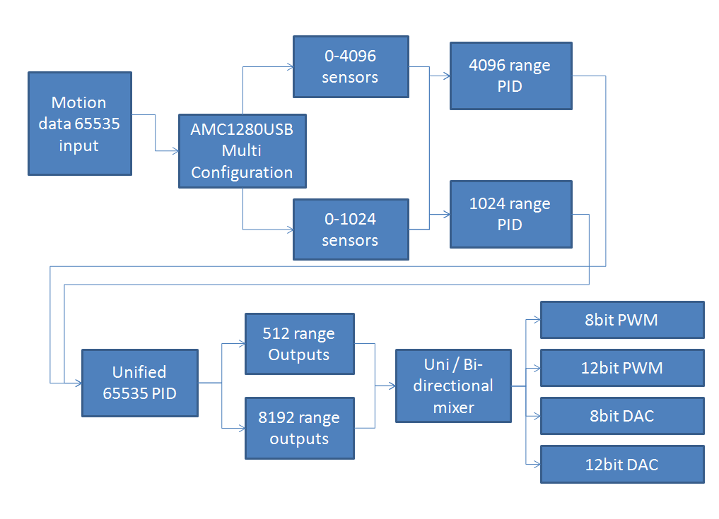

    Hi @Thanos , I cannot seem to get the PID to work like it should :(. I can wind the Proportional all the way up to 95 and while tracking improves 'slightly' it never starts to overshot like it should. If I add any Integral at all, even just 1, it starts to oscillate :think. Any ideas?
  4. SeatTime
    2,572
    As I was trying to find out if it was a problem with the Sabertooths, decided to spend the morning rewiring in my old 1280, which I know work well with my old MM drivers.
    So it works perfectly :rolleyes:, with PID values and response that makes sense and now all my detail is back with rumble on the ripple strips which I just could not get on the new 1280 without turning everything up were it was just picking up allot of unwanted noise as well. I'm happy that I now have a working sim, but I'm quite certain that you have a problem with the PID setup in this new 1280.
  5. Thanos

    +1,079 / 10 / -0
    I'll check it tomorrow in a small fast linear actuator I have. I know I didn't quantize the PID calculations for 12 bit resolution, so I assume it's 4 times less than it should. I'll test it and make the PID calculations dynamic for each resolution.
    Maybe it's also time to upgrade the resolution of PID to more than 255 values...

    +1,079 / 10 / -0
    Because the 12bit resolution still has 8bit pid quantization... if you increase the Integral term it will kick the motor disproportionately as of the wrong quantity of set of values for normalization. As i said ill be adding a dynamic set patch to it.

    I found the issue, as I thought it's the different size output which is much bigger for the 12bit. I increased the PID levels 4 times and seems to respond better now. Tomorrow morning I'll apply the fix in all six PID subroutines and post the new revision for you to try.

    I don't need to repeat, but like most of the values you set on the LCD menu, PID settings are percentages as well not absolute 255 values. They are adjusted internally for the the range and the resolution of each input/output setting. When I say to increase the value is to increase the entry points for the LCD menu for more fine approximation values. But then you will have to turn the encoder knob lots of times to set the the value you want (12 pulse / rev encoder).
    Here is an OVER-SIMPLIFIED diagram that shows some of the conversions and crossover calculations happening inside the PID code alone.
    SMC3 is great for the few types of motor/ sensors it supports. Not much work is needed to test it and verify it. The AMC1820USB needs more verification every time a code change occurs in the PID code. I'm sorry, that is true.
