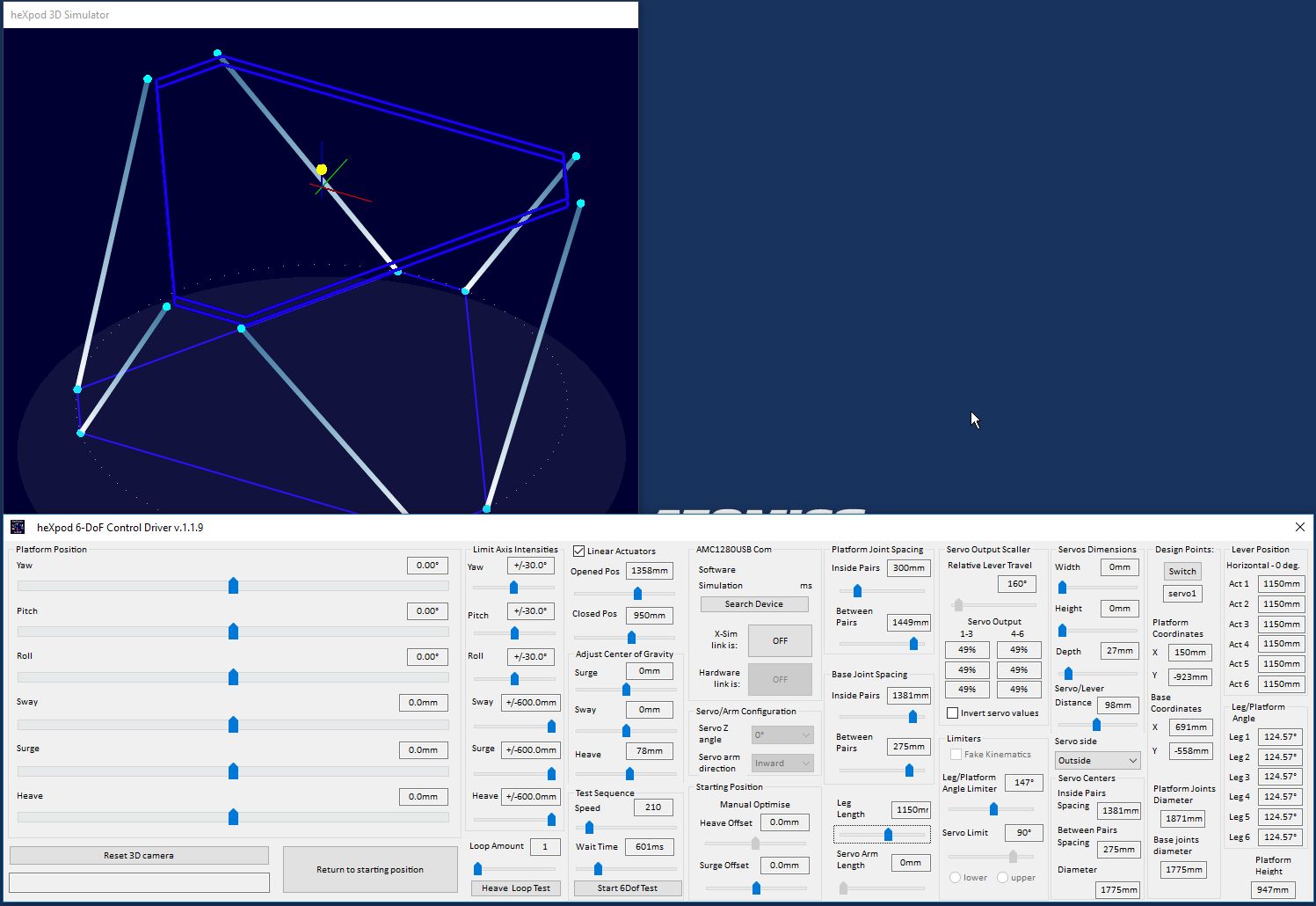

    I have some good news as well. I'm working with @yobuddy to integrate the 6DOF plugin driver for the Amc1280usb into simtools. I already got link and some data transferred, just need some adjustment on the data format in the simtools interface part to have soon a real inverse kinematics math solution for 6DOF platforms available in simtools as well.
    See more info on the 6dof plugin driver here:
    Http://hexpod.xyz

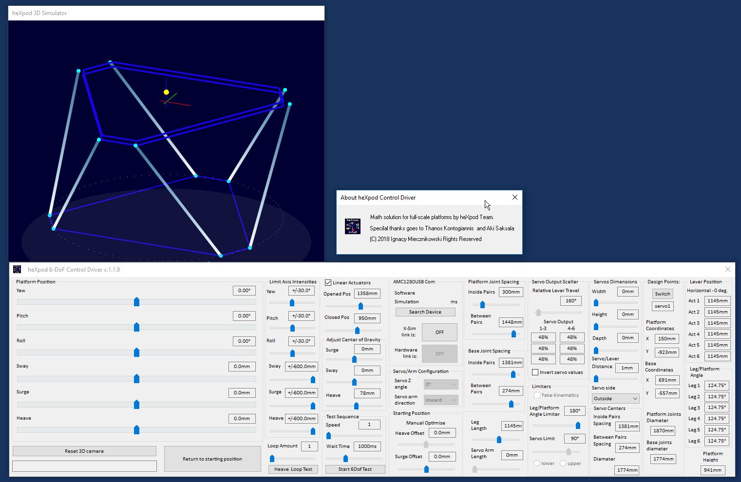

    Thank you. This new 6DOF plugin driver is not my development. Its totally revamped over the years and its more accurate than before. I just offered to link those two (simtools and 6dof plugin) as currently works only with x-sim. The problem is that simtools is programmed in VB .NET, while the plugin is pure C++. I work on the custom C++ Mapped Memory File wrapper to do the connection.
    About having the plugin support multiple interfaces or other controller, its not as easy as you may think. The code is optimized for fast link with the AMC1280USB using pure binary transfer mode with 250000bps speed and a single interface output. As far as I know, most arduino interfaces are transferring either simple characters or HEX Let alone other interfaces apart arduino are even more arbitrary. I don't see why the 6DOF plugin has to have to deal with that. Simtools have better output support for these other interfaces.

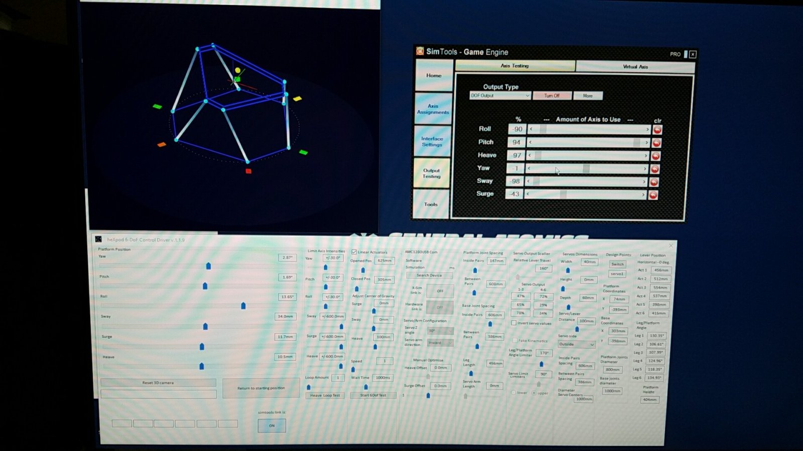

    The Simtools now has decent 6DOF math support thanks to Hexpod team. The new Hexpod driver v1.2.6 is very stable and works wonders on testing I did on LFS:
    Hopefully, will have some footage soon on using it a large scale 6DOF platform with Servomotors.
    The Hexpod driver will be available from http://Hexpod.xyz
    To clarify, its not my development, I just helped interface it to Simtools (custom memory mapped wrapper between the two).
