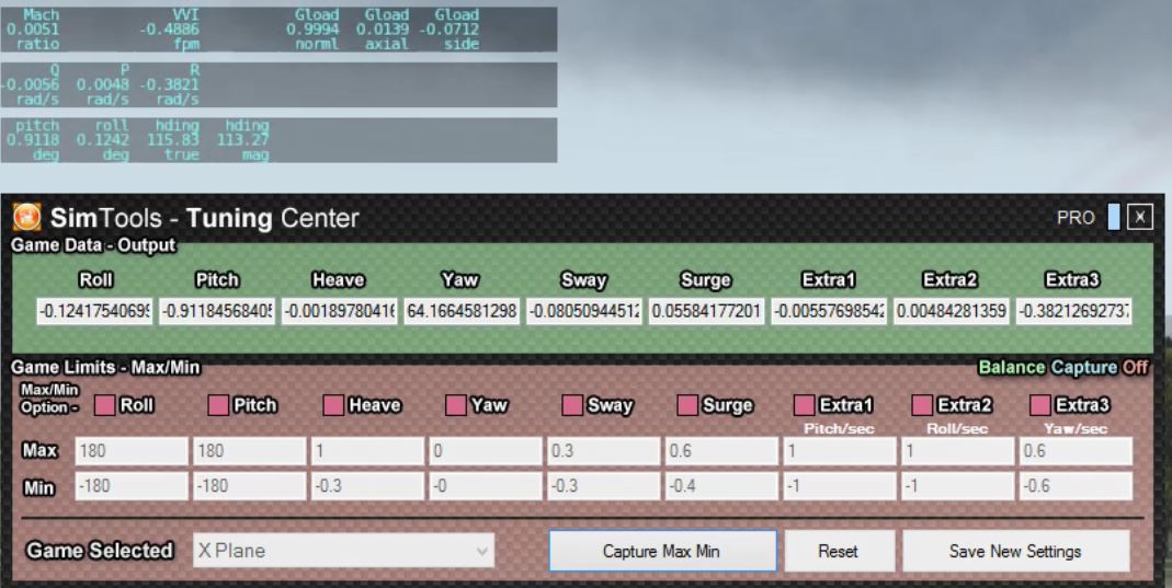

    For our platforms, the raw value does not provide good results. It obviously needs some conversion.
    "Gload norml" is the g-load across the aircraft, relative to the aircraft body-axis.
    As you noticed, the issue is that without any motion we get a value +1, while all other linear and rotational accelerations starts at 0. It is shifting the whole axis to operate almost at the clipping limit of our heave dof.
    Desperately I tried to set it -1 / +2 but it's not a solution.
    I would need assistance. Please PM me if you have any ideas.

    Hi hexpod
    The +1g is always effective in the direction of the earth center, i.e. when you fly vertically up, there is an additional +1g pulling on the surge acceleration and heave is 0.
    The only feasible way for the elimination of this +1g that I can see: Convert the local accelerations to world accelerations, deduct -1 from world heave and convert the world accelerations back to local accelerations.
    As this involves the Euler vectors, I'm concerned about the gimbal lock needing special attention.
    I've successfully applied this method to the iRacing plugin – however iRacing cars tend not to do loopings and that kind.

    Try this plugin version. Earth gravity is deducted from the acceleration vector.
    PS: I'm still a terrible pilot… You aviators need to put the plugin to the acid test!
    PPS: Funny enough, x-plane provides "
    motion platform stats" but still includes earth gravity. Maybe someone needs to tell them…

    Well man, I am impressed. you go fast.
    The axis is properly centered now. From what I can see in my quick test, It the behaviour seems fine.
    You made my day, Thank you very much!

    Hi @value1
    There is still something strange with the values in the plugin.
    I think the axial Gload and the side Gload should be mapped on our surge and sway.
    What I see is that x-plane values does not match with those in the plugin.
    Please take a look on the Screenshot.

    Not quite sure what you mean.
    It is clear, that the x-plane values do not match with those in the plugin, because the plugin deducts the earth gravity (1g) from the acceleration vector. Therefore the values are slightly different when ± horizontal and even more, when the plane is tilted.
    Surge corresponds to axial Gload and sway corresponds to side Gload (I believe from what I see on my screen/Tuning Center upload_2018-8-10_18-6-42.png ).

    Thank you for yor reply.
    I thought the last update was related to the vertical Gload only.
    Let me perform some tests with the old version to get what's wrong in the new one

    Hi @value1,
    Please watch on the clip what happens with the side and axial accel.
    I do a simple turn with the cessna and instead of having the side and axial accel more or less steady like in the old plugin, they are oscillating depending on the plane vertical orientation. It's not realistic at all.
    Maybe there is a way to correct the heave accel without touching the side and axial one….
