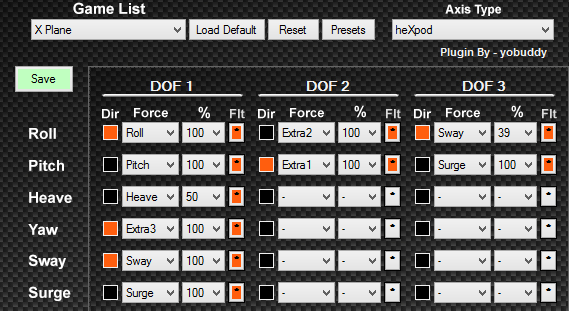

  20. hexpod
    hexpod http://heXpod.xyz
    Apr 18, 2016
    1,227
    berlin
    7,894Coins
    +380 / 5 / -0
    DC motor, 6DOF
    Value1,
    Thank you for your efforts with the third version of the plugin.
    Here is the result:
    For testing, I would recommend to use manual values in the "tunung center" as the new "roll over" feature can work only when 180 value is set for pitch and roll positions.
    This is the simtools matrix where I am mapping the forces for the heXpod Add-On:
    As you can see, I am mapping all 3 rotational and 3 translational accelerations and only 2 positions.
    I am skipping the use of yaw position (magnetic orientation of the aircraft) as the yaw acceleration which retuns to the center seems to be enough for a good realism.
    In the DOF2 column I am mixing the pitch and roll positions with pitch and roll accelerations and in the DOF3 column I am adding sway effect to roll axis and surge effect to pitch axis in order to simulate a sustained acceleration feeling. - pretty simple.
    In the video example, the aircraft is making a slow 360 turn at a constant speed which means we should have a constant value for surge acceleration and also a constant value for sway acceleration (centrifuge force) as you can see them on the telemetry output.
    In this plugin version I see a strange relation between the sway and surge acceleration and the position of the aircraft. The runway is more or less oriented north/south and the plugin's values instead of being stable, strangely tilts the platform when the aircraft is facing east an west and retuns to 0 when the orientation is north/South.
    The ground behaviour of the aircraft (taking off, landing, taxiing) is a crucial part of flight simulation. Only to say how important is to get it right. I hope my explanations will help you finding a correct way to output the x-plane telemetry.
    Best - heXpod
