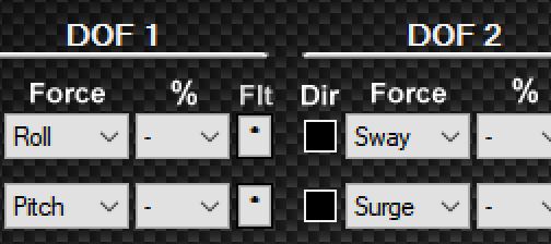

    You can try to keep your P relatively high and simply apply less smoothing filter on heave effect in comparison to all others.
    This way you should be able to choose the amount of road details you wish.

    Glad to see this compact and silent solution. The motion looks precise and very dynamic. I would definitely give a try applying some surge on pitch axis in order to simulate sustained accel/decel feeling.
    If you try it, apply a big smoothing filter on this effect. Of course you may want to do the same with roll and sway for centrifuge forces.

    Yes absolutelly agree, As I have never experienced this, it was my first thougt that something wasn't good enough with acceleration and decceleration. When I push the brake it comes a nice force to feel the brake, but it disappeares as fast as it comes. It caused me a bit of sickness in my stomach. o_O
    You know I haven't done axis tuning, or any of tweaking yet. I also need more roll effect in curves to feel centripetal force.
    The next step I learn how to do that :thumbs

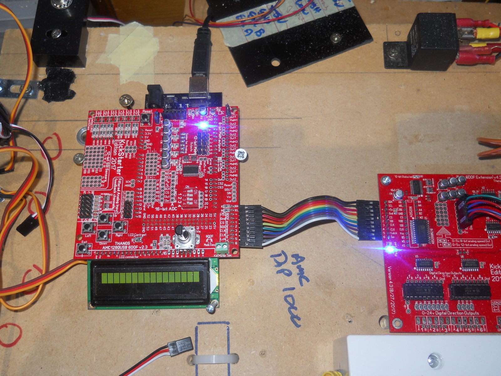

    Was making some decent progress with Firmware 2.4 & actuator testing ,so then thought now is the time to try 3.5 V 1b. well mr ham fisted may have bricked my AMC cos now the LCD screen just shows top row of Characters as fully lit Squares with no comms to PC and No text at any point on the screen , I came across a Video @Thanos Posted and it looks like Bootloader Corrupted .. see attached Photo ....
    Honest guys I have uploaded firmware several times now and had No issues but this time I think I accidently knocked the programming Jumper at the wrong point in the process or pressed a button out of sequence so im Buggered ..
    so once again im asking for advice as to how to get my Butt outta jail one more time ( For now that is )
    was trying to Connect to FlyPThexpod and realised I was using 2.4 Firmware so that's when the change / Mistake on my part occurred .
    Any help guys would really be appreciated . note if this Board survives my Attemps to kill it I mean set it up then take that as a good thing Cos im not doing it on purpose :)

    Hi Guys Problem sorted , @Thanos to the rescue , so just wanted to say Public thanks for putting up with my adventures. Firmware update now done , LCD back up and running , Full text on screen ,,,one piece of bacon saved .. :cheershug: might have been another cant see the wood for the trees moment But Happy to say I can continue to play
