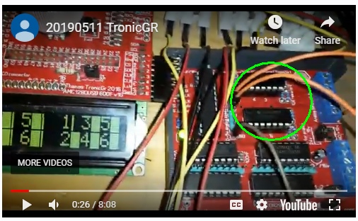

    For @Thanos,
    in contrast to your advice (upgrading to FW v3.5 rev 1b and your settings) the board is not working. The homing function of 2DOF is strange for me. Please see - - (the link is tested and working for me).
    The board is the red one from 2016 "Thanos TronicGR 2016 | AMC1280USB 6DOF v1G" with FW v3.5 rev1b".

    Ok, I see, the second potentiometer wiring is wrong. You need to swap the +5v and Gnd connections on it to make it measure the other direction as right now the motor runs away from the potentiometer instead of following its position.
    Try it and let me know.

    On the video, the yellow cable does not look like its secured well in the screw terminal...
    Also take a video of the LCD screen when you apply power to the motors. I want to see what is the reading of the potentiometers while the actuators are moving. If possible take a video that shows the parameters you have in the LCD menu please as well. I want to see the sensor direction.
    Did you check the potetiometer with a multimeter to see if the resistance is moving when you move manually the potentiometer rod? What is the resistance value between the +5v and Gnd wires (black and red) of the potentiometer?

    Ok based on the video, you need to set the Sensor direction to Neg 1-2-3-4-5-6
    Then, you might have to Swap the motor M1 and M2 connections from the sabertooth to your motors until the motors start to follow the linear potentiometers and stay in middle position.
    Right now I think the motor that moves all the way up has wrong direction because of the M1 and M2. But change the sensor direction first and then do one by one the motor connections until they move to center position correctly.
    Also make sure to remove these two LM324 chips from the 6DOF ext board!!!! They draw down the voltage of the signals you are using!!! I circled them in the next photo:

    I've done your recommondations, there is no improvement, see video:
    I think the best next step for me will be to send the board to you including a sabertooth 2x32 for the right setup by you.
