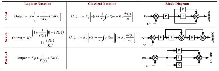

    Hello Joanne (Thanos), I Pre-order one of the AMC1280USB Deluxe and I just want to make sure that this unit is going to work with my setup I currently have 3 Pololu Jrk 12v12 USB Motor Controller with Feedback my motors will take 12Vdc or 24Vdc I have a potentiometer connected to the shaft of the motor.
    Been said that I have some questions on the MC1280USB
    1) The six outputs Will it control a bi-directional DC brush motor?
    2) If Yes What is Voltage operating supply range capabilities?
    3) And What is the Peak output current?
    4) Does it have feedback inputs and what kind?
    5) This is important to me, Will it have a Software to Setup and Calibrate and tune the PID?
    6) and last what will be the tuning PID algorithm? there is 3 Algorithm: Parallel, Series and Ideal, see screenshot for references.
    Please let me know

    Hi Milton,
    This is just the motion controller. It creates the appropriate signals to control the motor drivers. You will still need drivers (hbridge) that provides the power to the motors. See here a great example (with older prototype of AMC1280USB v1.g ): http://6dof.my.primusnetz.de/thanos/
    You can connect to the AMC1280USB any driver you like, from drivers for small 12v or 14v motors (even RC servos for model), up to VFD inverters for AC motors (220v).
    It takes several type of sensors for position feedback with the most common analog sensors 0-5v and digital hall effect sensors 12-bit. You can use the potentiometers you already have on your platform.
    All the setup and PID calibration can be done using the LCD user menu on the controller
    Also there is autocalibration software available, that will be also updated soon with the additional sensors and output resolutions.
    Have a look on the AMC1280USB support forum for it under software section.
    Thanos

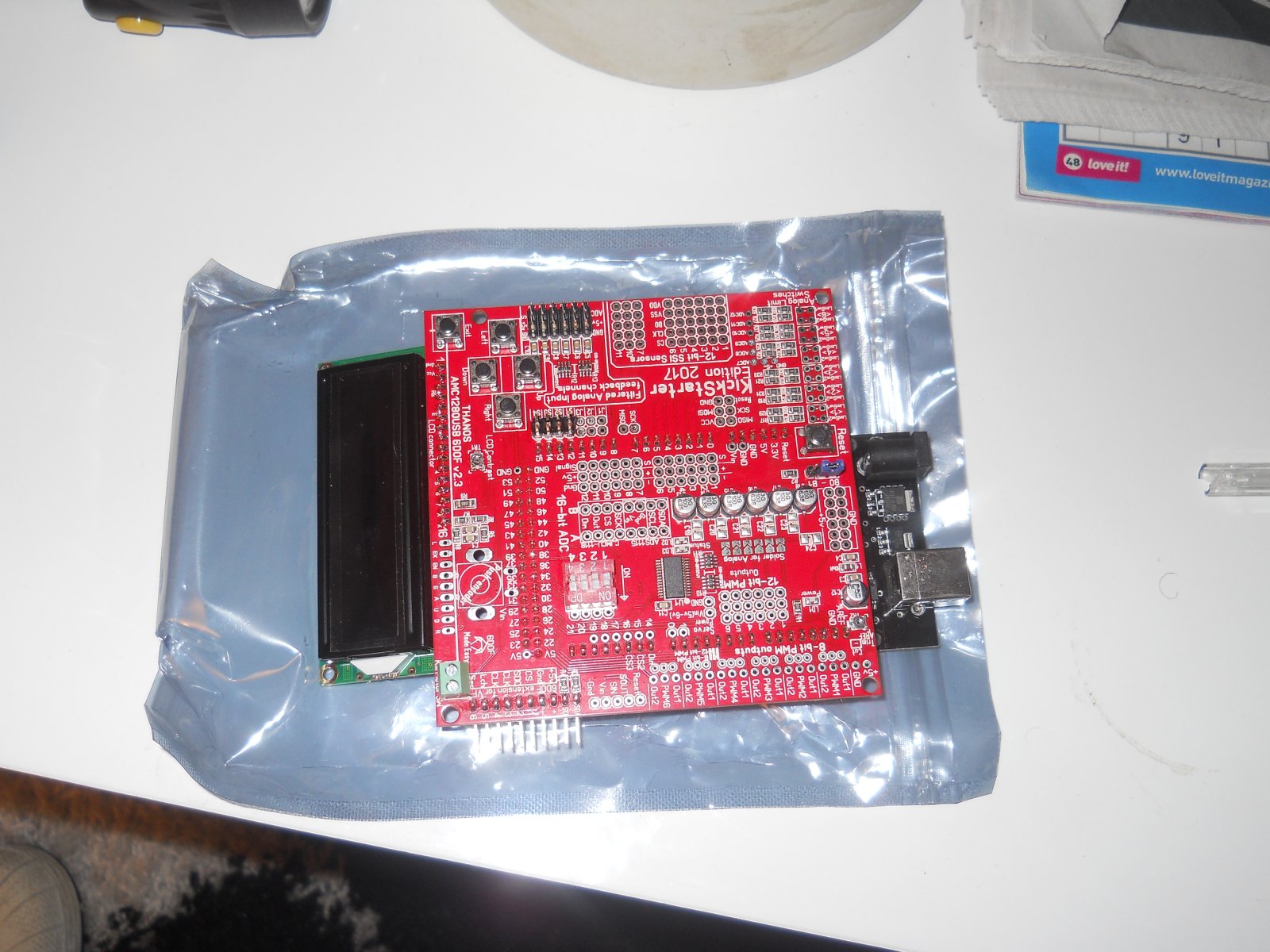

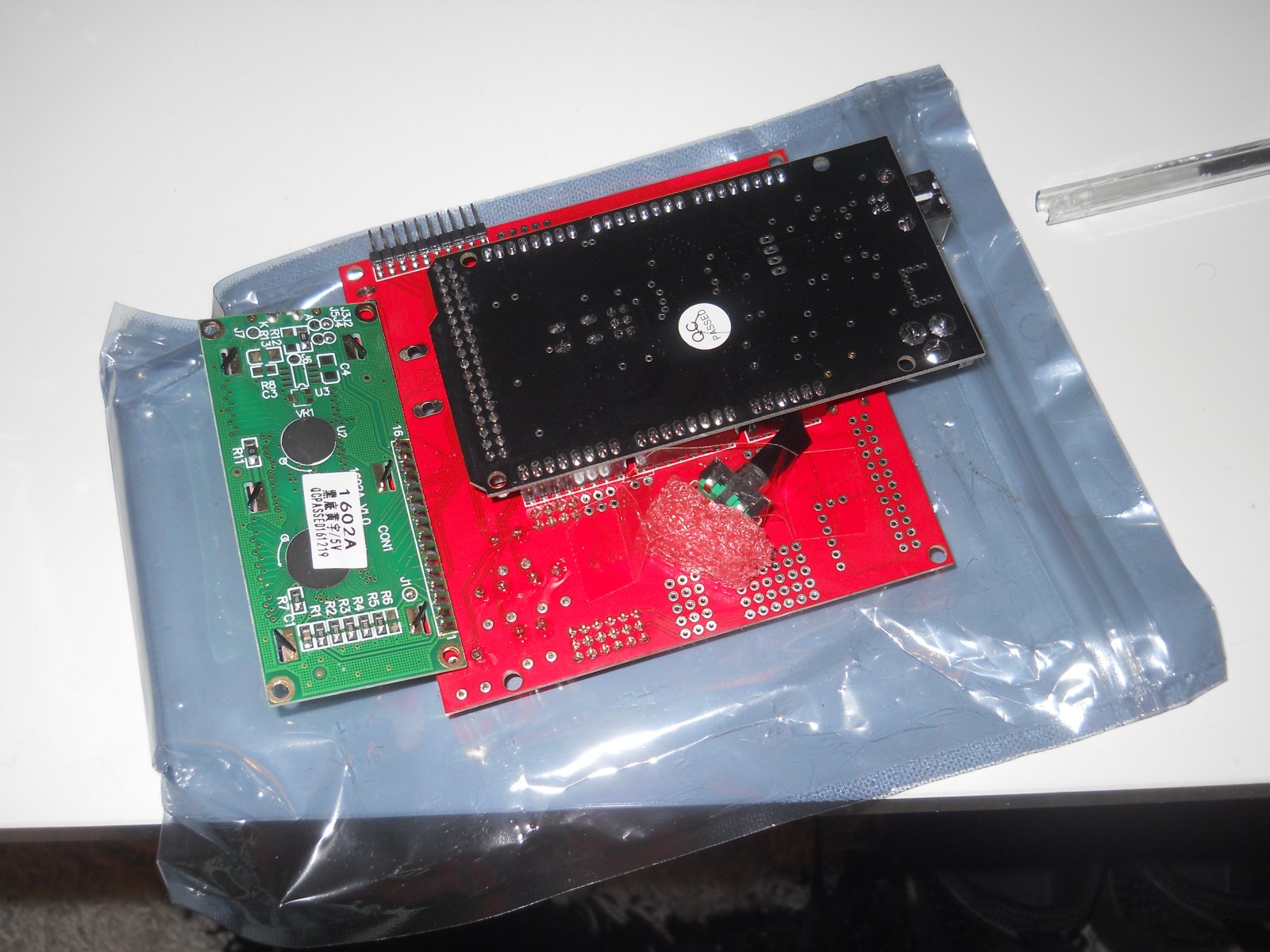

    Hi Guys just a shout out to say thanks to Thanos ,, Second AMC128USb kit arrived and looks great , I now have the original AMC128USB connected to and used as the controlor for my 6 DOF motion platform but using BFF software .. My New Barebone AMC128USB will be used to do the same but this Time Using SIMTOOLS which has far more flexibility simulation software wise ...both platforms have merits so between the two solutions a sweet spot will be achieved .. now my Xmas wish wuld be Encoder feedback as an option LOL ...but as Thanos mentioned , "watch this space he's working on it and a Userguide update " Cheers Crew
