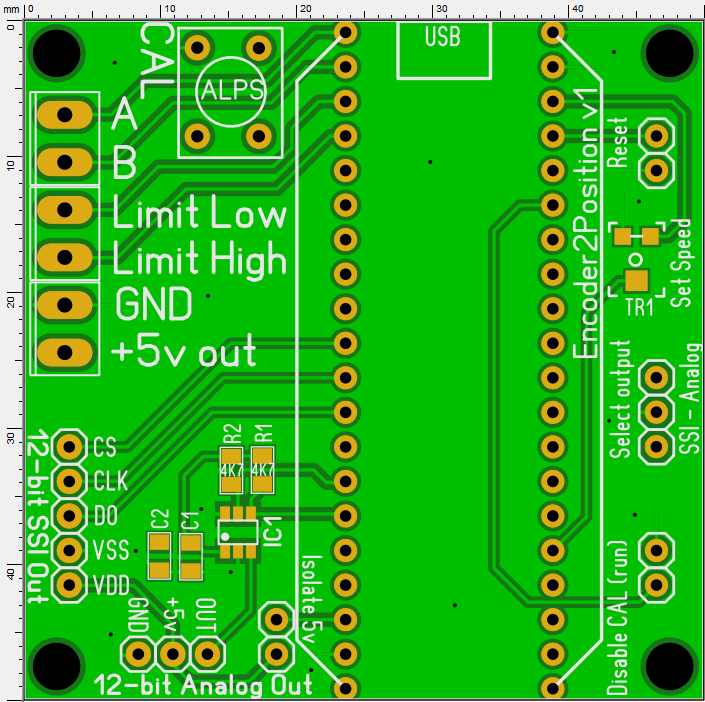

    Well I did some more testing. And designed pcb for it already...

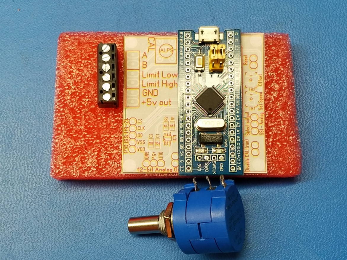

    You don't really have to worry about the encoder resolution, the adapter will stretch and map the total count of pulses into 4096 positions automatically.
    But higher CPR will give finer results.
    Each Encoder2Position adapter will be for one actuator. This ensures no missing pulses no matter how fast the pulses, and stability. Also the pcbs will be very small (50mm x 50mm).
    I'll provide it with only SMT parts soldered to minimize the production cost. Ultimately you will have to solder the connectors you are going to use, and a few pin headers.
    Most likely it will be available on Tindie rather soon:
    https://www.tindie.com/stores/Tronicgr/

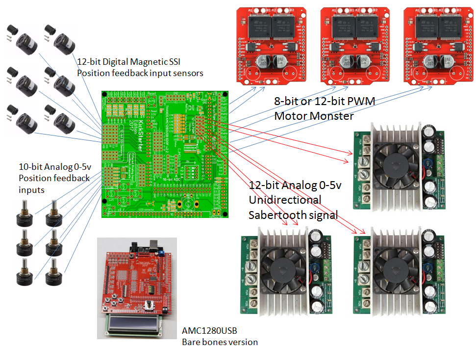

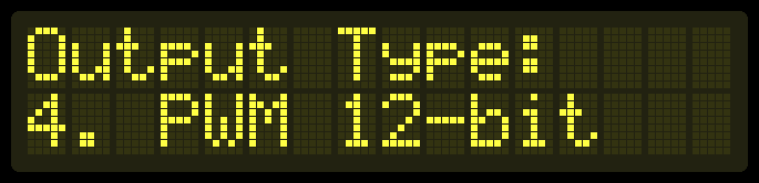

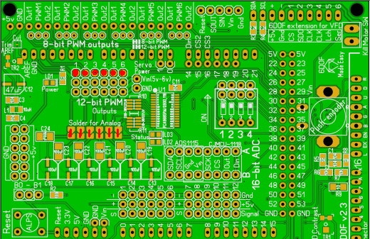

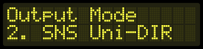

    Hi @Thanos ,Just got my new 1280, (below) is this still the best diagram to wire analog pots and sabertooth? Apart for bridging the 'Analog' solder track bridges, should I also cut the required tracks and place jumpers on the PWM output pins to enable 12 bit Analog?What pins on the 1280 connect to what on the analog pins of the sabertooth?Also how do the 'Analog Limit switches' work? I know you are bring out a manual in the future, but guess I'm just after the basics to enable me to get my sim back up and working - I'm sure I am not the only one..:).
  17. Thanos
    Jul 6, 2017
    1,380
    Electronics Engineer
    United States
    2,925Coins
    +1,080 / 10 / -0
    You can get the analog signal directly on the 12bit PWM pin headers indicated below in red marks, no need to modify the PWM with 2mm jumpers (unless you like to connect wires on the side instead of top), and of course solder the analog tracks too:

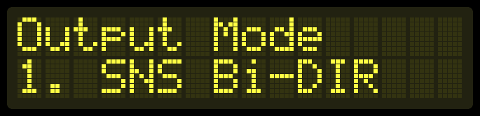

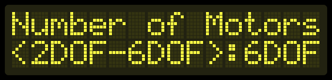

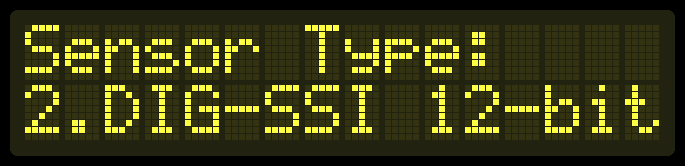

    Also in the LCD menu you need to select:
    and Unidirectional mode:
    The Analog Limit switches function is disabled in the firmware until I verify there are no errors in the PID. I had them interfere in the code before and was hard to debug. But its will be available soon in next firmware update.

    @Thanos and @SeatTime can I just follow the diagram above to install the 1280 into my rig and thats that or is there firmware or code that needs loading into it first ? Im struggling trying to find any info or I'm just being blind I had a look at your twitter and your blog spot @Thanos but im still none the wiser
  20. SilentChill
    2,653
    20,659Coins
    +3,593 / 34 / -0
    I have it all hooked up using settings above and working with simtools just when I get about 1/4 of range of movement it doesnt stop and keeps on going till it hits the end wont reverse. Limit switches do jack all when wired upto the kill terminal ?
    Pulling my hair out
    Also how are the dip switches suppose to be set ? I used the settings from the old manual i set 1 to on and 3 to on
