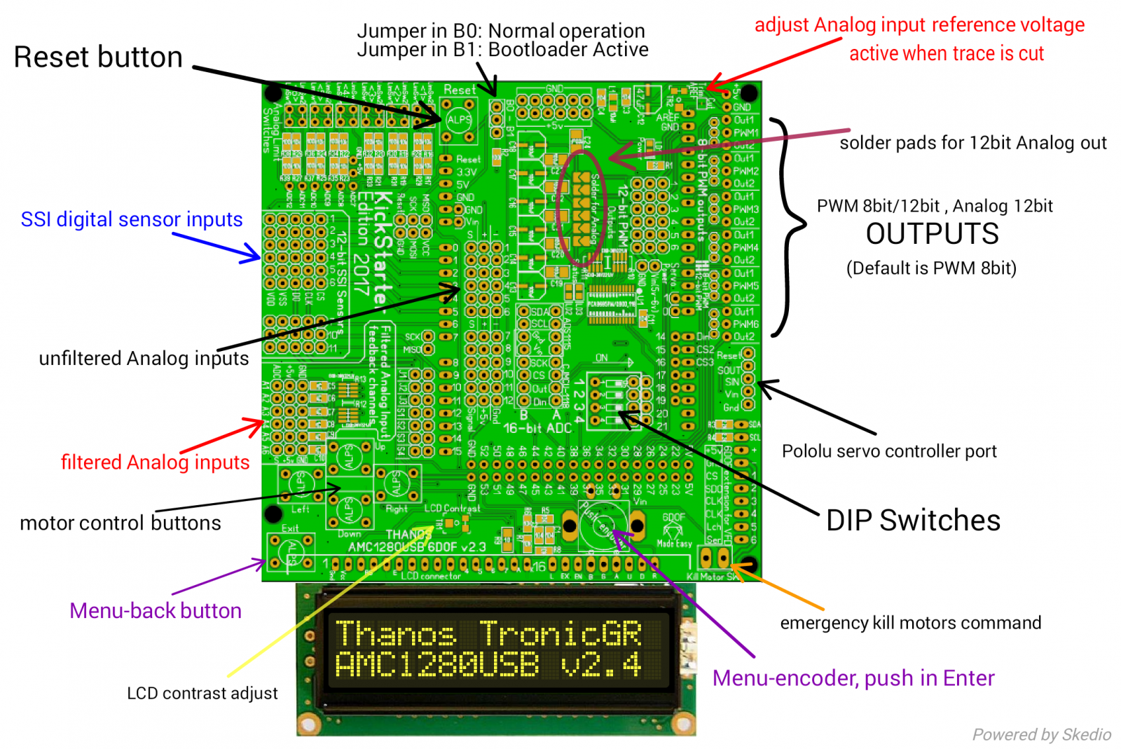

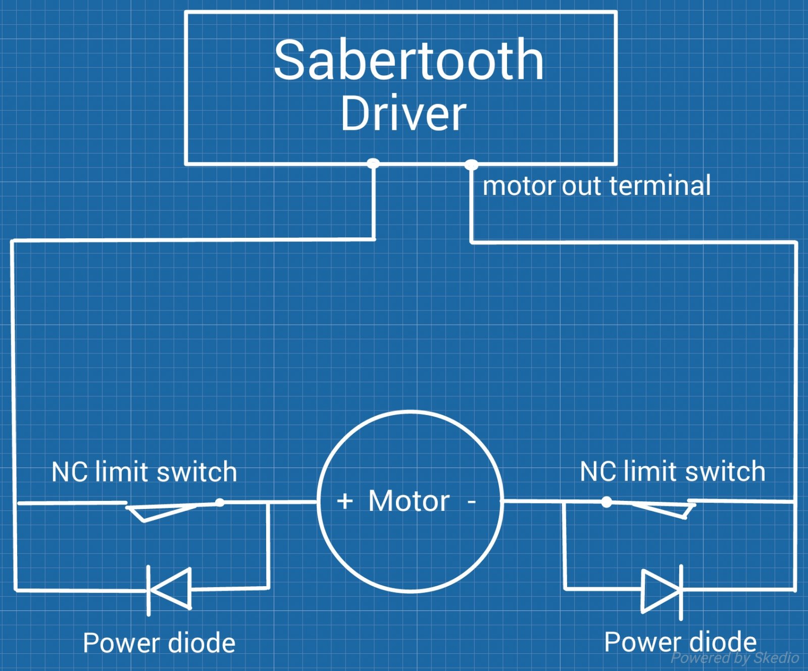

    I'll enable the limit switches function on next firmware revision. But there is a better way to make passive limit switches right on the M+ and M- of the motor using direction blocking diodes along the limit switches. I'll share this method in a drawing later.
    Here is a video that should be covering all recent questions about the 12bit analog for sabertooth drives. Had to make it on the dinner table while babysitting the Zoo... anyone else has upload issues to youtube? Took 3 hours to upload 30 min video...

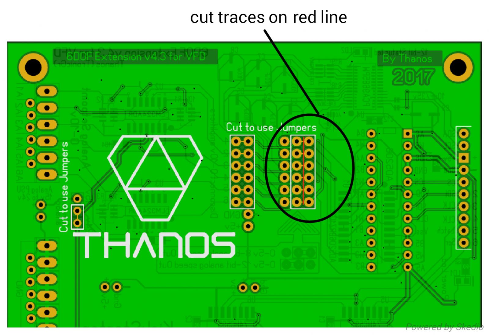

    Hmm, did you cut the traces on the bottom of the pcb on the 6DOF ext board before soldering the pin headers for the jumpers?
    Its hard to help if you just say "does not work". Can you show the wiring you did? Post a list of the settings of your VFD inverters and its model perhaps?
    I can assure you there is nothing wrong in the latest firmware 2.4 rev3. Have a look in the videos where i test all functions with oscilloscope.

    Here is passive limit switch solution to protect your linear actuator:
    Like some dc motor linear actuators have:
    https://www.actuonix.com/L12-S-Micro-Linear-Actuator-with-Limit-Switches-p/l12-s.htm

    Just placing this here to explain the main parts of the controller. Very basic stuff...

    yes I cut the jumpers tracks. I put the jumpers on 12 bits.

    Take some clear photos of the top and bottom of the 6dof ext board to see it.
    Do you mean to bypass the current limit resistors on the 6dof ext?
    If your vfd is setup for Source inputs, you don't need to modify the UDN/ULN jumpers. It comes with UDN chips and is pre-wired setting for it.
    Did you try to measure the voltage output for the 12bit with a multimeter like i did on my videos? If you don't cut the needed traces under the 8bit/12bit pin headers where the jumpers are located, the 12bit outputs will show only up to 0.63v not full 5v swing.
    The 12bit analog output uses 4096 values to set the speed and the PID now runs on double range (8192 values). So it still gets smooth accelerations to target positions under the pid loop).
    You can use 10bit analog sensor and 12bit analog outputs. See my videos above.

    You only need to cut the traces marked with red line on the bottom of the 6DOF ext board.
    No need to cut other traces.
