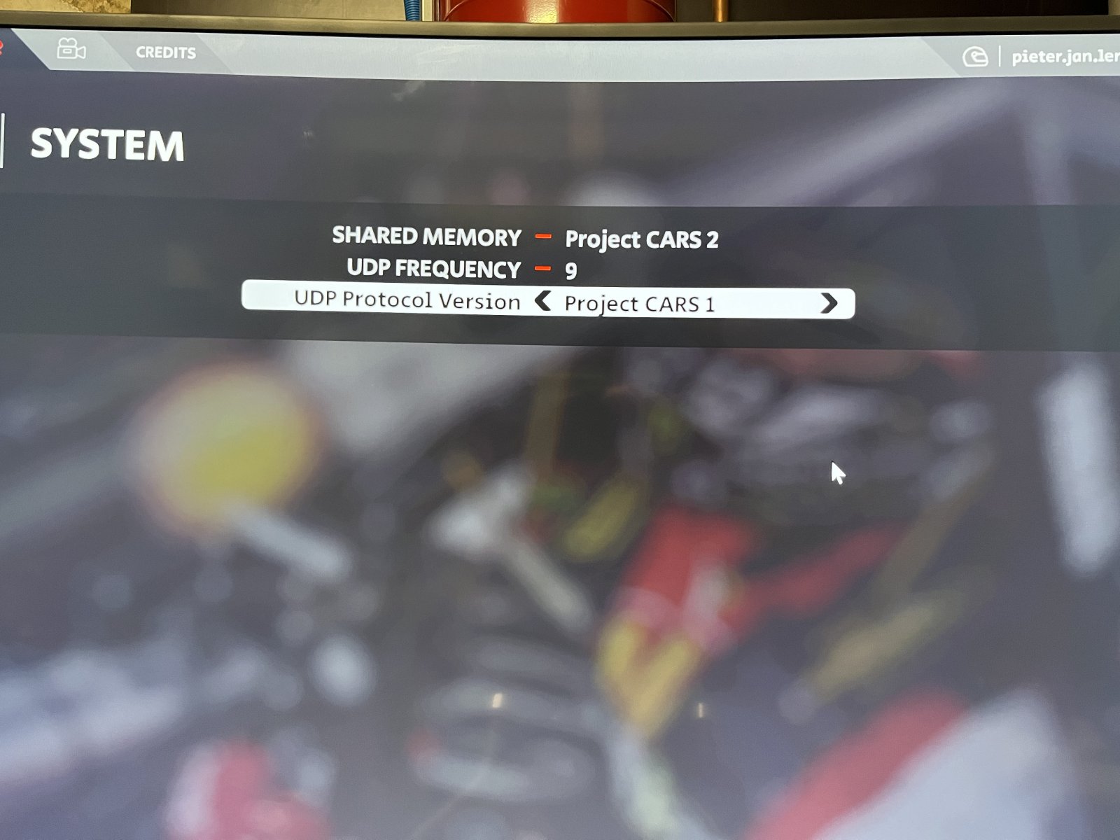

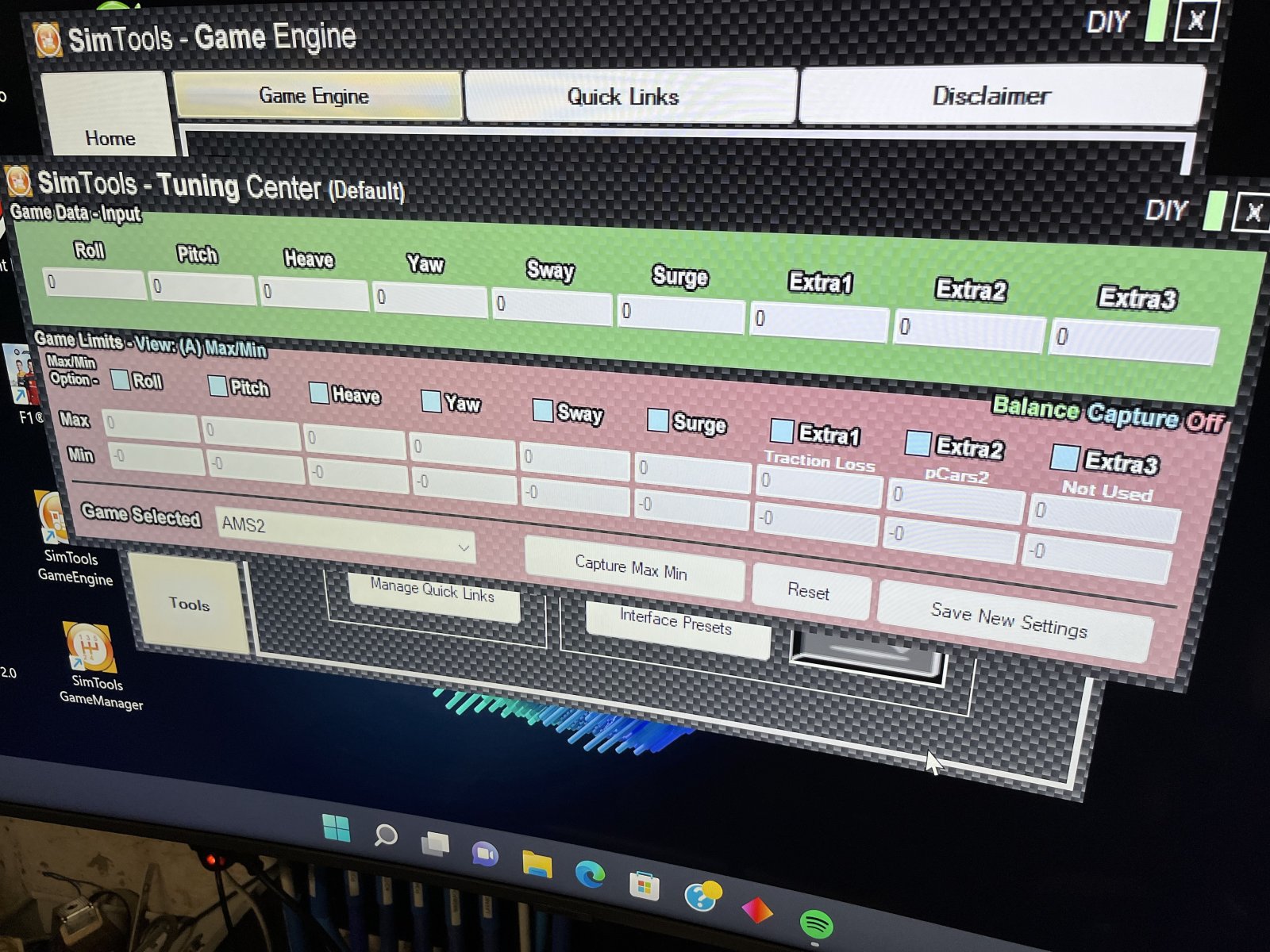

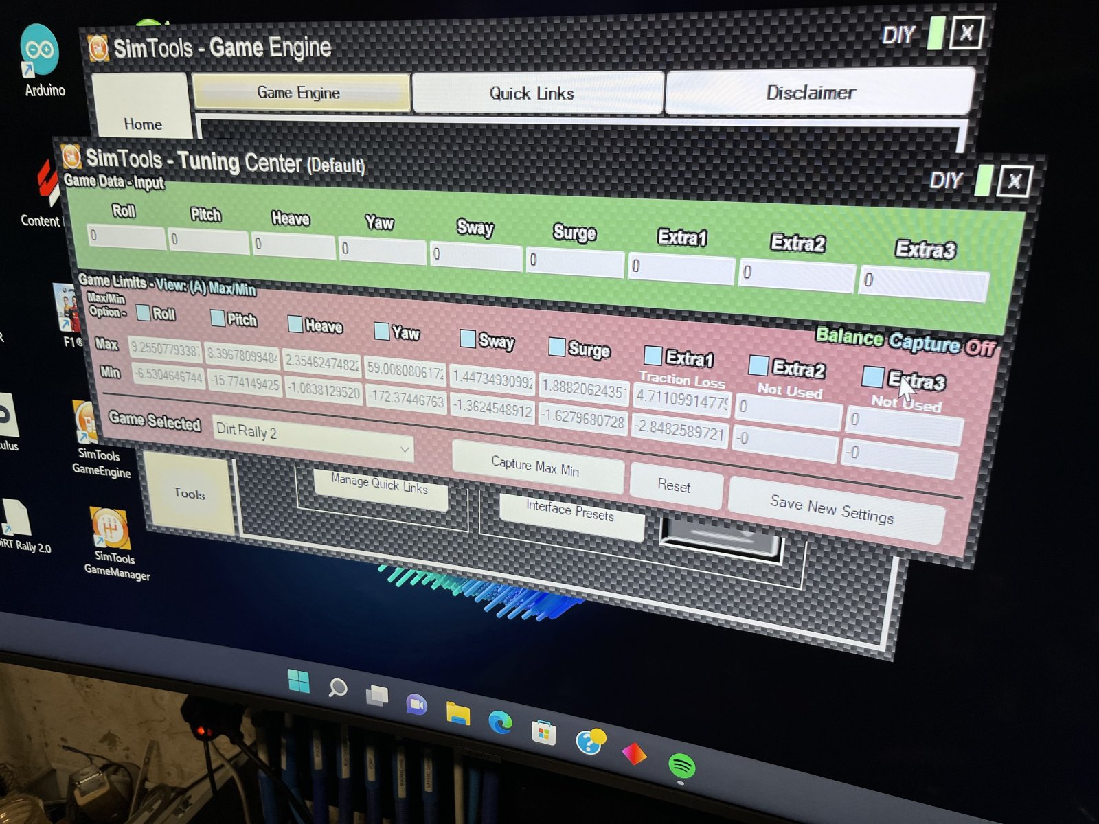

    ok, I tried everything, so another question here: how to make automobilista 2 working. All other games are working, Ams2 not. When I want to capture min/max settings I get values for a second and then everything back to 0. Can I copy values from somebody or another game?

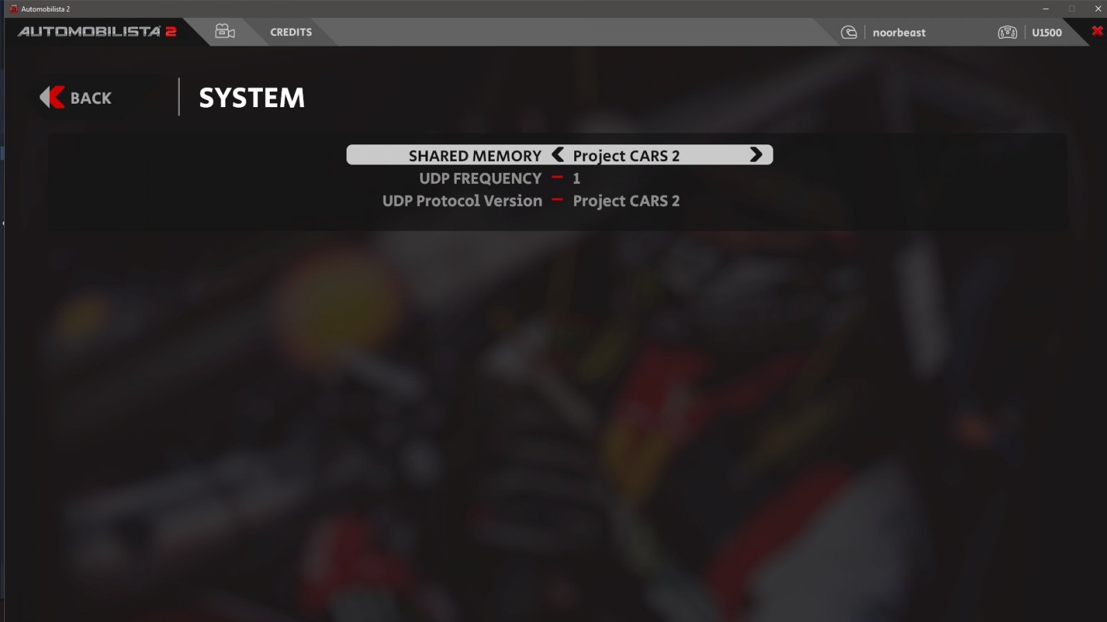

    Can you please post pictures of all of your settings, including in-game settings that are required for automobilista 2.

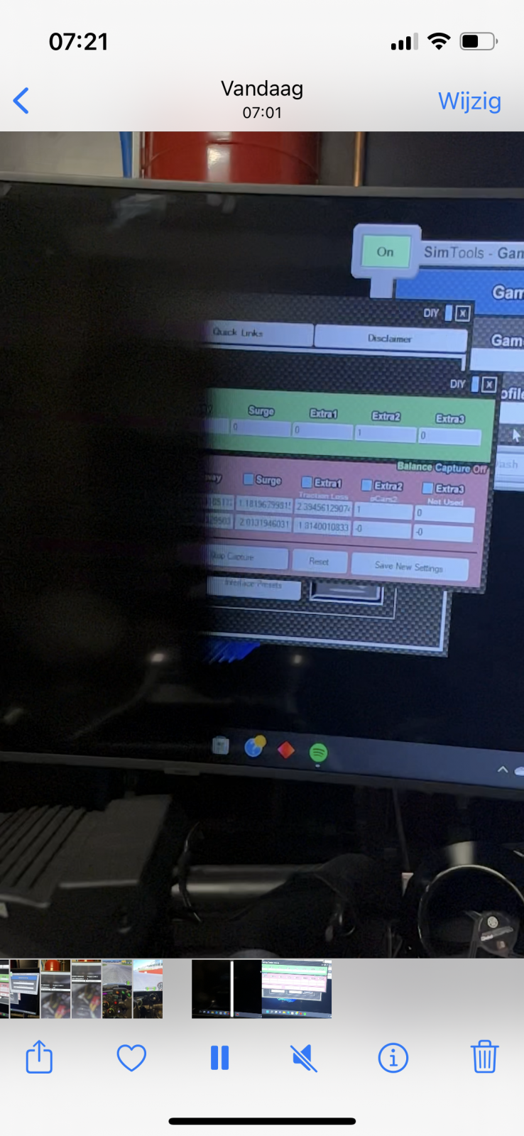

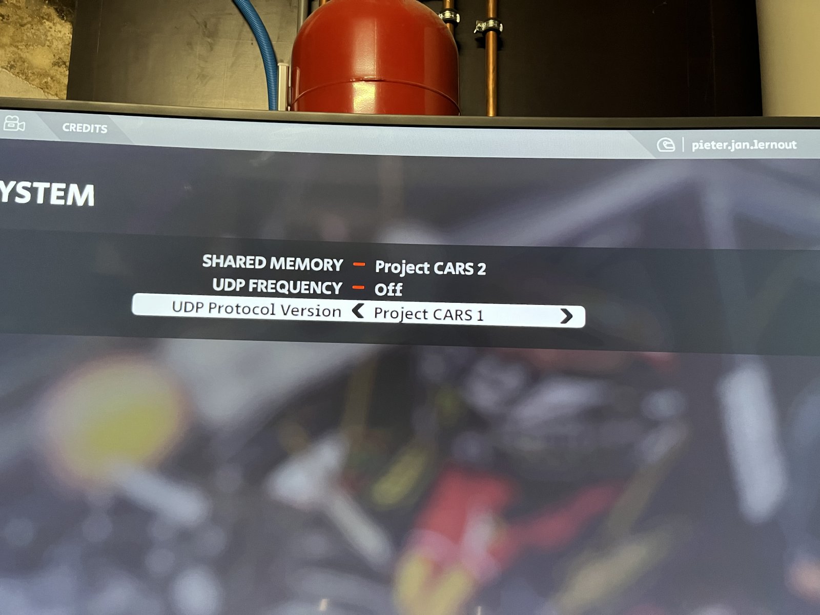

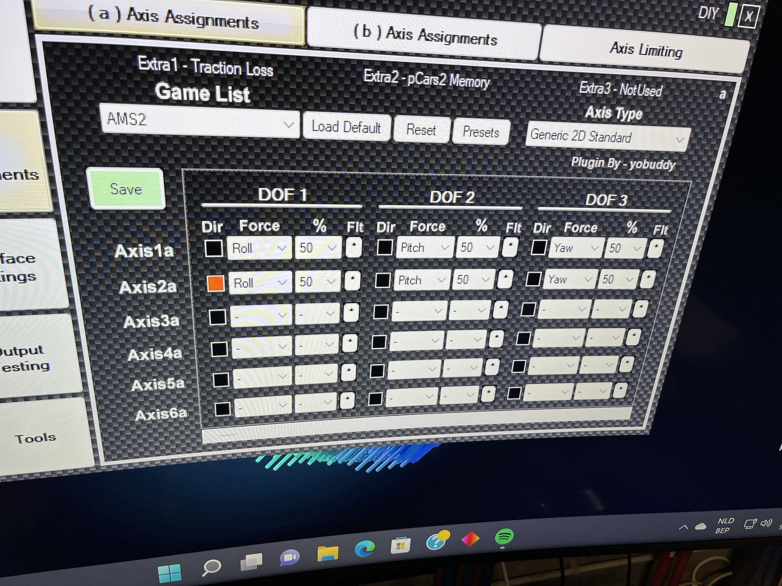

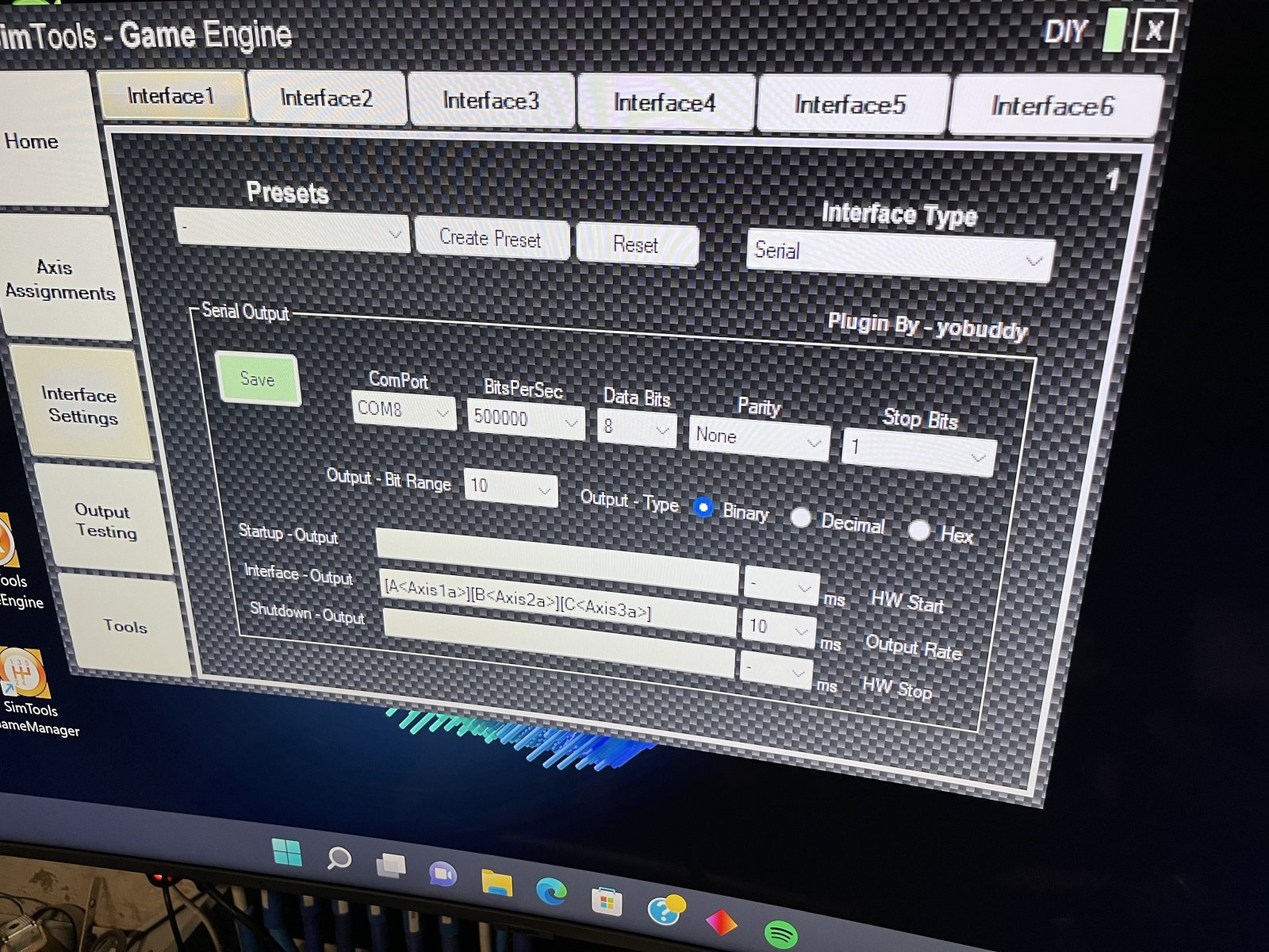

    These are my settings. also made a slow mo video where u can see the values dissappearing so I took a screenshot just before the values were reset. Also included a pic (picture 4) of my settings from dirt rally 2

    These are the in-game settings I use:

    thx, will try
  6. piedjie
    piedjie New Member
    Aug 7, 2022
    26
    79Coins
    +13 / 0 / -0
    and it works. thx man
