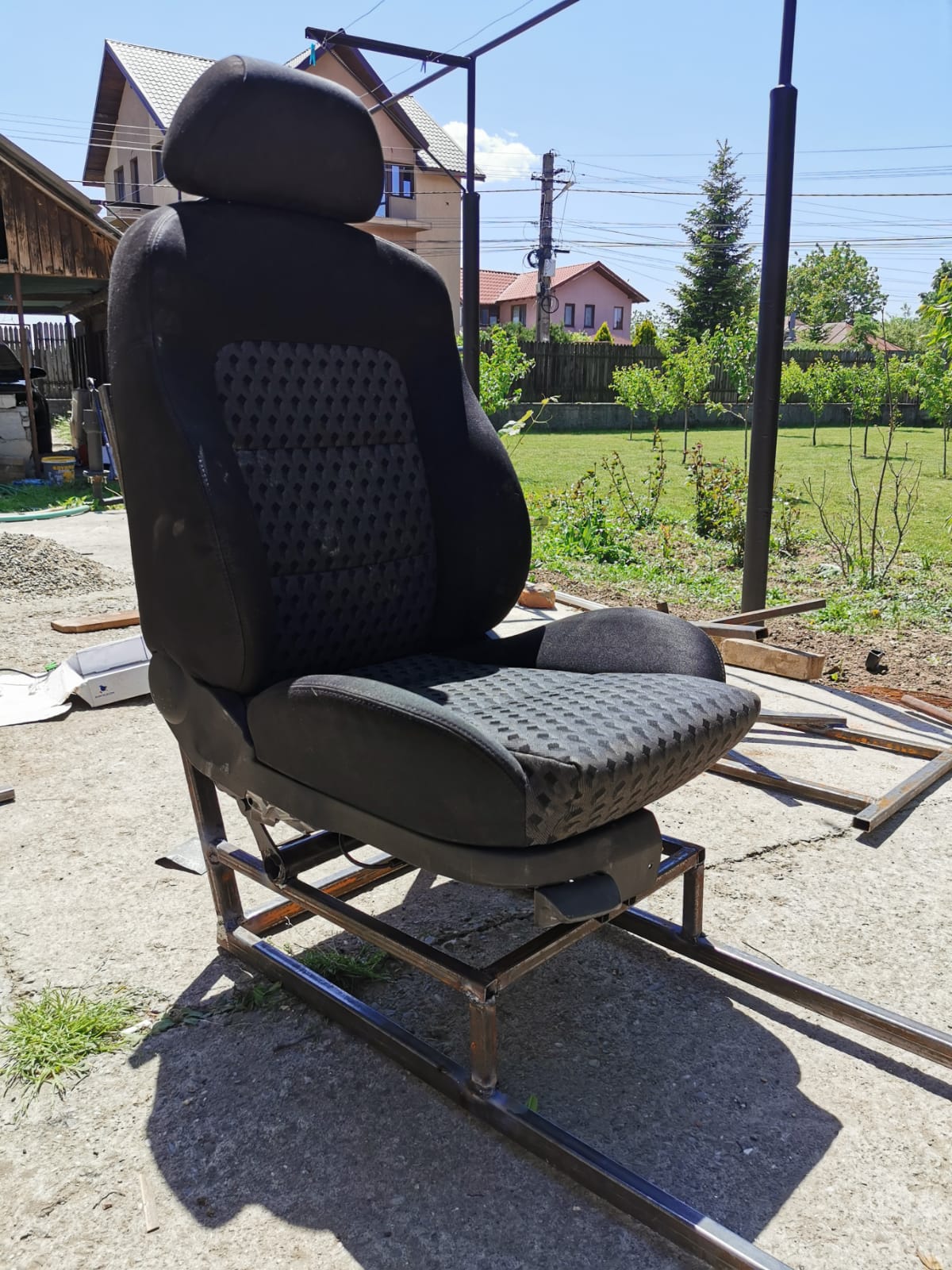

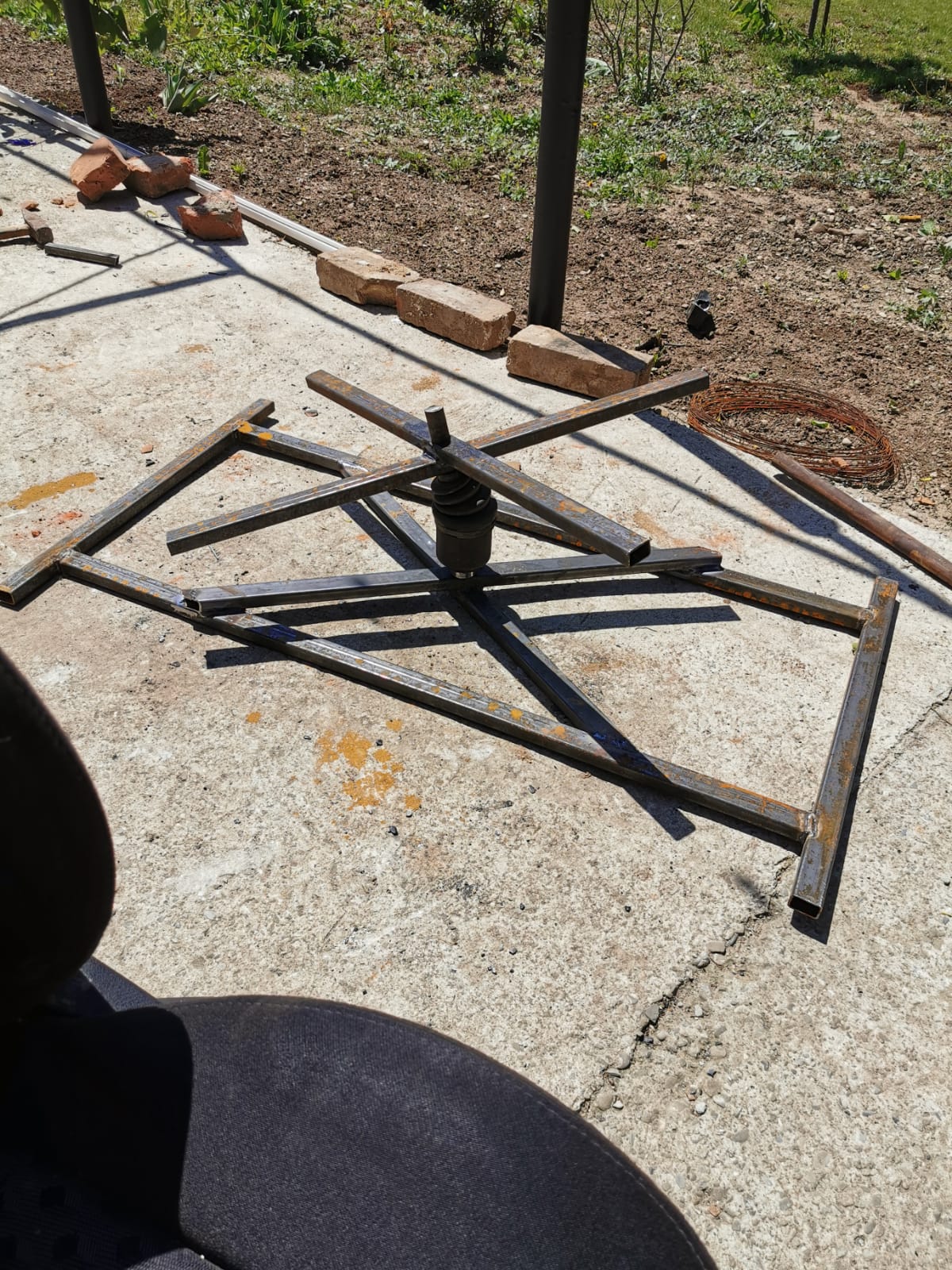

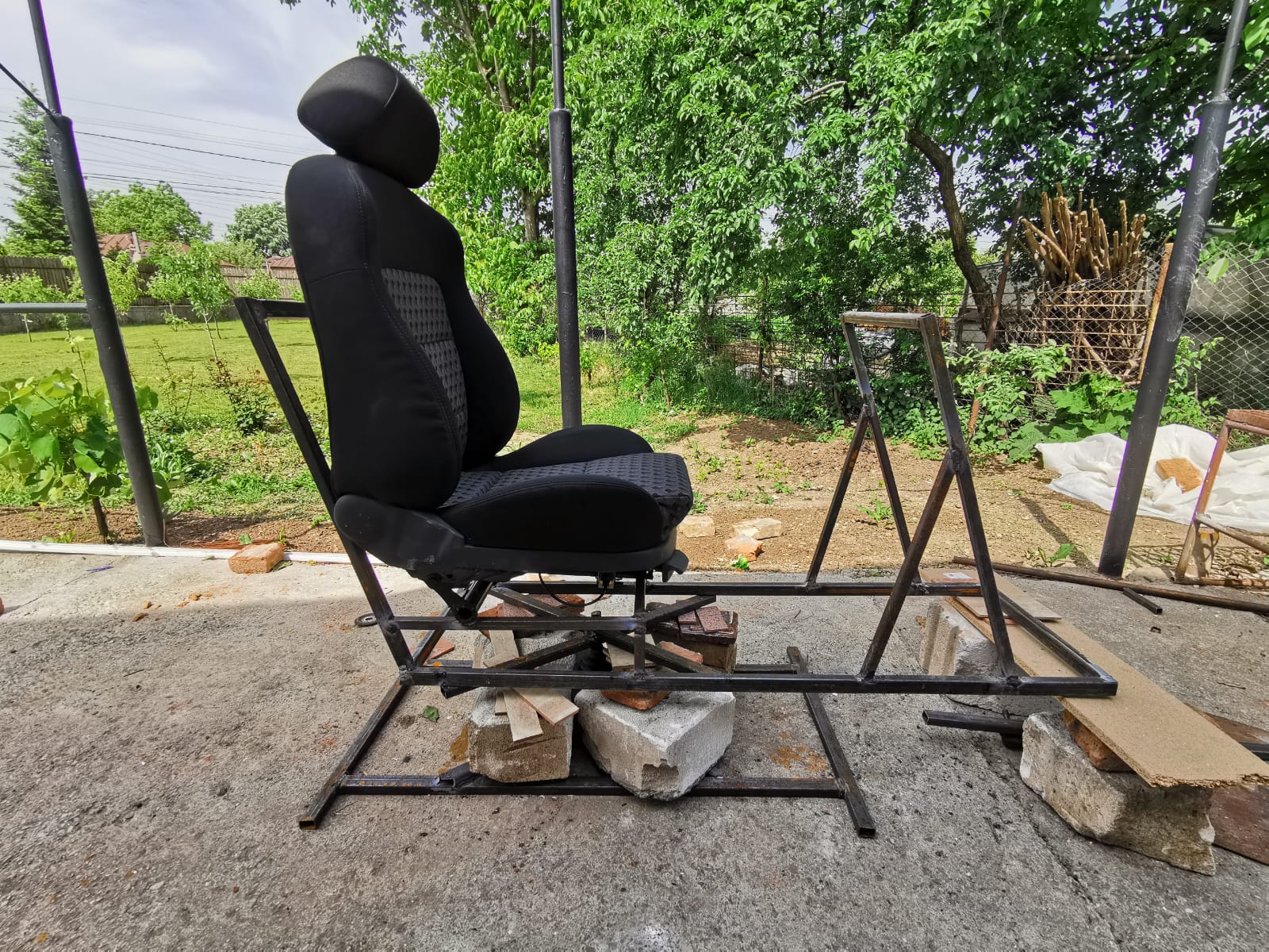

    Ok so I believe that it's time to update this post.
    So I bought a Logitech g920, and this week I started to build the frame.
    I will attach some pictures with the frame.
    I hope that today I will link the frames together with the motors.
  6. Andrei14
    Andrei14 New Member
    Nov 7, 2018
    23
    183Coins
    More pics coming haha :D
    I believe that I made a mistake, and I have to move the 2nd frame forward a little bit.
    Not sure yet about that.

  8. Andrei14
    Andrei14 New Member
    Nov 7, 2018
    23
    183Coins
    Yes the motors are isolated.
    I am following the RacingMat's design.
    The motors will be place at the back of the platform.

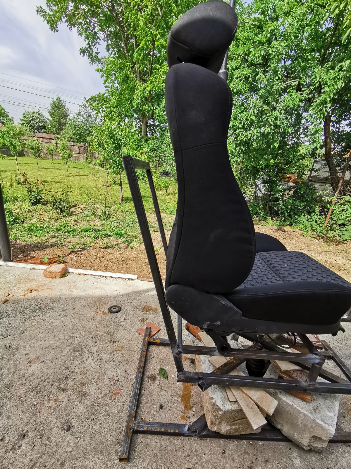

    22,185
    154,750Coins
    +11,196 / 57 / -2
    I will be interested to see how it goes, as a car seat is much heavier than a race seat.
    Why is the seat mounted so high on the top frame? It is preferable to have the seat base as close to the uni joint as possible, otherwise it puts additional strain on the motors, as well as introducing some odd geometry.
  10. Andrei14
    Andrei14 New Member
    Nov 7, 2018
    23
    183Coins
    The seat didn't allowed me to modify it and make it lower.. That was a problem. I hope that the motors have enough power to move the top frame.

    Hi, you were right ahhaha :D the seat is kinda heavy - but right now this is not a problem.
    I need to calculate the G force or at least to approximate it.
    Any idea how could I do it?
    Thanks a lot!
  12. tomkil192
    tomkil192 Member
    Jun 25, 2015
    81
    Uk. London
    - 24Coins
    +26 / 0 / -0
    first grab the grinder and lower the seat right down.
    then make a shorter motor arm (5-6cm center holes - this should be enough to feel good force and not to burn the motors.
    Good luck
  13. Andrei14
    Andrei14 New Member
    Nov 7, 2018
    23
    183Coins
    Yeah I need to redesign the whole thing - at least now I have a better view of how it should be. Anyway I will buy a lighter seat. This one have 20kg or something like that...
    The problem that I have right it is that I need to finish my thesis - and theoretically, I need to calculate the forces that acts on my sim and the G-Forces generated by the linear and longitudinal acceleration.
    I will work more at the design of it after I finish writing my thesis, which is very time consuming..
