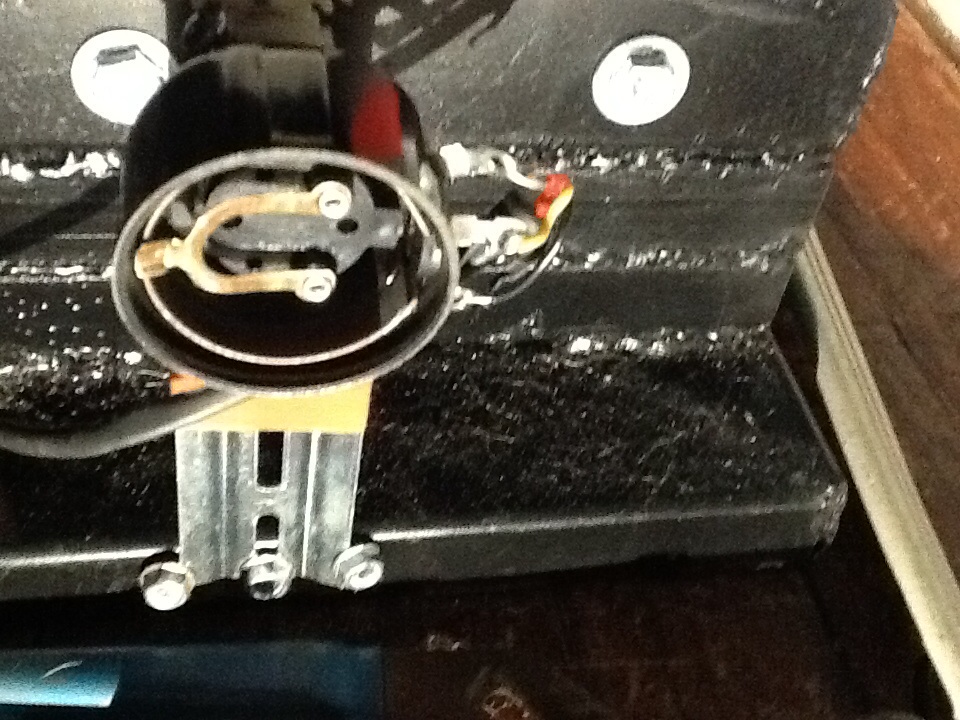

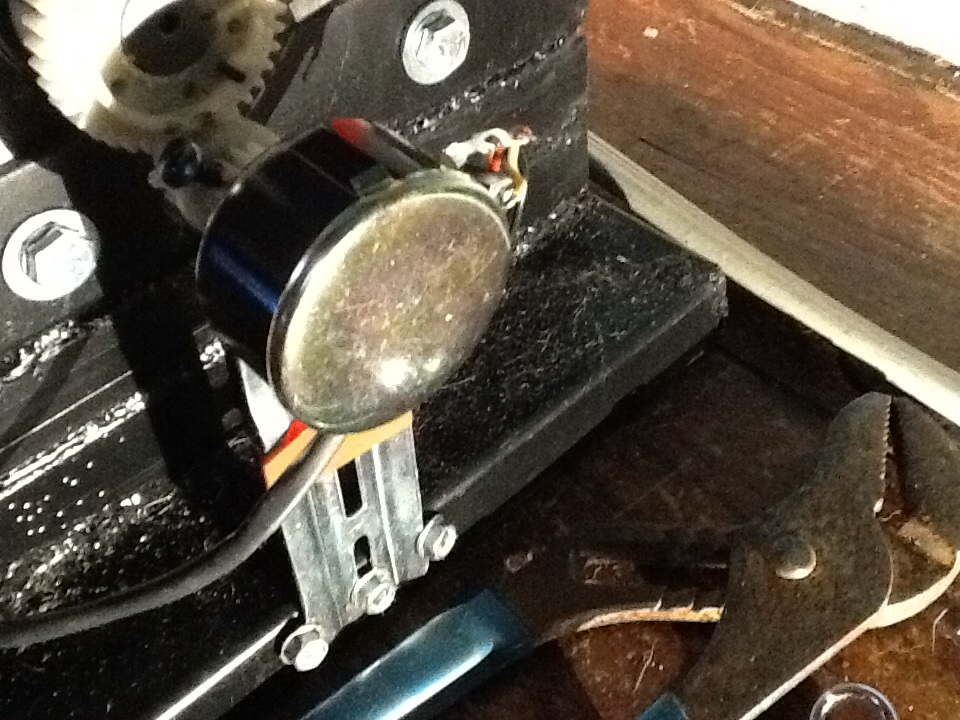

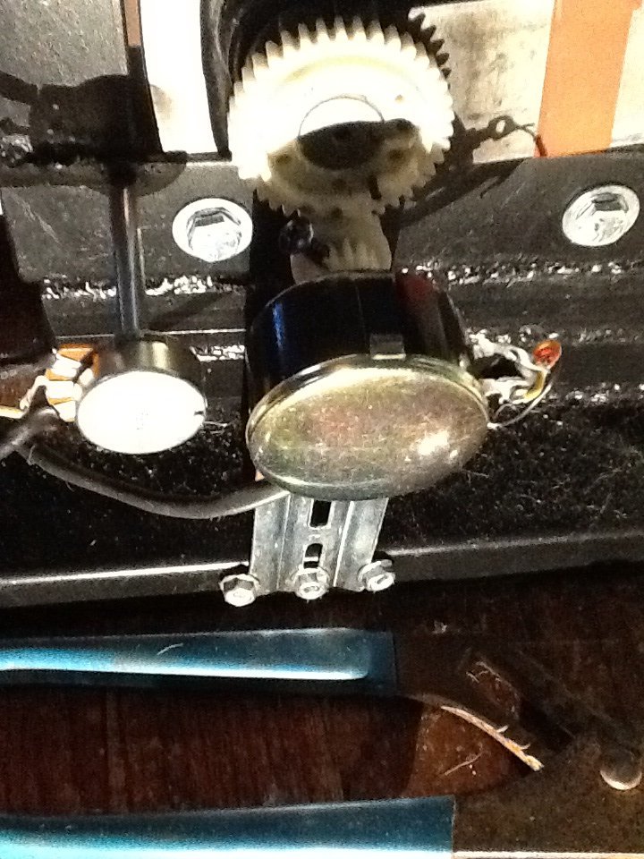

    Your Pot is a 1 turn right? But you geared? what ratio?
  2. bruce stephen
    Jun 7, 2015
    1,286
    general contractor
    michigan
    9,115Coins
    +1,243 / 9 / -0
    Around 2:1 ratio

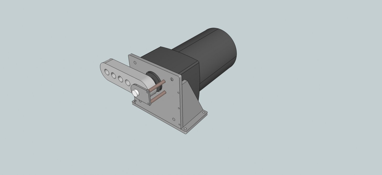

  14. helisfreak
    helisfreak Member
    Jul 25, 2015
    99
    Phoenix, AZ
    591Coins
    +12 / 1 / -0
    Motor mount and pot mounting drawing done. I decided to use 180degree pot I have and try that out first.
    Will build a 2DOF moving platform first, then later might add surge or traction loss, depend on how the 2DOF feel first.

  18. RacingMat
    2,234
    21,094Coins
    hello, motor mounts which allow full 360° turn, are a must.
    If there is any pb in your hardware/software system, you don't break or damage your sim. ;)
    And if your pot coupling is neat, you don't even break it.
