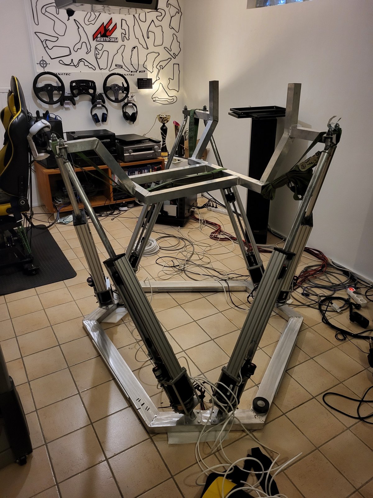

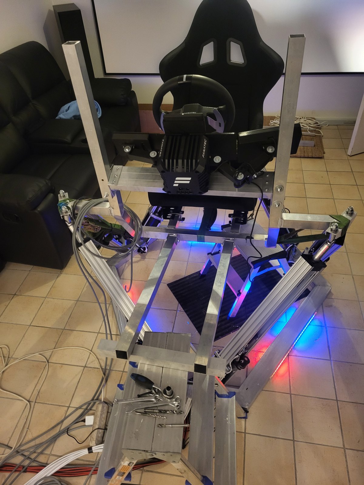

    After a month-long break, I'm back to working on the platform.

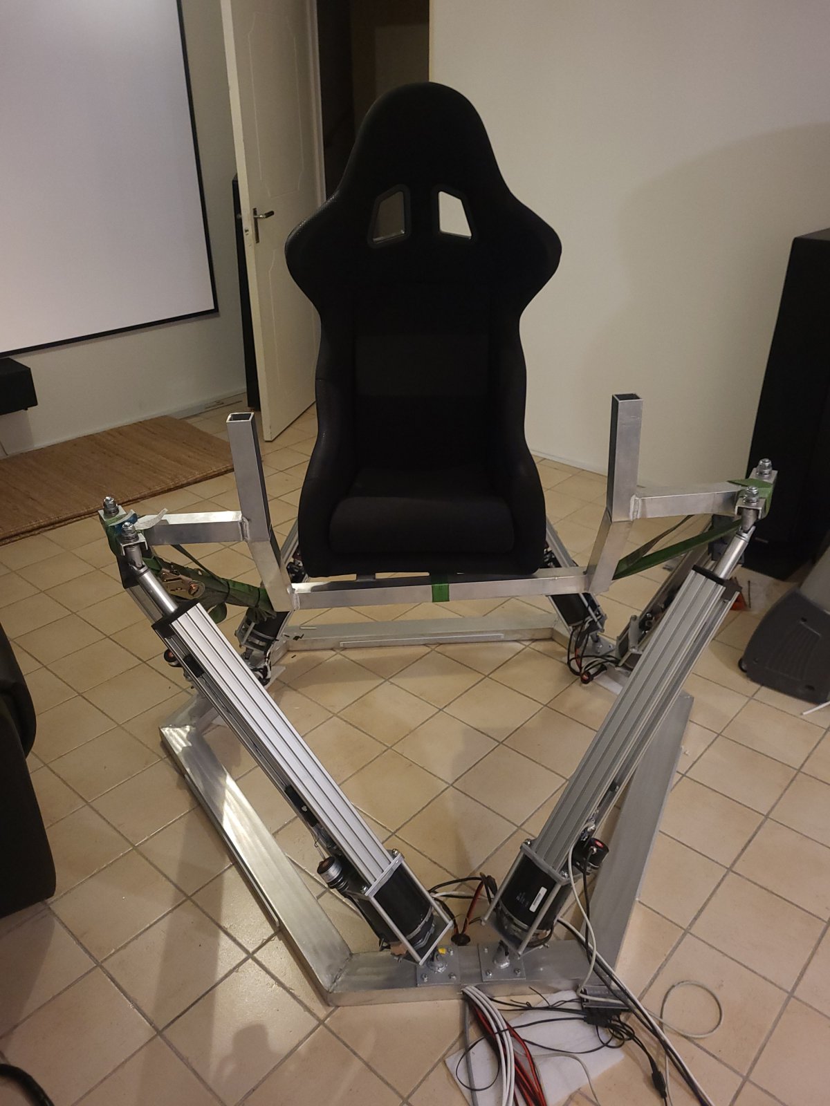

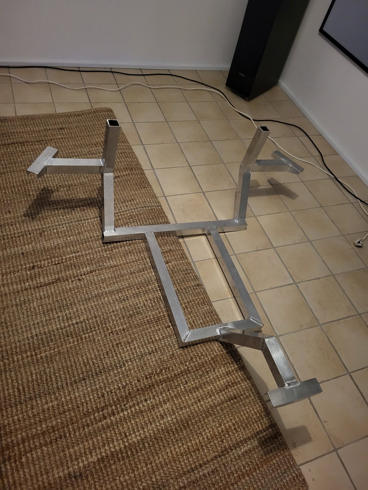

    I managed to find someone locally who welded the aluminum top frame for me, and after a few days it was ready for pickup.
    The frame was ceremoniously connected to the actuators. Just in case, I secured the frame with a cargo strap for testing. And mounted few led strips on the bottom frame.
    Now I could test the platform under load for the first time.

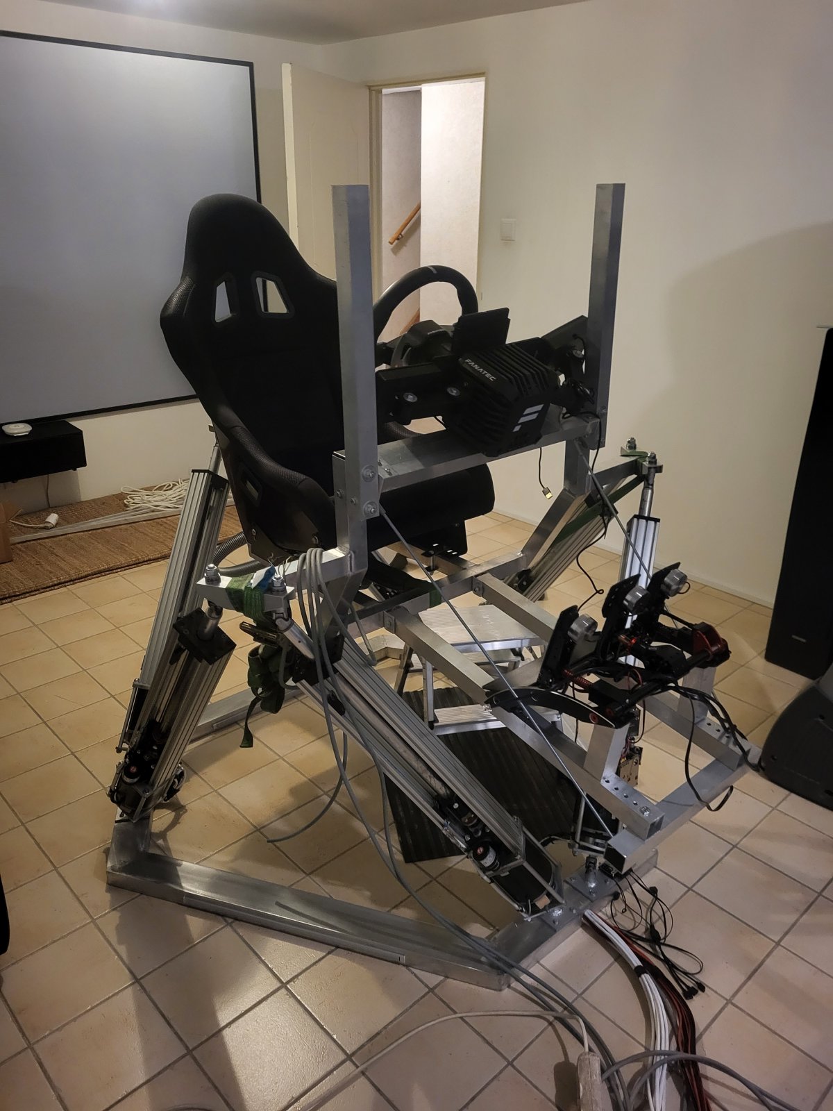

    Next, a racing bucket seat was mounted to the frame,
    and then I built a frame for the steering wheel,
    as well as an extension for mounting the monitor.

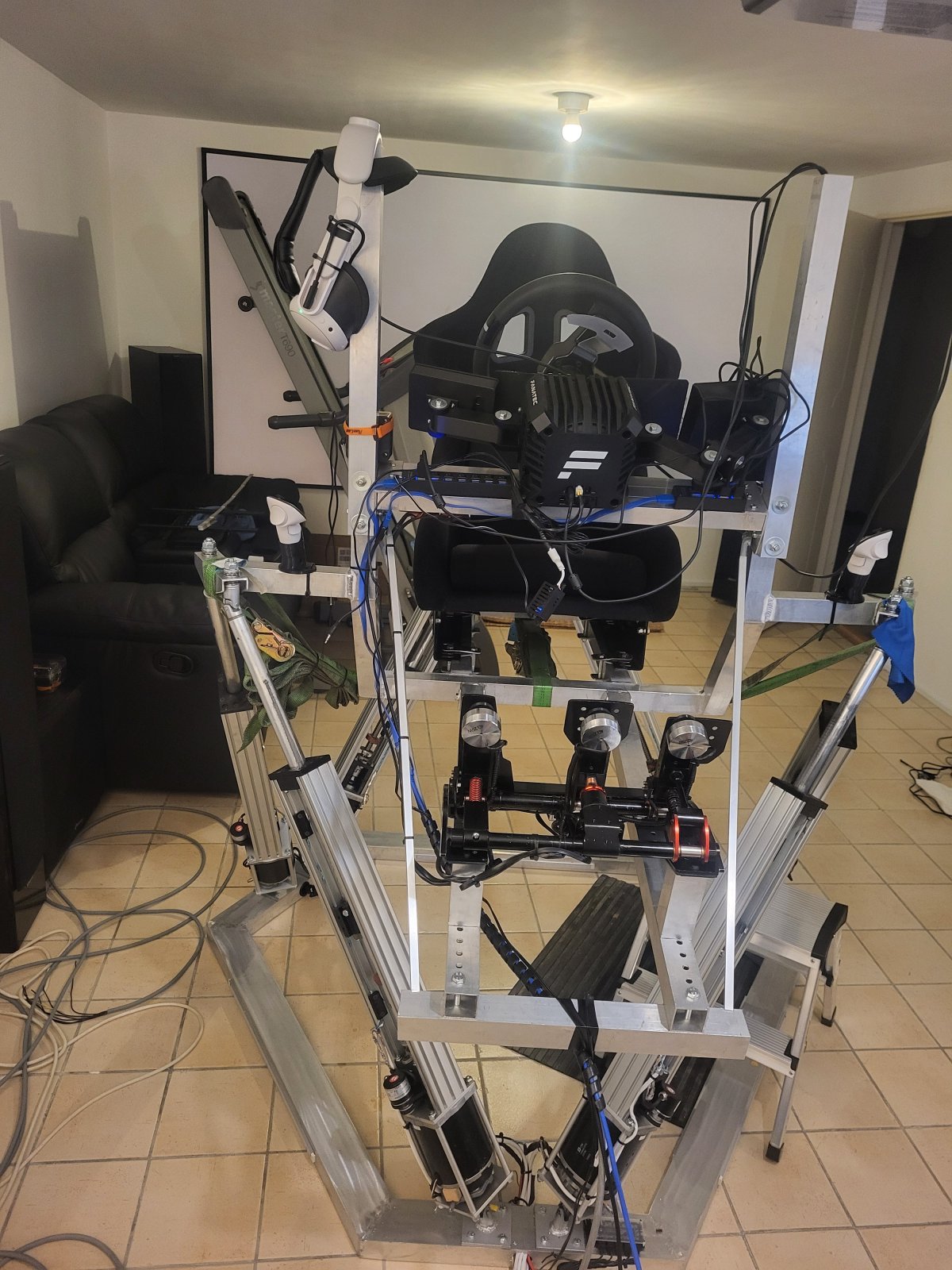

    At this point, I also managed to build a frame for the pedals, and I was able to mount the basic equipment to the platform.
    And finally the weekend came – the time when I could hook up the VR to test the platform.
    After few hours of tests, everything feels great and need adjusting but seems to work well, so I can continue with more equipment to install on the platform.:)

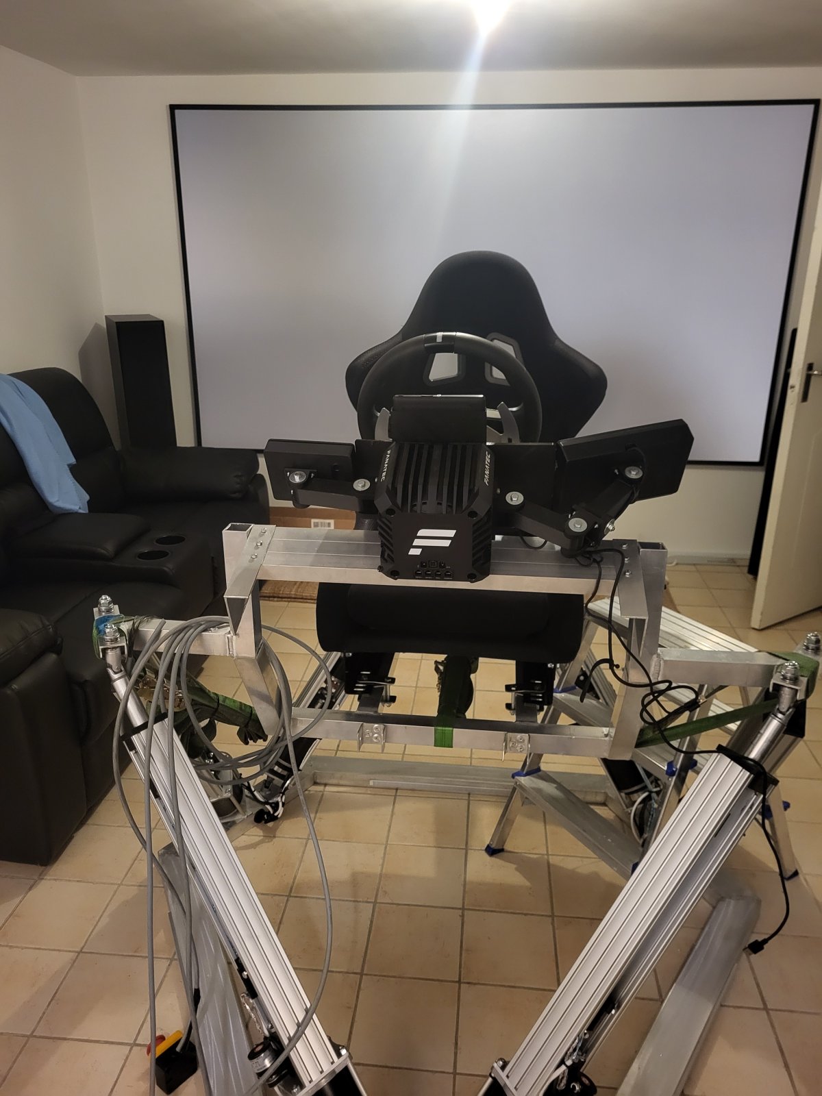

    Today's update.
    Almost at the finish line. After fine-tuning the platform settings, I can say today that this project has brought me an incredible amount of joy. There are still a few things left to do, but even now I’m very happy that it’s almost complete. This project took me about 4 months to complete, mostly working in the evenings, with around a one-month break in between. I ran into a few software issues along the way, but I managed to resolve them. I’ll try to describe the final stages of the build soon.
