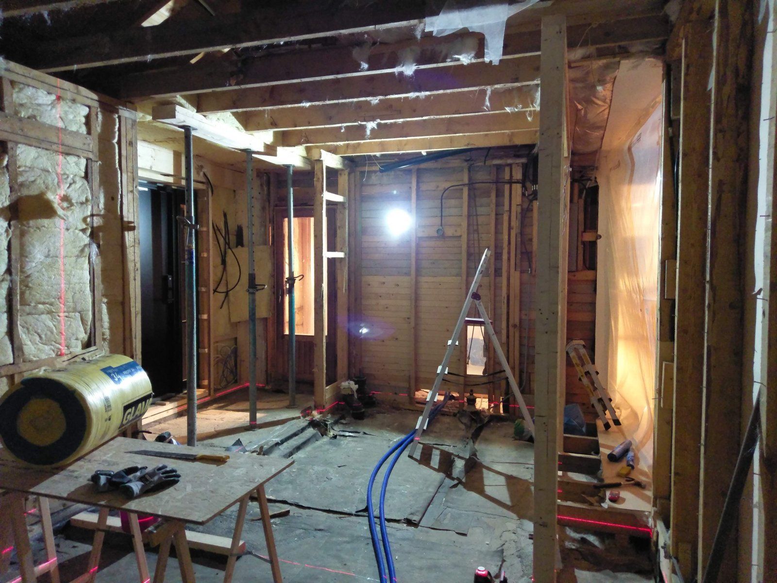

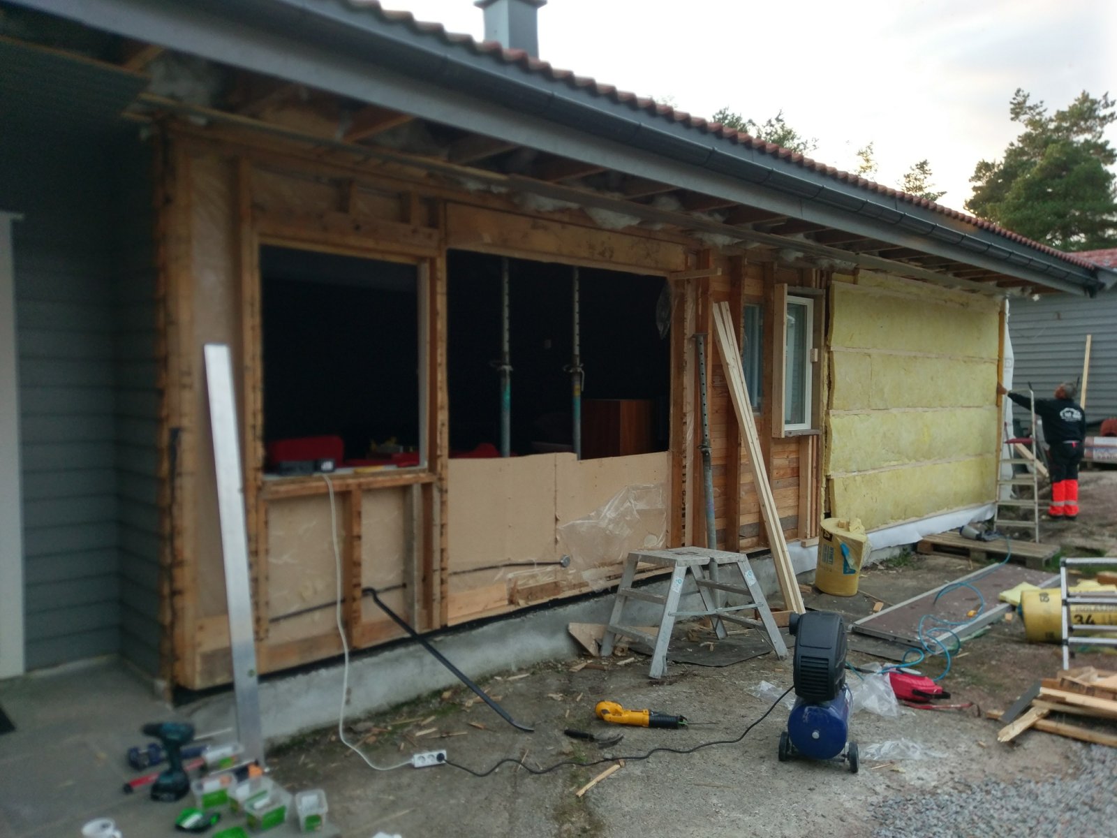

    While waiting for them to arrive, we started renovating the house, built a garage with space on top to actually keep my SIM in it ;)
    I am doing all the work myself (including plumbing and electrics), so it takes some time when everything is done while working a regular 8-16 job. My dad is of good help!

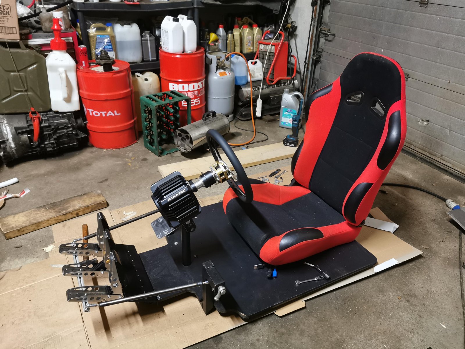

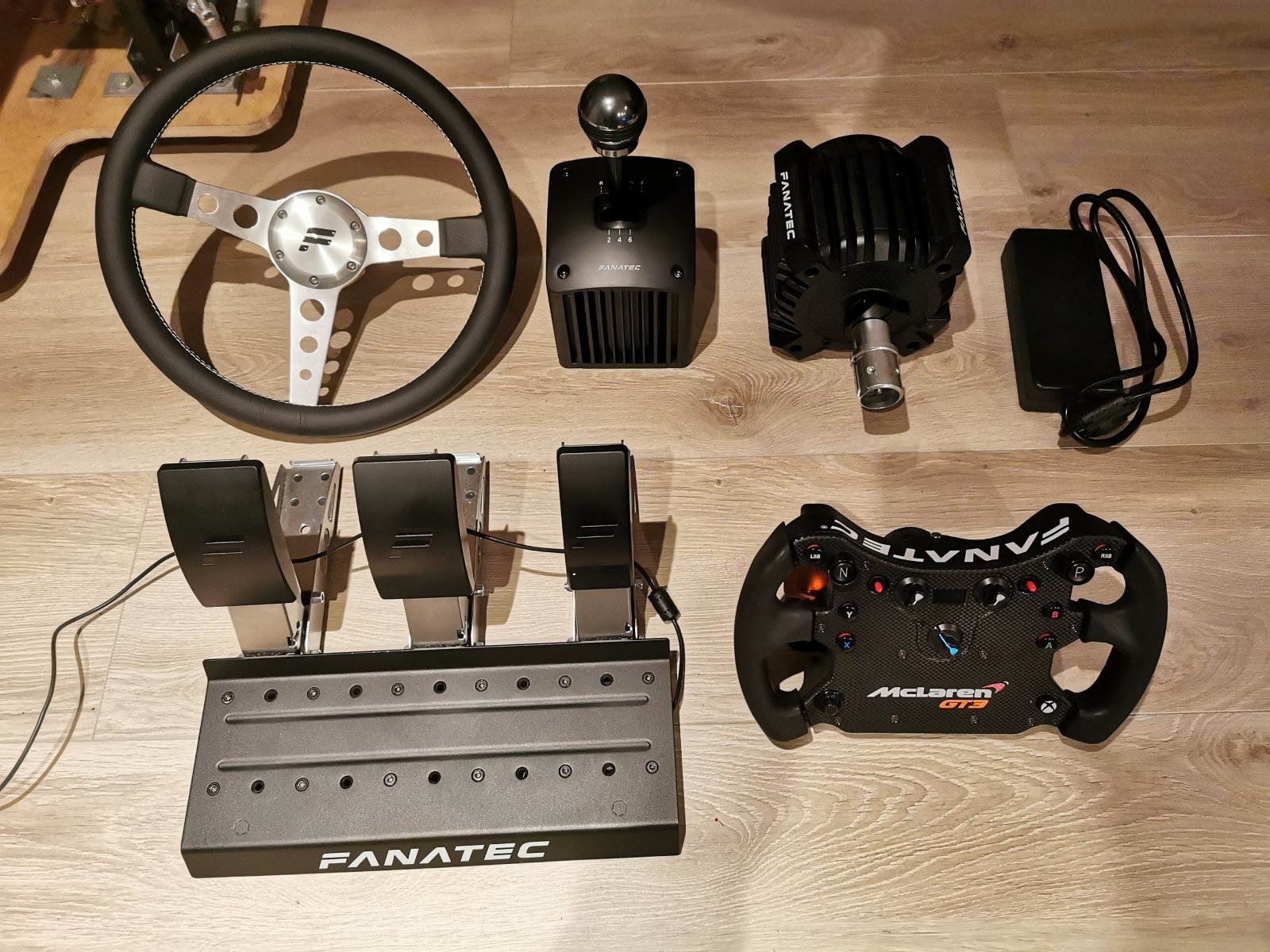

    I wanted a better wheel setup with Direct Drive and got a hold of Fanatec CSL-DD 8nm.
    Plan was to swap my G25 on the Playseat to the new gear, but fitment was bad.
    So I decided to rebuild my SIM instead specifically for the Fanatec and eventually get the motion back up and running.
    I've got Oculus Quest 2 for VR and Asus 32" Ultrawide.

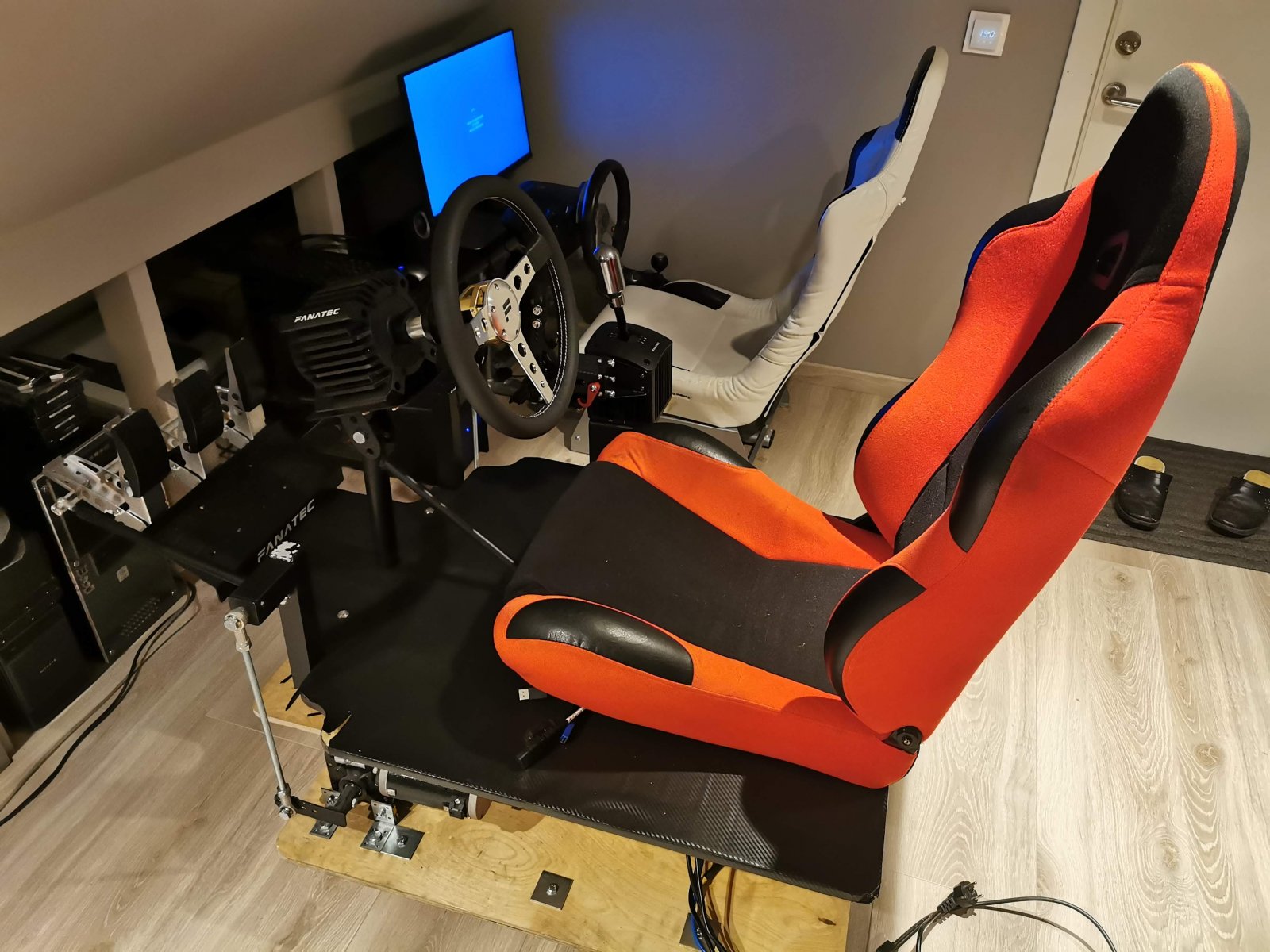

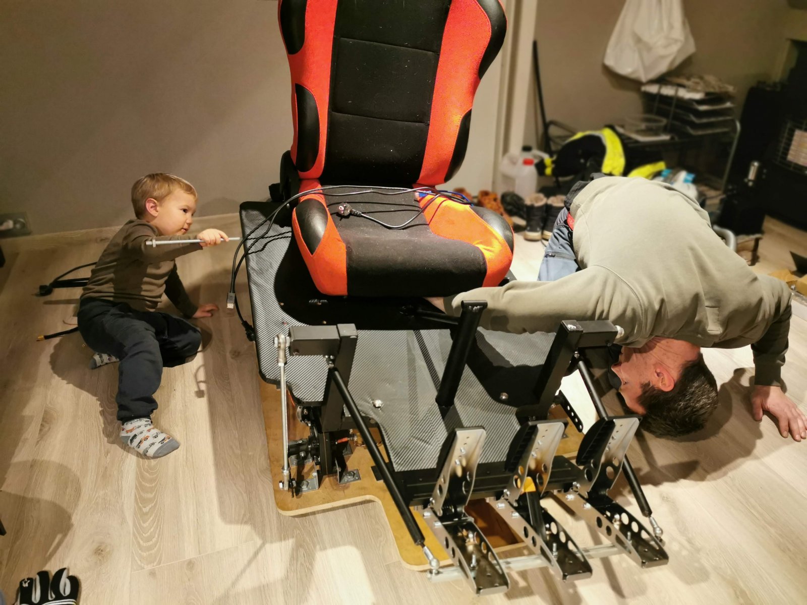

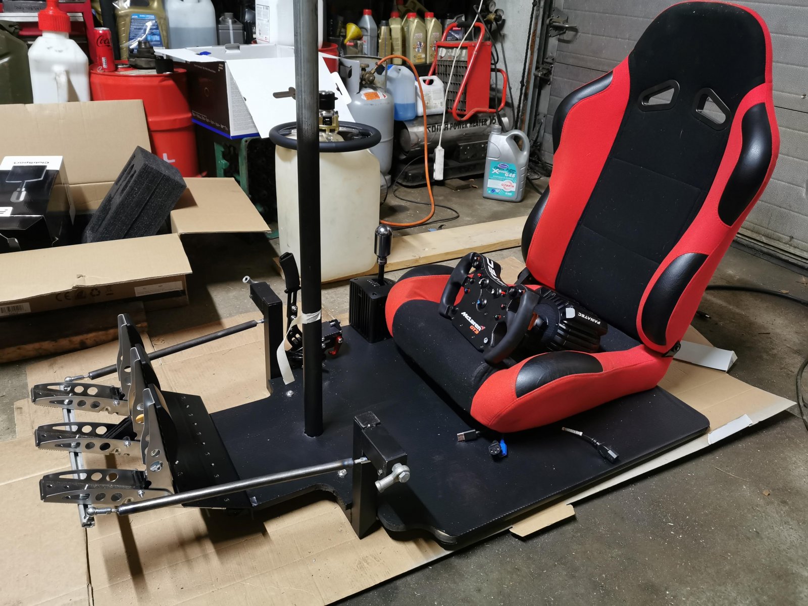

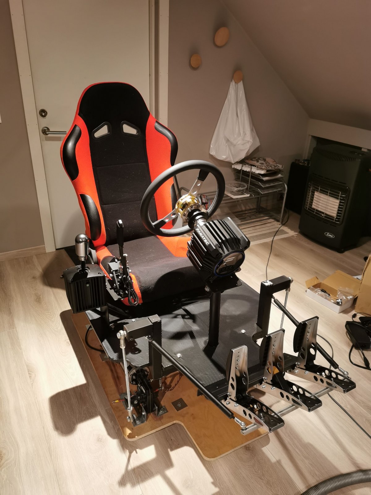

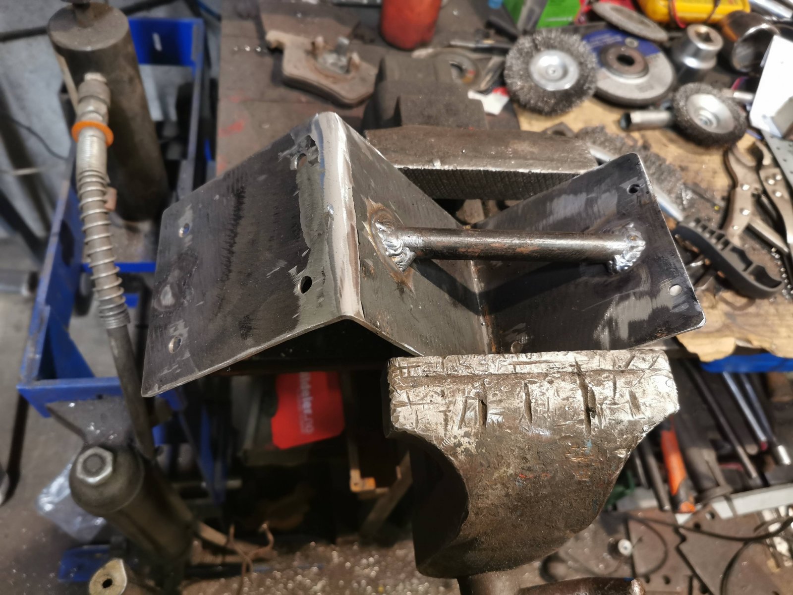

    Had to strenghten the design of the SIM and build all new mounting:
    This is the "top" plate.
    Got it home and mounted it to the bottom frame which contains the SIM hardware:
    Testing the new setup, loving it:
    Next on the to-do list is to get the MotoMonsters I bought in 2016 up and running together with Arduino. Then I will add another DoF, the "slip".

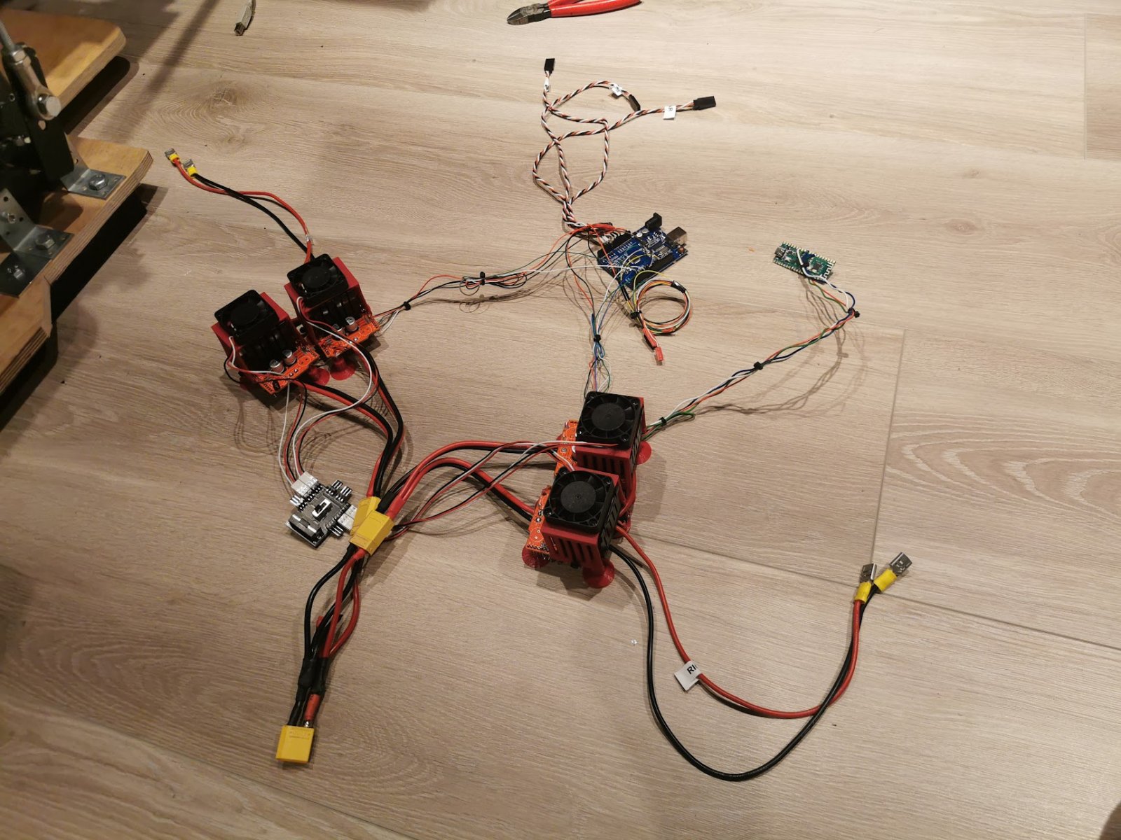

    I've finally gotten around to do the change-over to Moto Monsters and Arduino.
    I also changed to Hall effect POT's.
    Surprisingly enough, I have more or less the same problems running one MM for each motor.
    I am running two HP DPS-600PB in parallell with the load share pin connected. In theory, 575W/47A x2 - a whooping 1150W and 94A - so I've never even considered them to be the problem.

    After still having some occurrences of the Moto monsters shutting down, where the Raspberry Pico logger reported low voltage values when rapid reversals, I changed PSU to a Dell PS-2142 1470W / 121A @ 12v.
    That helped with the voltage drops, but they still went shut down.
    So I've added another Moto monster pr. motor, and now I can drive them pretty hard, but with weight on the Sim I can actually trip the PSU so it goes in to error state.
    Dropped PWmax to 200 and adding 5% smoothening in Simtools filter eliminated the problem.
