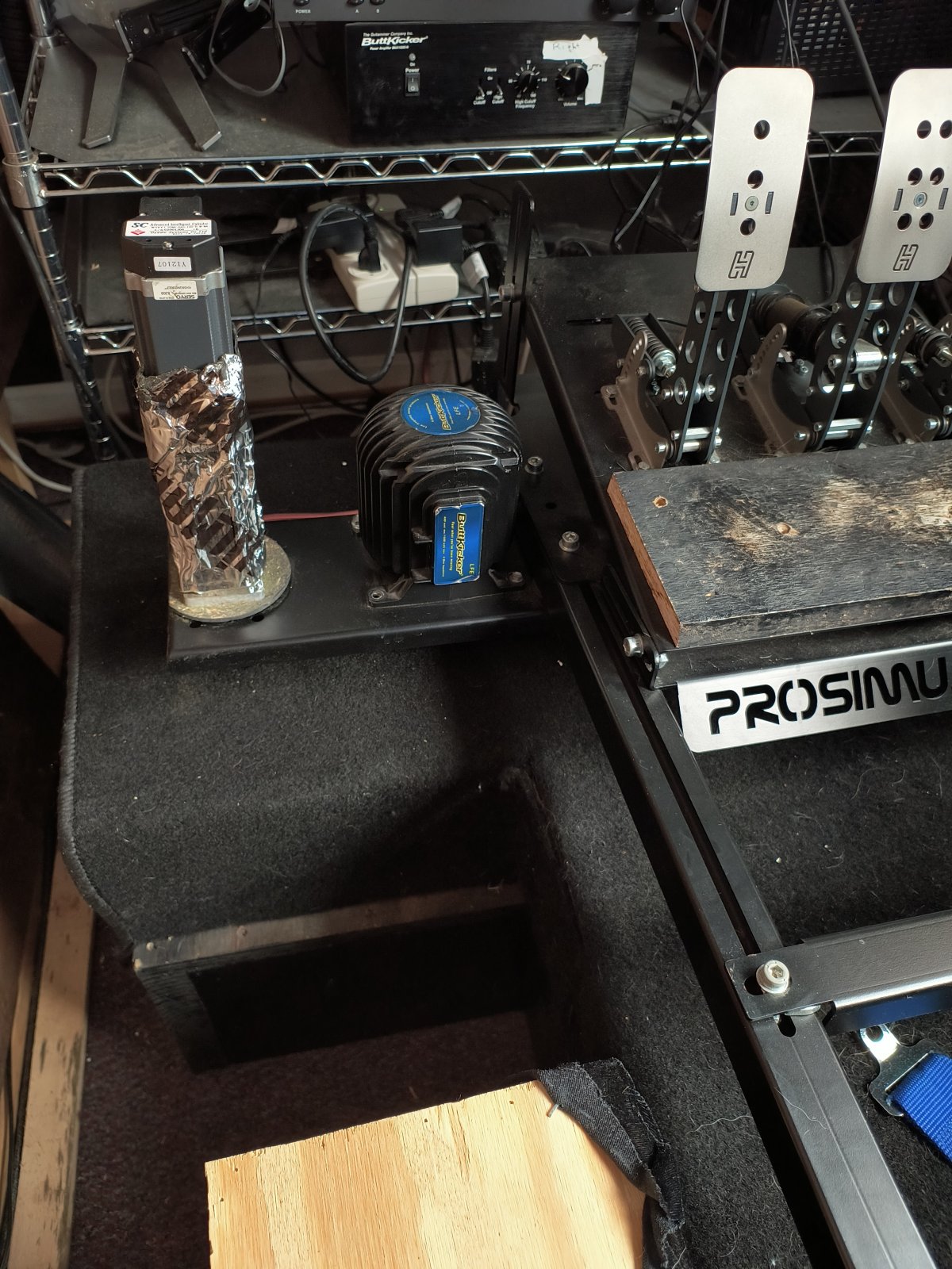

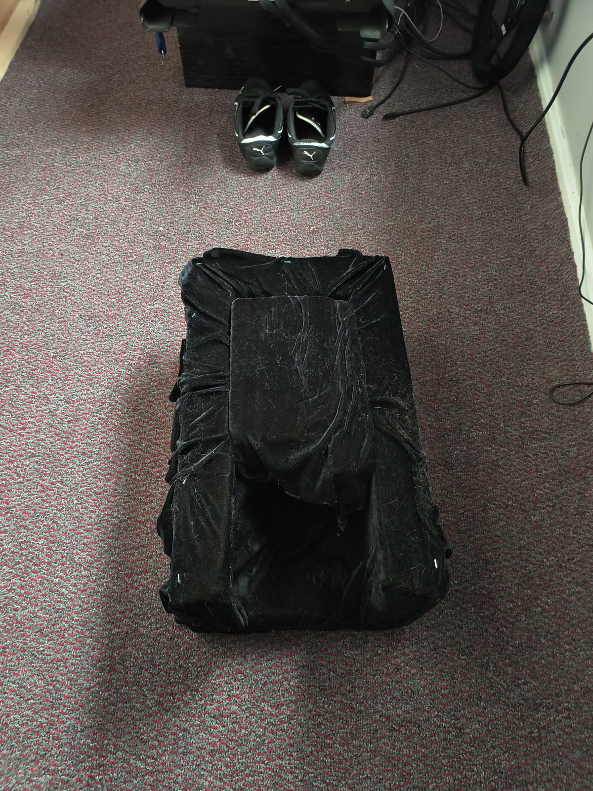

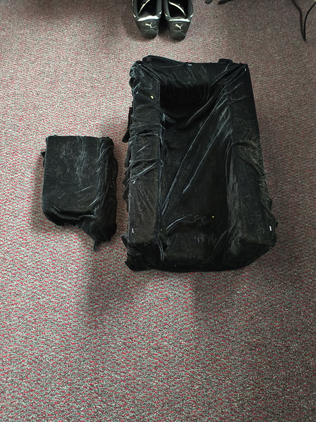

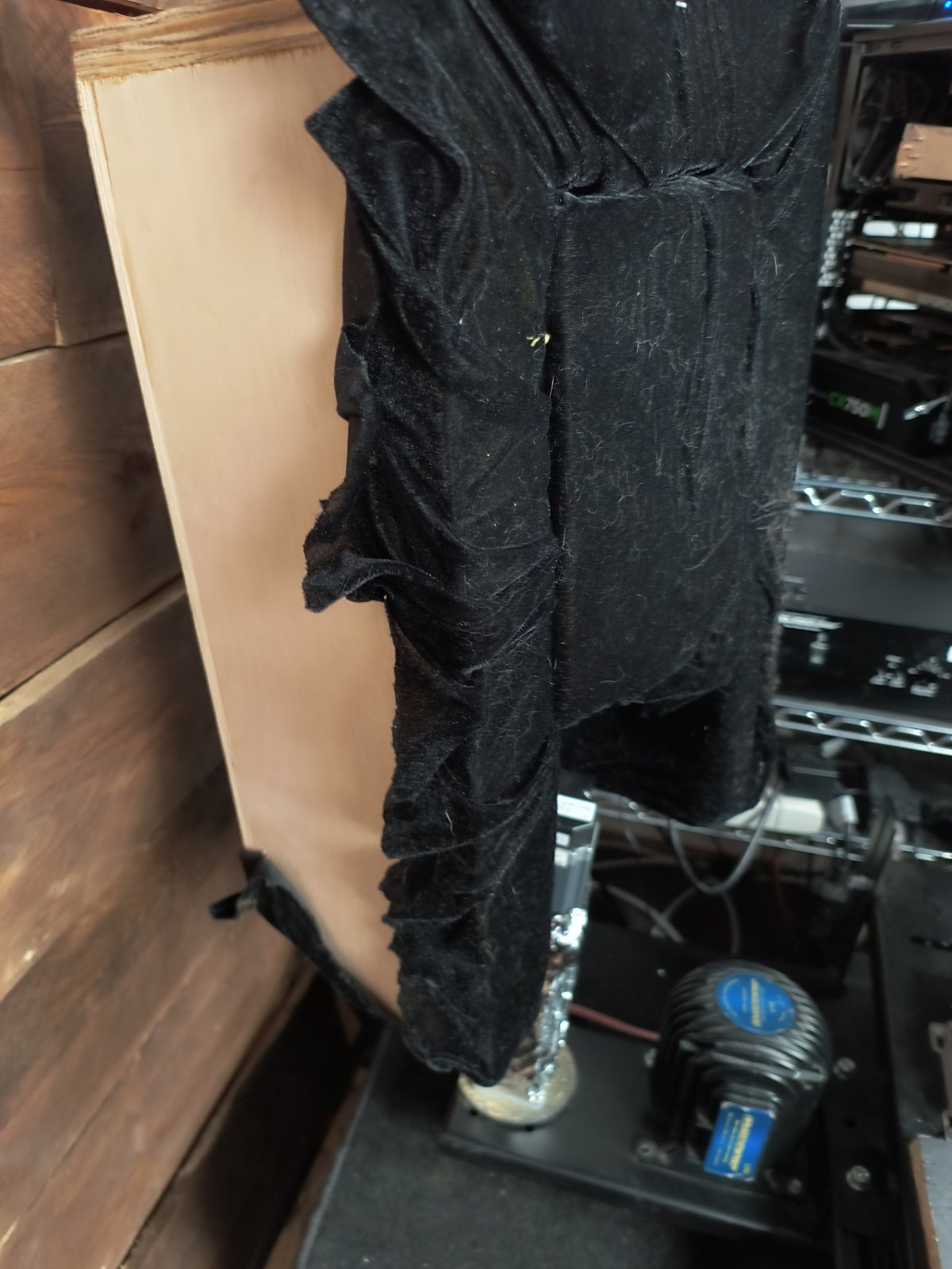

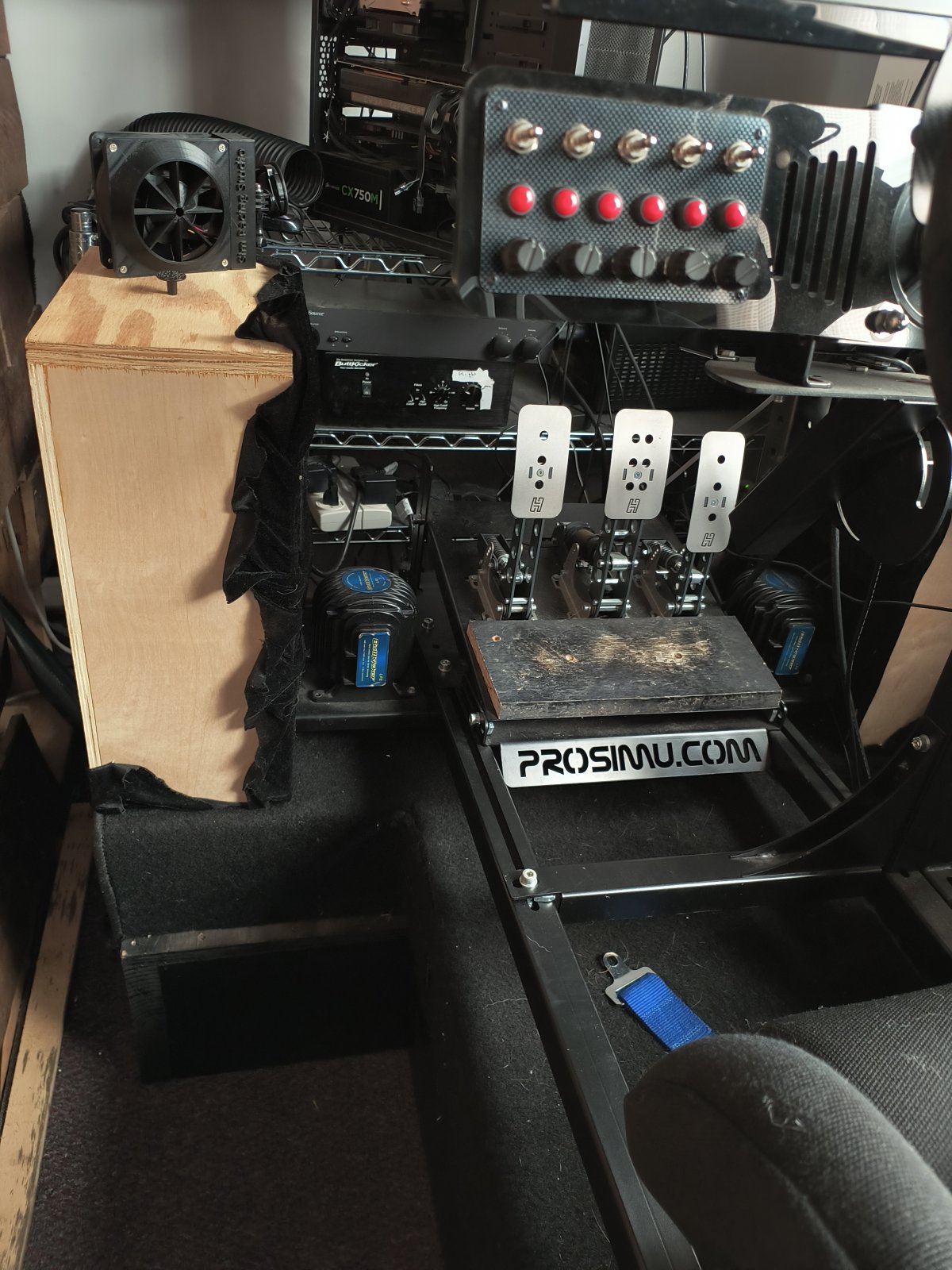

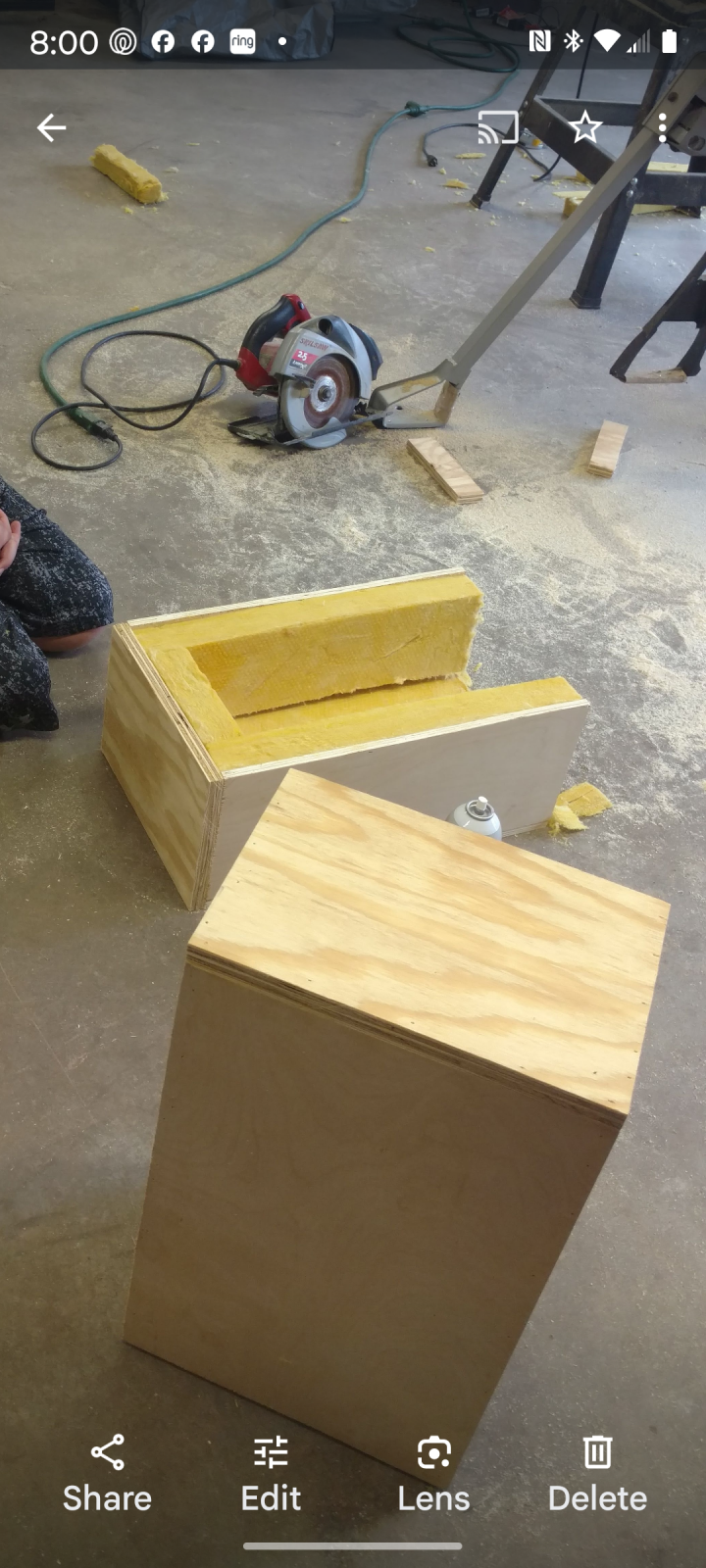

    2DOF, SCN6
    Prosimu 2 DOF. This is what I did, now be aware it isn't enough for me and I am determined to get them quiet. Wrapping them with sound deadener helped about 10% and these boxes helped about 20-30% I'd say. Tough part is you need to leave the inner part of box open a bit allowing for wing travel. Been running it like this since 2018......Still a WIP. Please don't mind the fabric, just something I was trying as my cat was actually chewing the insulation.
    Thinking about pulling one of the actuators apart to see if I can make them quieter from the source.
    Anyone out there figure out a way to get them real quiet?
