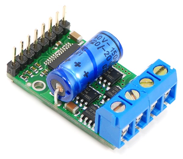

    it has been also tested fine with Pololu 755 single Hbridge driver boards = 40 $ per motor
    5.5 to 30 V voltage range and is efficient enough to deliver a continuous 15 A without a heat sink.
    http://www.pololu.com/catalog/product/755

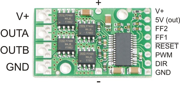

    Hey Mat, I have a question.
    When I connected my Pololu 755s to the Arduino, power, motors and pots the motors just spin at full power.
    Oddly, I found that if I manually move the pots back to center the motors act like the pots are controlling the speed and direction. The motors do not snap to the center of the pots (I assume they are supposed to right?).
    Is this something in the sketch? Shouldn't the arduino have them move to center and wait for input?
    I mounted my pots on slip tubes just in case the motors turned beyond their rotation limit, good idea that I did, lol.

    Excellent ! you succeeded ! :clap:
    you just have to reverse your motor wiring ;D
    once correctly wired, the behaviour is the following :
    First : pot are not mounted onto the motor
    you can see the expected behaviour in this video
    http://www.youtube.com/watch?v=oFnLDR2xGgg
    and please find the explanation of the code here :
    The code is written to put the simulator on middle position at start :
    /* init position value*/
    int DataValueL=512; //middle position
    - if your pot is fully turned to max, as Arduino reads potentiometer value as motor position, Arduino believes that motor is in max position.
    - but the order is to be in middle position
    - so the Arduino will ask the motor to go reverse in order to go to middle position
    - your motor is turning
    - but while your pot keeps still, the motor will turn non stop !
    - when you manually turn the pot backward to min, Arduino reads that motor is in min position
    - but the order is still middle position, so Arduino will tell the motor to go forward
    - motor runs non stop until the pot is in middle position
    In the code, you have a tolerance parameter : when the pot is around middle position (<middle+tolerance and >middle-tolerance), the motor stops.
    You can broader Tolerance value to stop your motor more easily manually.
    Second : now checked the wiring
    Once you have played in this manner, now checked the wiring
    simulate the pot mounted onto the motor (back to back or alongside with gears...)
    reduce the speed (pwmMax) to see the direction of motor rotation
    and check if Arduino will behave as expected when you turn the pot
    if your pot is mounted this way :
    when you turn in a direction, motor has to go the opposite way.
    If not, invert motor wiring or pot wiring.
    Warning ! if you have gears between pot and motor, you'll have to twist your mind :eek: to check the correct behaviour.
    Third : mount the pot onto the motor, the behaviour will be the following :
    - motor goes to middle position and stop
    - if you send order to Arduino via Serial Monitor (say R7FLAE) the left motor will move and stop at his new position ! right motor didn't move.
    - etc...
    et voilà !
