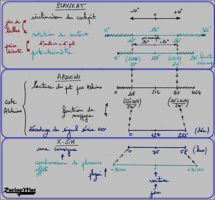

  4. RacingMat
    2,233
    21,082Coins
    hello David,
    yes, I can do this :yes:
    I'll insert a multiplier parameter (kind of gear ratio between motor and pot).
    Give me some hours and check tonight !
    I'll have to write the process for your tuning and translate this explanation :
    Mat

  6. RacingMat
    2,233
    21,082Coins
    @aarondc : thanks :cheers: your french is terrific ! champagne!
    @historiker : i've updated the code in first post.
    The process is the following : please, don't be too impatient ;D
    1- upload the new code
    2- calibrating the pot boundaries in the Arduino
    const int potMiniRorL=300;
    const int potMaxiRorL=700;
    these values are convenient as they will always constrain the values whatever comes from the simulator software,
    so the arduino will never send over-range value to the motors :) and your hardware will be protected !
    Now without any game running ! send orders from Arduino serial monitor :
    type the following strings in Hexa and press Enter:
    R7FL7F
    -> it should move the playseat in horizontal position
    increase the angulation
    R64L64
    go farther cautiously
    R3FL3F
    if the playseat moves too little, then the potMini and PotMaxi are too close to middle position
    and maybe go to max now : max backward tilt -> R01L01
    - if it's too litlle check how much you can go further and decrease potMiniRorL, reupload and resend R01L01
    and so on, until you found the pot minimal position
    - do the same for potMaxiRorL, send RFFLFF and increase potMaxiRorL, reupload and resend RFFLFF
    (write somewhere else these values that are associated to your particular playseat hardware).
    3- find your pot amplifying ratio
    - increase now the gearMotorRorLPotRatio (line 17)
    - by default, it's equal to 1
    - if you increase to 1,5 : the range will be increased by 50 %
    no worries, if the amplifying ratio is too high :
    - the playseat will not bump over the limits
    - but the mouvments will be fast or jittering
    Good tries !
    Mat

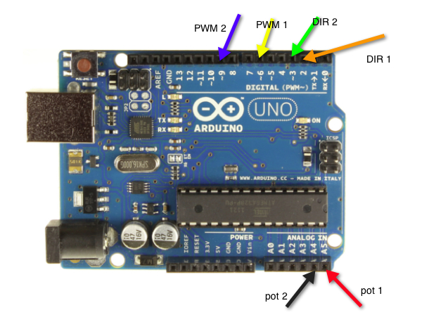

  8. trust928
    trust928 Member
    Sep 19, 2013
    152
    brazil
    435Coins
    +7 / 3 / -0
    i will try this code tomorrow I'm just confuse with some things
    ..like were goes the pots wires and the h-bridge wires in arduino..the correct ports..the images doesn't show very clear
    i read all the code but I'm not actually sure.. can some one help
  9. Historiker
    2,162
    9,205Coins
    +2,173 / 19 / -1
    The potentiometer wiper wires to to the Arduino ports A4 and A5 (if you are only using two motors).
    The positive and negative potentiometer wires go to their respective ports on the Arduino.
    Dir (motor 1) is Pin 2 on the Arduino, Dir (motor 2) is Pin 3 on the Arduino.
    PWM (motor 1) is Pin 6 on the Arduino, PWM (motor 2) is Pin 9 on the Arduino.
  10. trust928
    trust928 Member

  13. RacingMat
    2,233
    21,082Coins
    Hi Trust928!
    Nice to see your interest!
    Here is a wiring diagram http://gamoovernet.pixhotel.fr/pics_gamoovernet690px/20120703223559-lipide512-wiringdiagram.gif
    You can make your motors moving without any simulator software and without game:
    this is the first step I advise you to follow for your safety and hardware!
    start Arduino Serial Monitor and write manually orders to make the motors move...
    The Simulator software you need is Simtools developped by yobuddy and plugins developped by Value1
    As Simtools is not released yet, you have to ask for beta testing to RaceRay. Then you'll be granted to Simtools download page.
