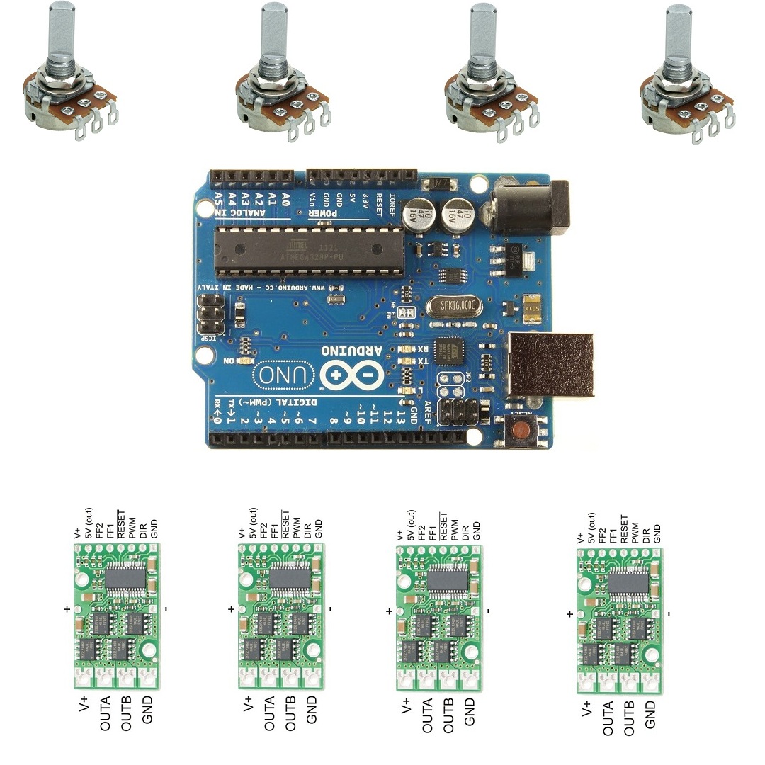

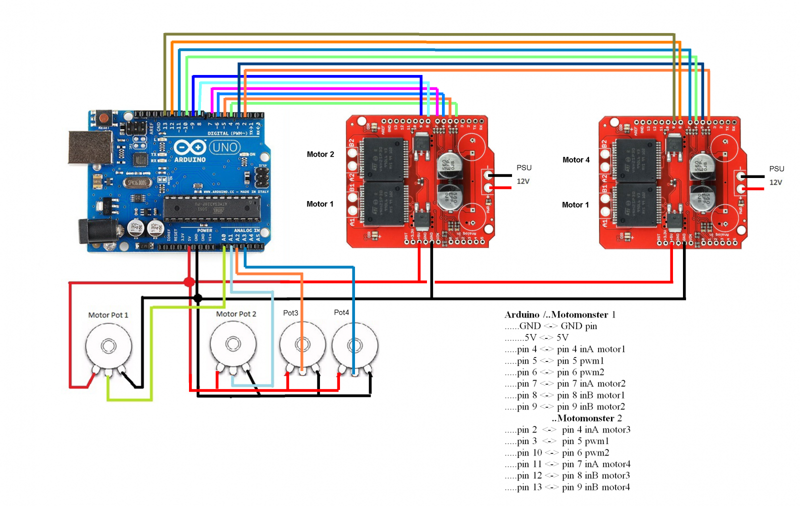

    qu'elle serait la configuration pour un 4 dof? (shéma plus bas)
    1 Arduino / 4 pololu 755?
    2 Arduino / 4 pololu 755?
    1 Arduino Mega / 4 pololu 755?
    Quelle serait le shéma de cablage?
    possible avec 2 monstermotoshield et 1 Arduino?
    Je vous remercie
    Je cherche, mais je tombe toujour sur des configuration 2dof tres peu d'informations: Sur des 4dof avec des shéma précis

    Hi!
    A 4DOF would require either
    - 1 arduino (UNO, nano or MEGA) and 2 motomonster
    or
    -1 arduino (UNO, nano or MEGA) and 4 pololu 755.​
    You have to connect all Ground (arduino, Hbridge boards and pot) together, all 5V together
    and each Dir and PWM to arduino...
    I would suggest you to try to sketch it as a educational purpose! and I'll check that after ;)
    It's much better to understand it by yourself!
    Have a look on Nath's post New Build motion Sim

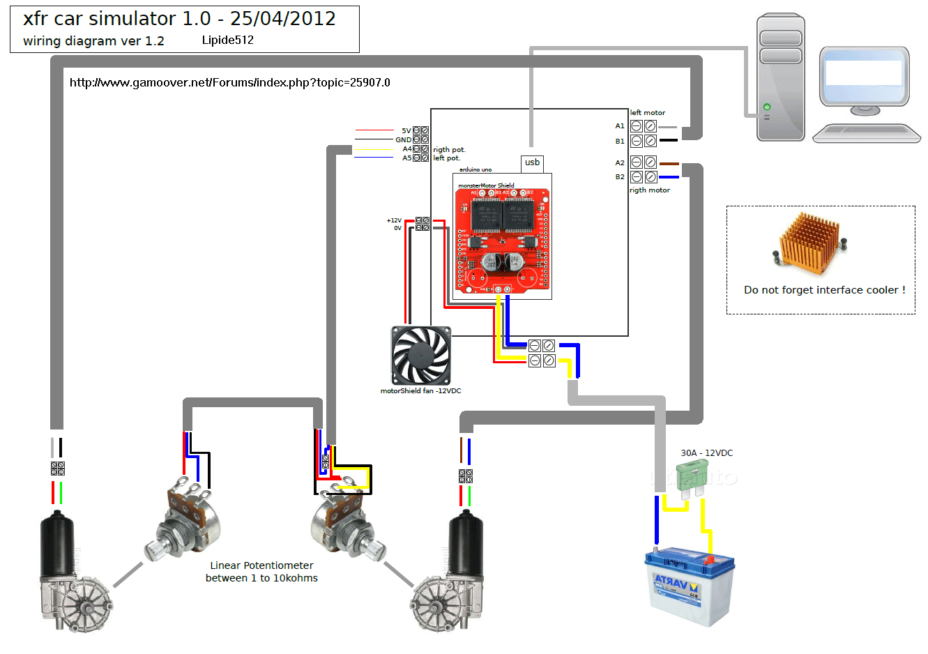

  12. RacingMat
    2,233
    21,066Coins
    +2,092 / 21 / -2
    yes, here it is:
