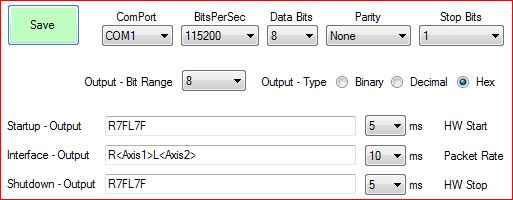

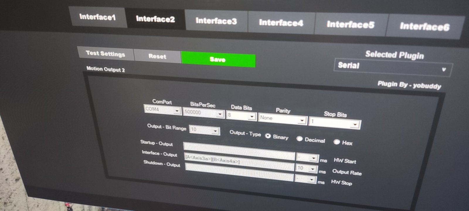

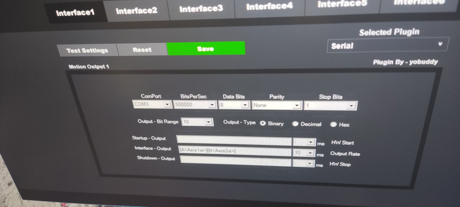

    I did exactly as in image 1 to nicolasp in page 6, but I don't know how to recognize 2 Arduinos at the same time in simtools, thanks.
    22,185
    154,750Coins
    +11,196 / 57 / -2

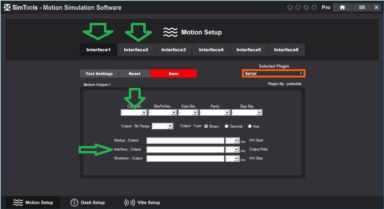

    I am not sure what version of SimTools you are using but the process is pretty much the same, please see page 33 of the manual:
    https://simtools.us/wp-content/uploads/2024/02/SimTools-v3.pdf
    Interface 1 is for the first two motors, with the correct port set, and designated
    Interface Output: <Axis1a><Axis2a>
    Use Interface 2 is for the the other two motors, again with the correct port set, and designated Interface Output: <Axis3a><Axis4a>
    The rest of the SMC3 settings for both interfaces are:
    Interface Type - Serial
    BitsPerSec - 500000
    Data Bits - 8
    Parity - None
    Stop Bit -1
    Output Bit Range - 10
    Output Type - Binary

    I just realised you are not using SMC3, so the settings are as follows, but ignore Startup and Shutdown, just leave those blank, but update Interface to the new SimTools format: R<Axis1a>L<Axis2a>

    IMG_20250920_201025.jpg IMG_20250920_201011.jpg I think I have solved my problem of motor which cuts out when I connect the potentiometer to the motor, you have to reverse the polarities of the motors.
    To make 2 Arduino work together I may also have found the right code in simtools 3, for now it works!
