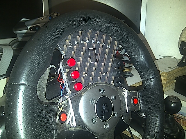

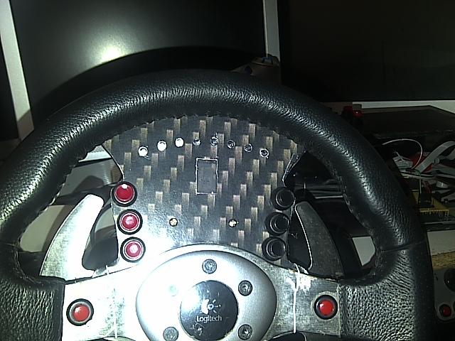

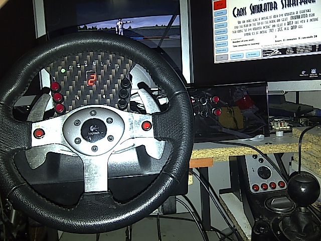

    Million thanks Robbie for all your help here are a few pics

    unreal mate good to see it now works and looks good. top job.
    Just one thing i need to know, was the base code and profile right.
    Thanks for Beta Testing it cheers mate

    Hey there, everything is working perfectly on my side so your beta is not beta anymore for me that is.
    The only thing I still need to figure out is to get the LEDs to flash at max RPM ie work like a shift light
    Next project is to get my LCD up and running so that it displays the following
    Lap time
    Sector times
    Position
    Fastest lap
    Some how I would want to have a button push to select which of the above I want at any given time
    1. Lap Time with sector Time on LCD during race
    2. Position and Fastest lap on LCD on a push of a button during race
    and button push to go back to first.
    Will keep you updated with progress.

    ok upate added releasing eXpanDash v1.
    RPM Guage finished and tested. All info in first post.
    Gear Indicator and Shift Lights to follow,
    3 Digit Speedo to follow.
