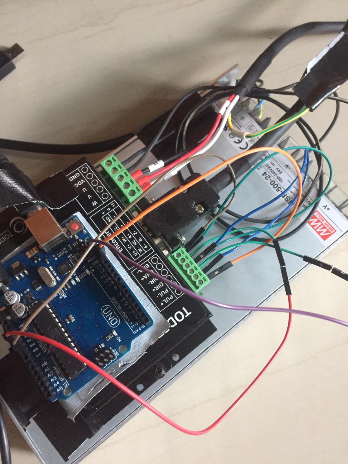

    how do i connect the arduino uno to an acs306 controller. ive been using the SCM3 sketch for the arduino and changed a couple of pins but still does not work.
    the acs306 controller also has a direct usb cable but the motors doesnt work even if the preset in simtools is SCN or Serial.
    i attached a picture of the wiring and the sketch used below.

    I don't believe anyone has used the acs306 before, so you are the trailblazer in terms of how to make it work.
    I would suggest you post the specs for the acs306, that way other members may be able to make suggestions.

    here are the motors and drivers im using. i bought it from china.

    Hmm, you are trying to interface to a closed loop stepper? Its not that hard, but the same time would be impossible to make it work with SCM3 (PWM)... it needs steps and direction signals. And a position buffer process. And a way to calibrate home position...
    Also these steppers are noisy! Reminds me of SCN5...
