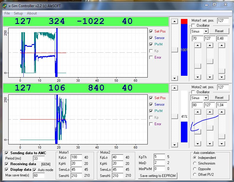

    im goona test it know just curiosity,, i have to upload any firmware? or firmware is the (sketch code?)
  8. trust928
    trust928 Member
    Sep 19, 2013
    152
    brazil
    435Coins
    +7 / 3 / -0

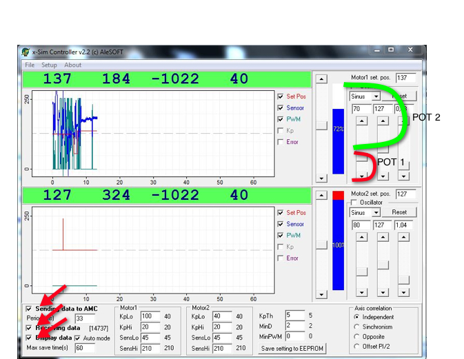

    I WILL BE FOLLOWING STEP BY STEP. here are the first step
    i have uploaded the hex 9600 ok..baud rate 9600 too and data bit 8 bits..
    arduino with pots... after start xsimctr,, i checked data receiving send receiving and display data
    so the arduino starts to blink... when i move pot 1 it moves a bit the slider when i move pot2 it move a lot as u can see in photo.. only the first slider shows signal the second don't move.. whtas may be wrong?
    i havent checked the pwm voltage yet i will fix it first as u said step by step loool
    and how to know when its working correct.... thanks
  9. prilad
    Apr 29, 2012
    380
    Dubna, Russia
    9,664Coins
    +513 / 1 / -0
    3DOF, DC motor, Arduino, 4DOF
    Ok, trust 928. First step is completed.
    About pots - check, please, connection diagram.
  10. trust928
    trust928 Member
    Sep 19, 2013
    152
    brazil
    435Coins
    +7 / 3 / -0

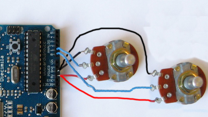

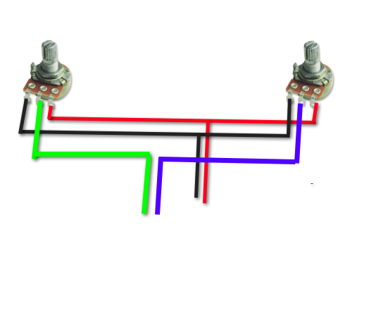

    hey prilad still no luck, look.. my pot 5v and gnd was inverted i fixed it but still the same
    if i change A0 and A1 the first slider stop.. and the second works,, i have tried all combinations
    I'm using arduino uno r3 in the picture below u see how my pots wiring
  11. prilad
    Apr 29, 2012
    380
    Dubna, Russia
    9,664Coins
    +513 / 1 / -0
    Looks too noisy. What power supply do you use? Only USB power? What length of pots wires? Can you make a test with short (as possible) wires? As you can see in my video - signals must be not so noisy
  12. trust928
    trust928 Member
    Sep 19, 2013
    152
    brazil
    435Coins
    +7 / 3 / -0
    I'm using only usb power.. the cables have i think 1 meter, i will test it now
  13. prilad
    Apr 29, 2012
    380
    Dubna, Russia
    9,664Coins
    +513 / 1 / -0
    If you use "long" wires - you should use "screened cable".
  14. trust928
    trust928 Member
    Sep 19, 2013
    152
    brazil
    435Coins
    +7 / 3 / -0
    well good news,, now its working as it should i think. each pot moves one slider....

  18. prilad
    Apr 29, 2012
    380
    Dubna, Russia
    9,664Coins
    +513 / 1 / -0
    trust928.
    Sorry I've been busy...

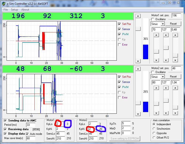

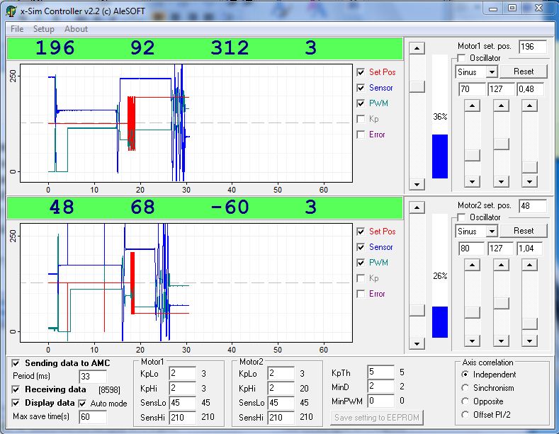

    But before we will go to next step I recommend you to change (reduce) coefficients KpLo and KpHi for both channels. In editing fields you should set KpLo to "2" and PRESS "ENTER" key on keyboar for sending new value to Arduino. ( if this operation was correct, you was see new values in the right of editing field)
    Edit all four parameters and then click "Save setting to EEPROM" button.
    After this your PWM signal will controlled more smoothly.
  19. trust928
    trust928 Member
    Sep 19, 2013
    152
    brazil
    435Coins
    +7 / 3 / -0

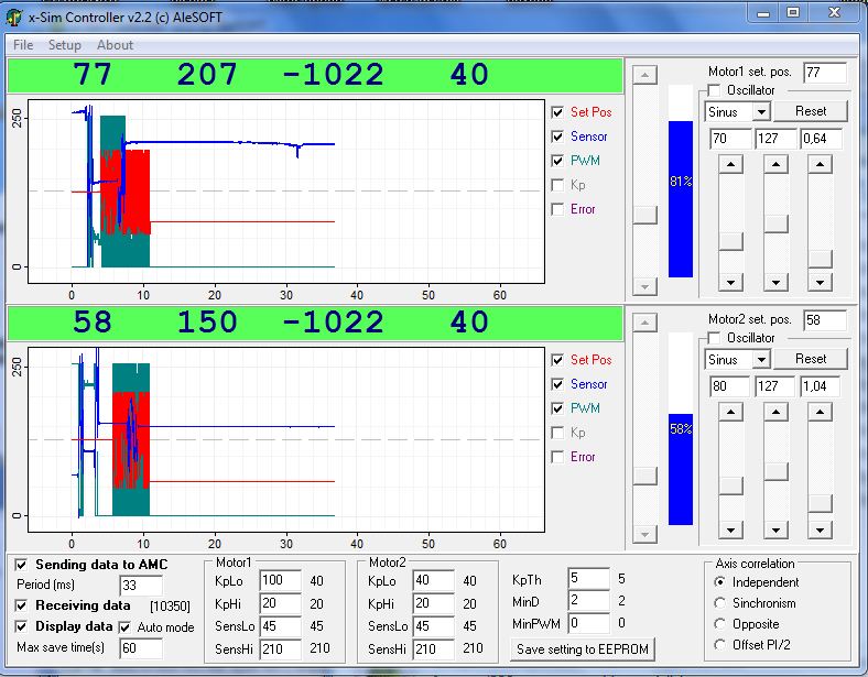

    ok it goes like this.. should i edit some thing else?
  20. prilad
    Apr 29, 2012
    380
    Dubna, Russia
    9,664Coins
    +513 / 1 / -0
    I see that KpLo/Hi set = 2 (marked by RED) but get from Arduino = 3 (or 20) (marked by BLUE)
    But this values should be equals...
    Be careful ;) Try again.
    And next you can change PWM signal by pots and check voltage on PWM pins (9,10) of arduino. Voltage should smoothly changed from 0 to 5 volts. On DIR pins (8 and 12) voltage should changed abruptly, when PWM signal changed sign.
