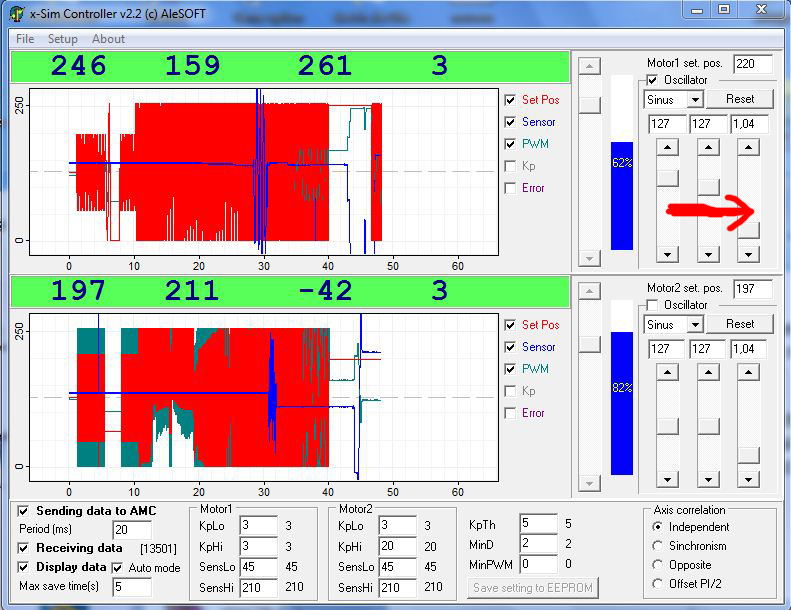

    Try to reduce "max save time" value to 1 or 5 or 10 sec. It will change the X-scale of both graphics. And you can to see data more detailed.
    You can turn ON "oscillator" and to change (reduce) its frequency (by right slider). You should see Sinus on PWM signal and you should check it on Arduino pins. I think - PWM must change from 0 to 5V

    okay.. i was joaking a bit with the sliders and I'm starting to comprehend how they works, now it gives me the 5 volts
    but the graphics still the same no sinus... the rest sims thats working correctly now i think is just to setup the software with correct parameters,,, that i don't understand haha..

    Use right slider for reduce oscillator frequency. And after changing "max save time" turn OFF and then turn ON "display data" checkbox for applying changes...

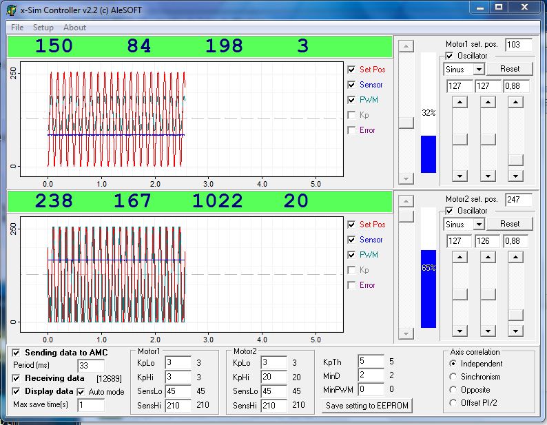

    well seems that now I've got sinus I've got better sinus it depends ,, if i move the right slider down the sinus stay more visible. and if i move it up the lines stay (together,) no sinus...
    so xsimctrl is just to calibrate the ard? now I'm understanding..

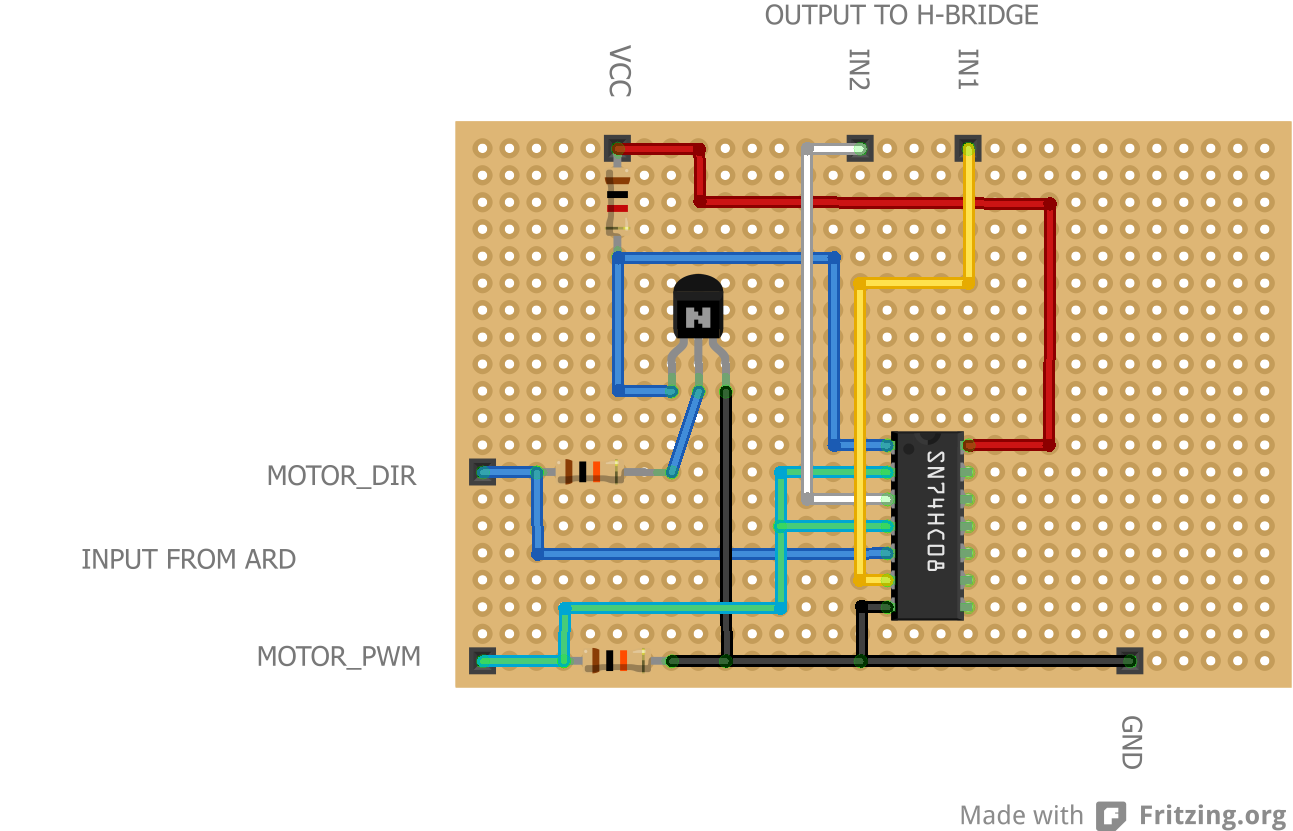

    arduino seems good.. h-bridge too... the problem now is the pcb
    ive double checked all the connections and soldering points its all right..
    but it gives continuously current on IN2 an IN1.. if i connect to h-bridge it will burn again,,
    even if i disconnect all wires from ard the pcb keeps still sending current...on both channels....its driving me crazy.. is this schematic picture really right?
    using 74ls08

    Wiring diagram is OK.
    You should check the voltage not between IN1 and IN2 pins, but on each pins relative GND. And you should see viltage ONLY on ONE pin when other must have 0V.
    For this case do not use "oscillator". Simple set pots in middle position and by hand move slider "motor set pos" (left slider) to upper position. In this case you should have PWM = 1023 and on pin IN1 (or IN2) voltage must be equal 5V (on enother pin = 0V).
    Next move slider "motor set pos" to bottom. PWM = -1024 and now check +5V on IN2 and 0V on IN1..
    Important - ONLY ONE PIN (IN1 or IN2) must have some voltage. Opposite pin must have 0V in this moment.

    hey mate good news..
    the pcb seems to work good
    the voltage drops in PIN1 and go up in PIN2/ and vice versa
    i never can get 0v don't matter what i change. it always stay nearly but never on 0v

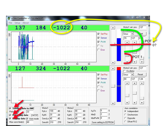

    I'm reading some stuffs about this configs.. i gonna be using only half of the pot, i was trying to calibrate the entire pot 270 of working area...maybe thats were the problem
    see the picture
    yellow,, value -1022 slider motor position in middle
    what should be the yellow value?
    if all up must be 1022 an at bottom -1022 so In middle must be 0?
    if i don't get the right value it send me signals in both wires..
    we are doing basically an read me manual loll

    Ok... A little manual for you.
    about Signals and Colors
    - Red line - Setting motor position. (SetPos) It sended to Arduino from PC by software (xSimCtrl or SimTools or other). xSimCtrl give you possibility to controll this signal manually or automaticaly (by Oscillator)
    - Blue line - Getting motor position (GetPos) (from potentiometer or other sensors). This sensor should be mechanically connected to the motor shaft. Important! Firmware set PWM signal for move motor to setting position. Easy formulas to calculate PWM is
    PWM = Kp * (SetPos - GetPos)
    - Green line - PWM signal, prodused by firmware.
    lets KpLo = KpHi = Kp...
    conclusion 1 - Do not set Kp to big (for beginig - not more 3-5)
    conclusion 2 - As long as there is no mechanical connection of a potentiometer to the motor shaft, not any calibration may be created, because the sensor does not track the position of the motor shaft.

    yeh it will help many others who are starting... and now i can say I'm getting the away how the software works.. i could get the 0v and set all almost correctly.. thank you very much...
