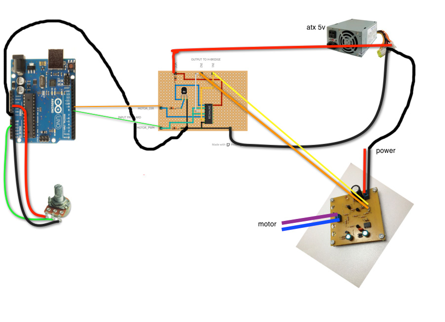

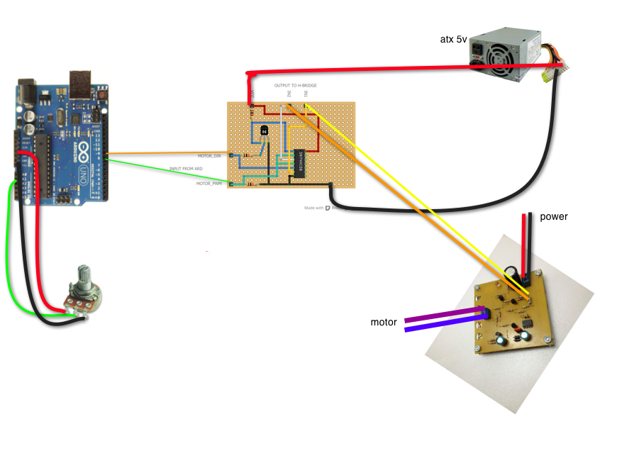

  4. trust928
    trust928 Member
    Sep 19, 2013
    152
    brazil
    435Coins
    +7 / 3 / -0
    this is my diagram
    i think its all correctly

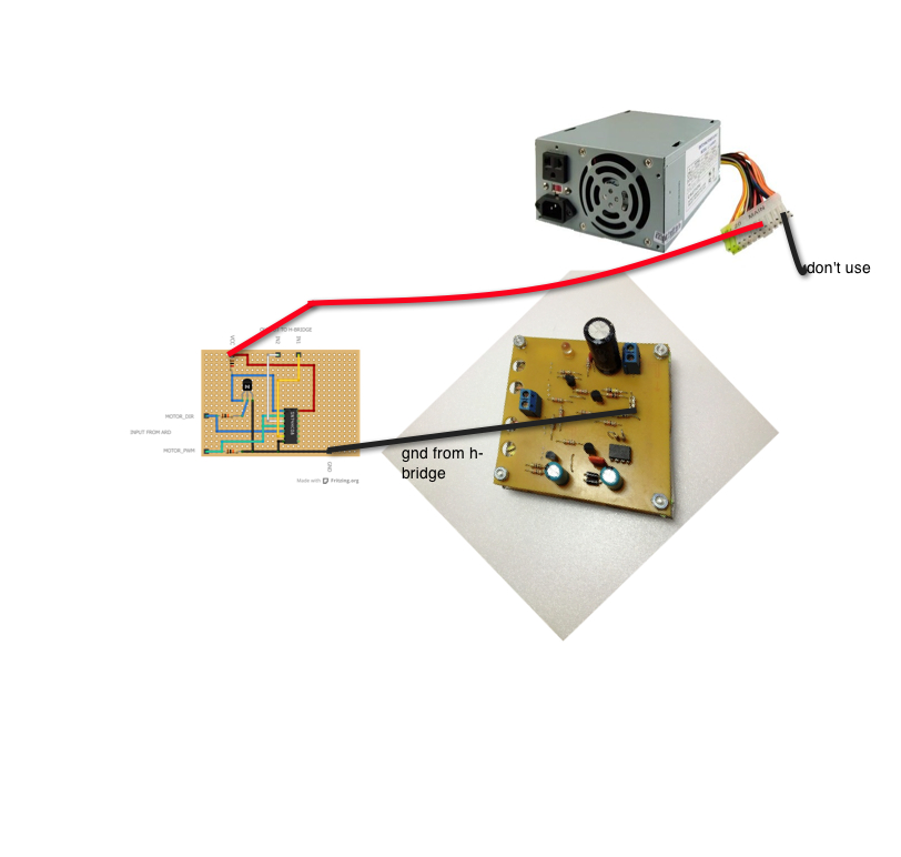

  9. trust928
    trust928 Member
    Sep 19, 2013
    152
    brazil
    435Coins
    +7 / 3 / -0
    so the correct way to power the pcb is as follow in the picture?
  10. prilad
    Apr 29, 2012
    380
    Dubna, Russia
    9,664Coins
    +513 / 1 / -0
    3DOF, DC motor, Arduino, 4DOF
    Oh, no-no-no.
    When you connect pcb to Arduino you SHOULD connect GND from Ard to GND pcb !!!
    When you connect H-bridge to pcb you SHOULD connect GND from pcb to GND H-Bridge !!!
    When ALL boars is connected you should make ONE common GND circuit.
    This is not very good, because the "power" of the power supply of the H-bridge is connected to the ground computer (throu the GND wire in USB cable). But otherwise nothing will not work. An alternative is special galvanic isolation between the Arduino and PCB
    ??? It should not be.. It's not correct.

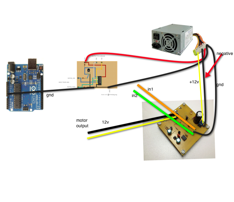

  12. trust928
    trust928 Member
    Sep 19, 2013
    152
    brazil
    435Coins
    +7 / 3 / -0
    and hows my diagram now?
  13. prilad
    Apr 29, 2012
    380
    Dubna, Russia
    9,664Coins
    +513 / 1 / -0
    I'm sorry, but I still do not understand what you have going on. too little information. You again in a hurry to work with the engine, and I ask you to make some tests wihout Arduino and H-bridge , about which I wrote above. You've got something does not work, but I do not understand - that's it.
    Please make all 5 tests and tell me about ALL results. Because
    is wrong... I can't understand this

  17. prilad
    Apr 29, 2012
    380
    Dubna, Russia
    9,664Coins
    +513 / 1 / -0
    Ok. Black wires from ATX is GND (marked as "COM" mean "common" wire)
    But what do you mean "GND ATX"? ATX case (housing)? You should not use this. Only black wire as power GND
  18. prilad
    Apr 29, 2012
    380
    Dubna, Russia
    9,664Coins
    +513 / 1 / -0
    And of course you have to measure all of the signals relative to GND pcb (not ATX-CASE)

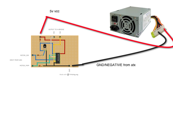

  19. trust928
    trust928 Member
    Sep 19, 2013
    152
    brazil
    435Coins
    +7 / 3 / -0
    when i say gnd/negative the are the same black wire, i think I've confused you....
    in the most part of the tests i lived they plugged to power the pcb as it is in picture,, take a look
