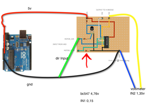

    Ok. I suggest you apply power to the PCB from the Arduino ... Not from ATX. Two wire (GND and +5V). Next connect Arduino to USB and repeat all 5 test (without H-Bridge)
  2. trust928
    trust928 Member
    Sep 19, 2013
    152
    brazil
    435Coins
    +7 / 3 / -0
    here it goes
    1) dir to gnd
    bc547 4,76
    in2 1,35
    in1 0,15
    2)dir to vcc
    bc547 0,3
    in2 0,15
    in1 1v
    3)
    dir and pwm on vcc
    in2 0,15 in1 4,20
    in1 0,15 in2 4,20
    in the picture u can see how i made the first test,, (dir to gnd) see if its correct
    and thank you for your patience loll we will get there :cheers

    Bad news. Transistor is OK, but 7408 is broken, IMHO. This could occur when it's powered without ground wire connection.
    Try to check output pins on opposite side (pins 8 and 11 of 7408). And check is the power good connect to pins 7 and 14

    Ok, Try to connect pins 9 or 10 to GND. Pin 8 should drive to 0V. After 12 or 13 to GND (pin 11 should drive to 0v). If it correct, you can try to use this "half" of 7408...

    mmm. 74ls08 works very simply. It has AND logic - OUTPUT PIN (3) drive to +5 v if both INPUT (1 and 2) pins sets to +5V
    In this case if PWM pin (it connects to pins 2 and 4 of 7408) connect to 0v all outputs pins (IN1 and IN2) should be = 0v...

    ??? Check voltage on all inputs pins of 7408. (1,2,4,5) All except one should be = 0v

    Wow... pins 2 and 4 has 1,1V ? You should decrease resistor from this pins to GND.
    Now it 10k ? Replace it with smaller resistor (about 1..3 kOhm) . And then check voltage on 2 and 4 pins

    i replaced with 1k resistor and it gives
    pin1 4,80 pin2 0,19
    pin4 0,19 pin5 0v
    what do you think

    looks better. And what now on IN1 and IN2 pins? If both pins has near 0 V - make all 5 test one more time...

    I think resistor 1K is good. Now you can connect DIR and PWM (and, of course, +5V and GND) to arduino and try to check values on IN1 and IN2 pins when you change signals from xSimCtrl... When PWM value in xSimCtrl goes to "positive" values - one of pins (IN2 or IN2) should increase voltage (and opposite pin should be = 0). And when PWM values goes to "negative" values - other pin should increase voltage...
