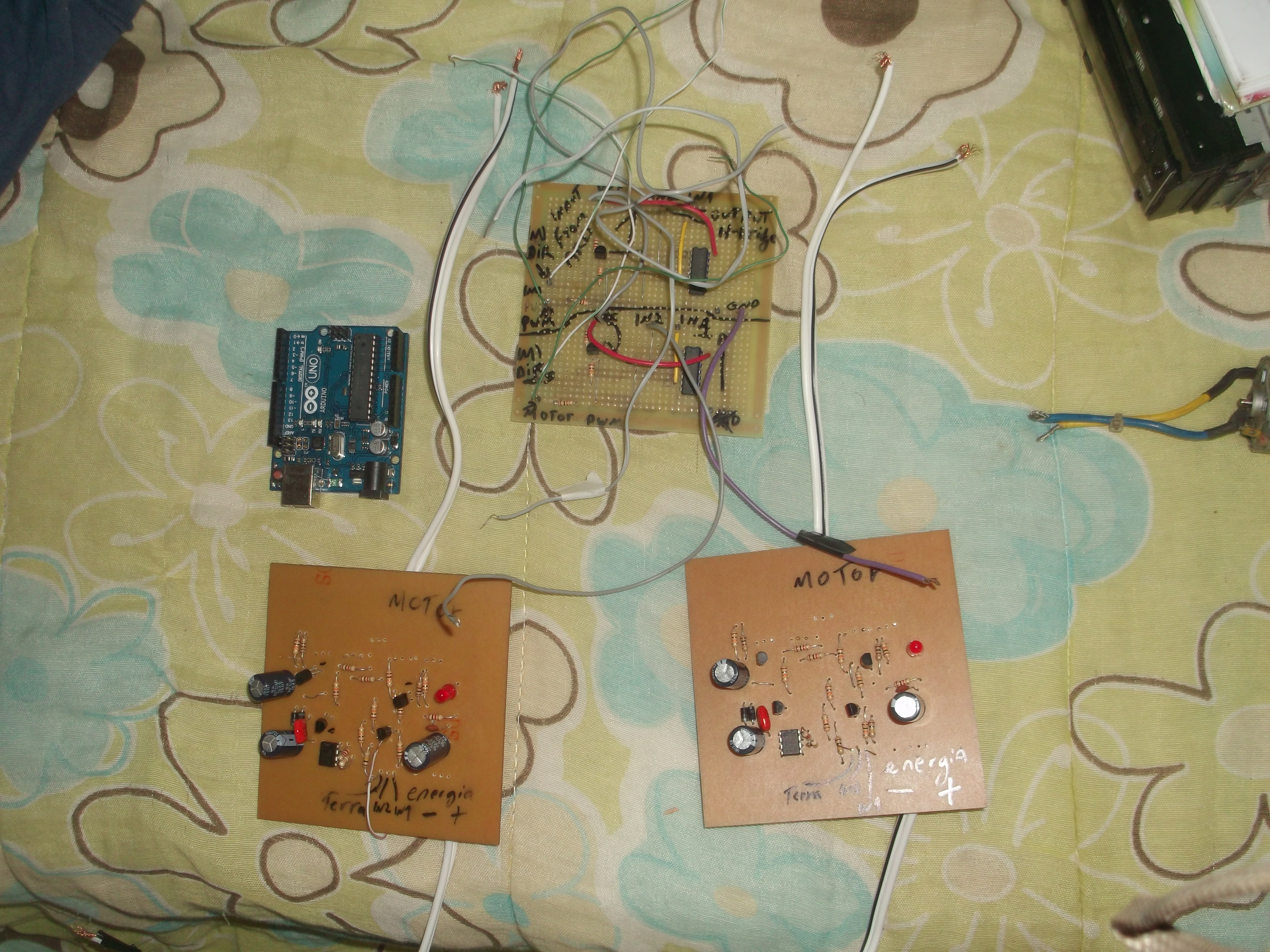

    hey prilad sorry to boder u again...im trying to pakage all the pcb into a box.. so far so good.. but i went to run a test to see if is all okay,, and ima having some simple problems i think its in the software
    1) the pcb arduino and h-bridges are all fines.. ive double checked all...
    when i move the slider up... im not having the right voltage on in1 and 1n2
    for example....... in1 up 4,00 and dowm 1v and IN2 dont change nothing.. all components are working perfectly
    it was a suprise for me.. lets see if we can solve this thanks

  7. prilad

  8. prilad
    Apr 29, 2012
    380
    Dubna, Russia
    9,664Coins
    +513 / 1 / -0
    3DOF, DC motor, Arduino, 4DOF
    You should not make tests without pots
  9. trust928
    trust928 Member
    Sep 19, 2013
    152
    brazil
    435Coins
    +7 / 3 / -0
    woww it was the pots.. now its all okay.. im gonna build a small box to put these things :thumbs

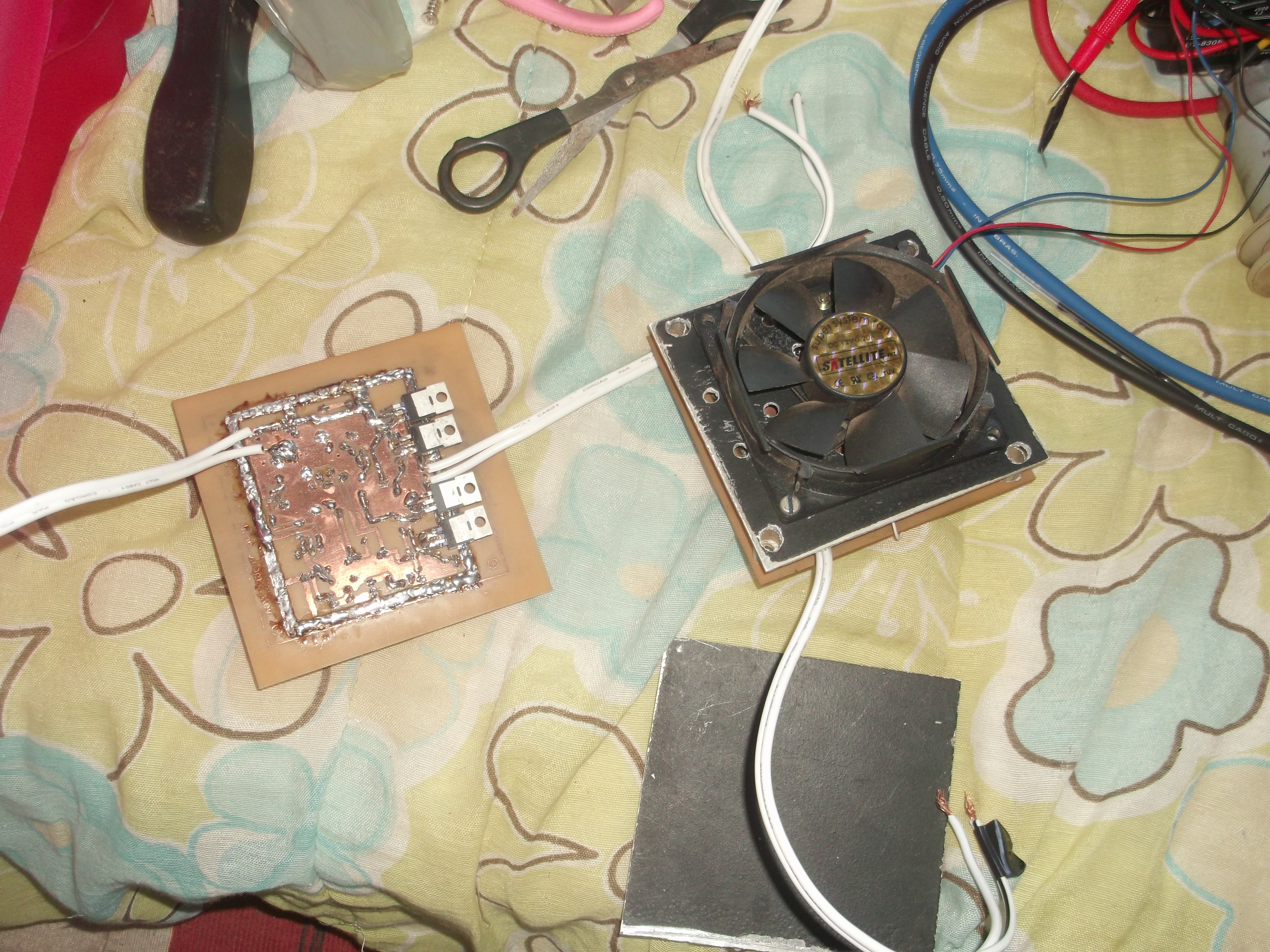

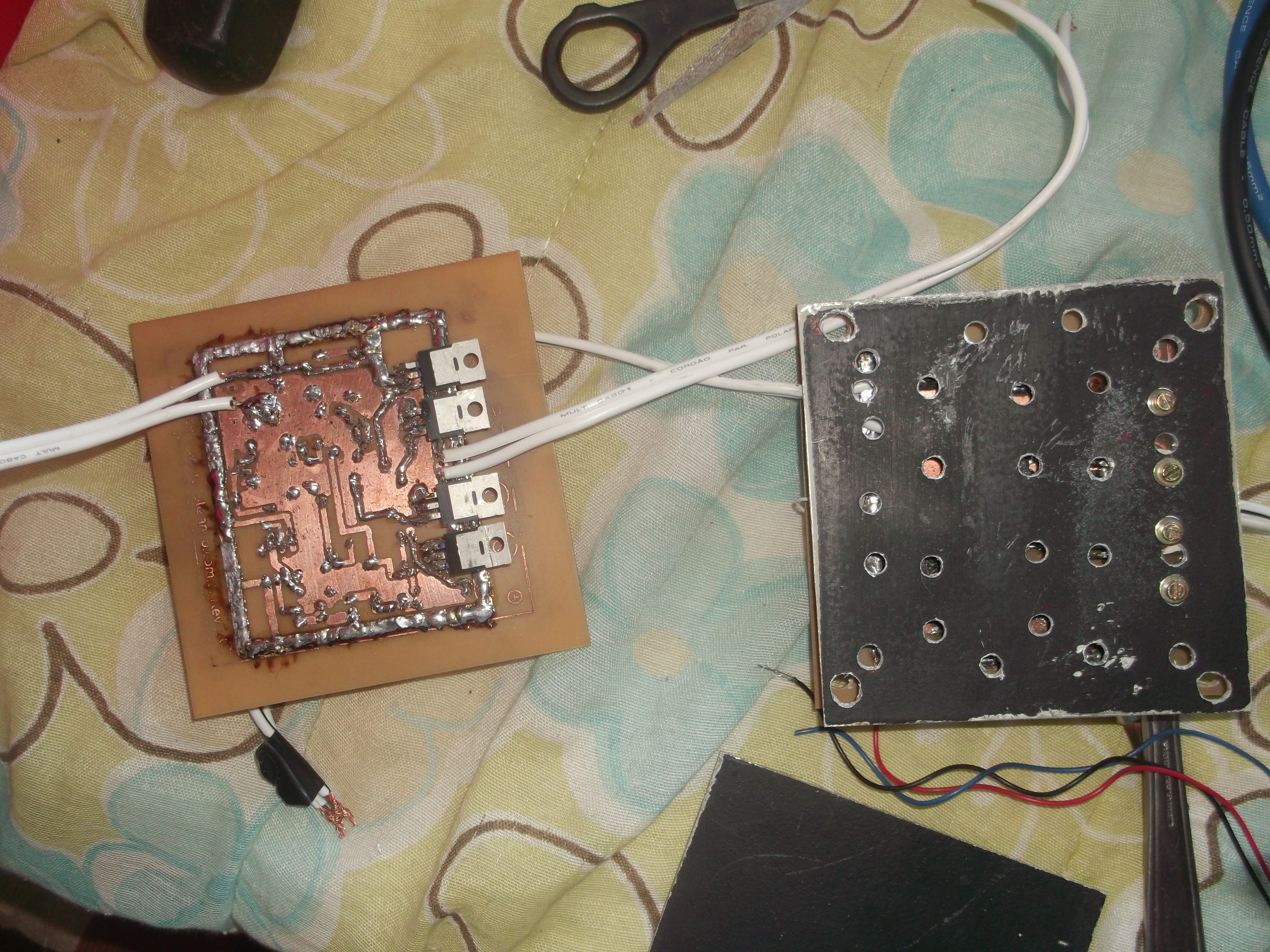

  11. trust928
    trust928 Member
    Sep 19, 2013
    152
    brazil
    435Coins
    +7 / 3 / -0
    ohh here it goes the boards are not connected in these pictures ... and the 2 h-bridges one done with fan and the other with nothing yet....

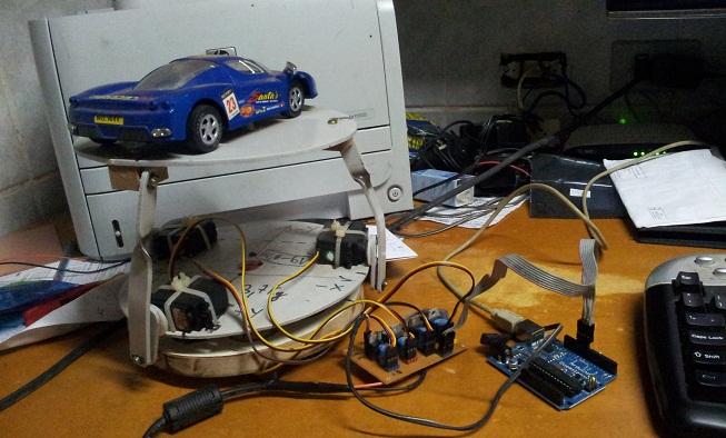

  13. taugu
    taugu New Member
    Aug 2, 2011
    - 58Coins
    Arduino, 4DOF
    do you think arduino uno can suport 4 motors or a have to use arduino mega sim.jpg
    from Brasil
  14. eaorobbie
    20,491Coins
    +1,687 / 23 / -2
    Uno can support 4 servos easily, plugged directly into the UNO , just needs a 5v power supply plugged into the UNO.

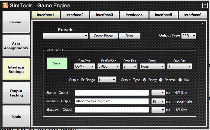

  15. doctorxeno
    doctorxeno Member
    Nov 10, 2013
    33
    607Coins
    +20 / 0 / -0
    What to fill in to use simctrl firmware with simtools at interface output?
  16. Historiker
    2,162
    9,214Coins
    +2,170 / 19 / -1
    AB<255><Axis1><Axis2>
