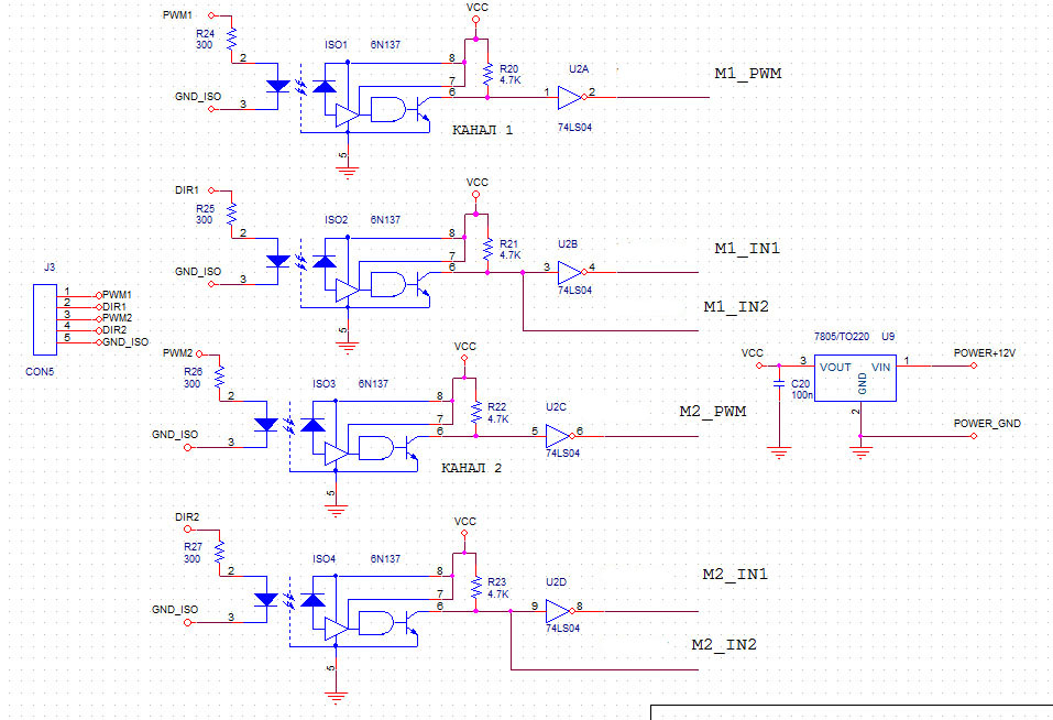

    hey guys, hey prilad, ive been out, due to lack of money lool, but im almot finishing my simulator but i found some problems that you guys may knows, arduino, pcb and hbridge all works good as it should... they share a commom ground arduino----pcb----hbridge all is one ground from arduino.. the thing is when i test with no load on motor all goes good but when its under load 2 of my screens turns off and the xsimctrl frezzes ,, seems that some thing is coming back and conflicting with computer.. when it happens my hbridge frezzes some fets... im not using galvanic isolator what can be?

    Hi, @trust928 ... I have spoken, I speak and I will speak - I strongly recommend to use galvanic isolation. The best way - opto isolator between Arduino and H-Bridge.

    i see you were right, i tought about it, but listen, theres a way to build an galvanic isolator? coz its very very expensive here, galvanic isolator is for the gnd wires? can u help me i miss only this.... soon i will post pics of the simulator

    Thanks prilad for the schematic.. but its a little confuse for me.. i dont understand very well the draw... its was gonna be easy if it was like the pcb one.... im trying to understand may i will need to send for some eletronic shop to build... if some one could make more easy to understand the schematic it wiil help many other thanks for all

    Hey prilad after look with atentio i see its very easyy to build, im gonna build it tomorrow i ve got some question,,
    1 this schematic connect in the ard out puts? Like ard -- isolator-- pcb--
    hbridge............. its goes like this the connection? And one more thing can i ignore m2-in2 and m1-in2???

    im having some problem in find, 6n137.. and here in my country is difficult to find galvanic isolators because of it im building one... i could find 6n135 can i use it? instead of 6n137? i bouth it.. im just waiting for the unswer of you guys to start soldering the wires lool:thumbs
