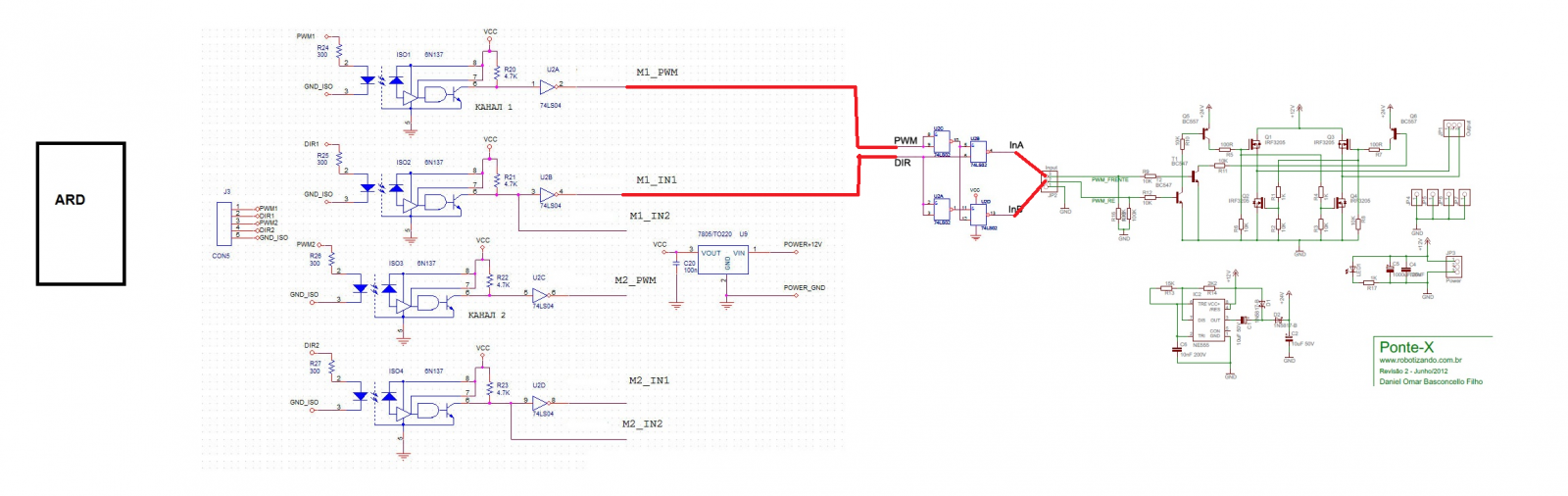

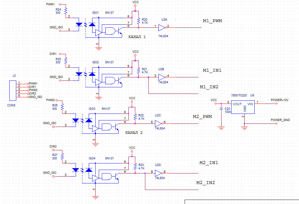

  6. hooshang
    hooshang Active Member
    Jul 6, 2011
    273
    275Coins
    +157 / 3 / -0
    @prilad
    hi friend,is there any simple DIY solution for isolation(opto.. or galvanic or any...)
    thank you

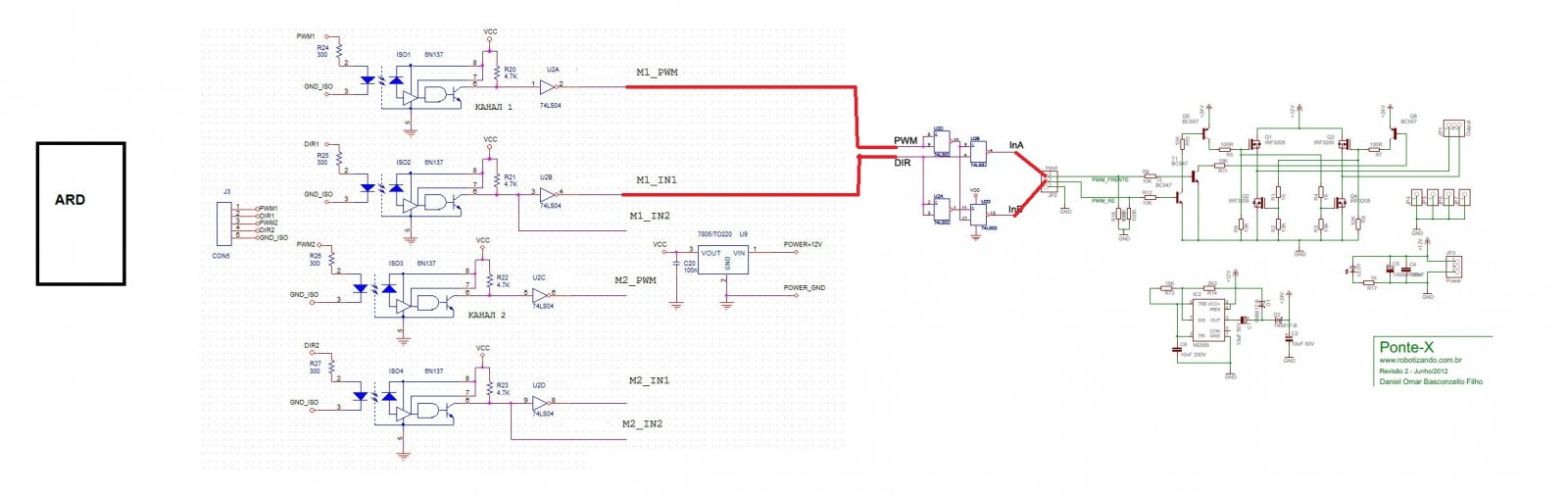

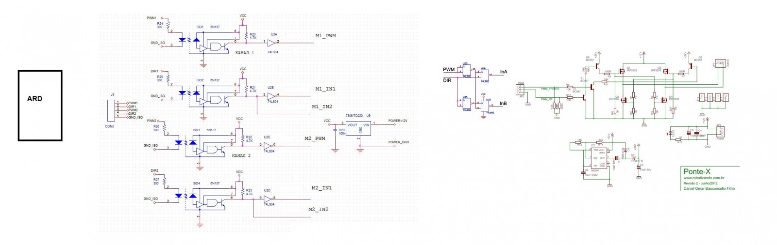

  9. prilad
    Apr 29, 2012
    380
    Dubna, Russia
    9,651Coins
    +513 / 1 / -0
    3DOF, DC motor, Arduino, 4DOF
    @Alexandre Kostik , try to delete file "xSimCtrl.ini" and then run program. It will help to setup COM-port...
    And about signal "sequence" - yes, you can use PWM and IN1 pins from optoisolator as PWM and DIR pins 74ls02

  13. Alexandre Kostik
    Alexandre Kostik Member
    Jul 2, 2014
    42
    realtor
    Brasil
    422Coins
    +18 / 1 / -0
    Ok @prilad !!!
    links would look like ?
  14. prilad
    Apr 29, 2012
    380
    Dubna, Russia
    9,651Coins
    +513 / 1 / -0
    I'll draw the right schematics tomorrow
