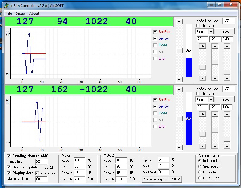

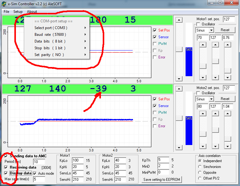

    3 - Start xSimCtrl.exe and setting up COM port. Pick checkboxes and try to receive data from Ard.

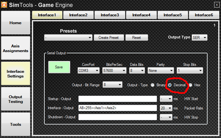

    4 - If all previous steps have passed, exit from xSimCtrl and reset Ard and start SimTools.
    5 - In SimTools you should set up interface like this.
    6 - let me know about results.

    i have done first 3 steps and all seems going to be smooth!?
    and then did steps 4 and 5 like this
    still no data:think

    Try, please, FW with 9600 and 57600... And do you use btn "SAVE" after setting interface parameters?

    i tried both 9600 & 57600,but no communication
    and yes i use SAVE btn after setting and let say
    i have done this setting succesfully several times with AMC 1.6

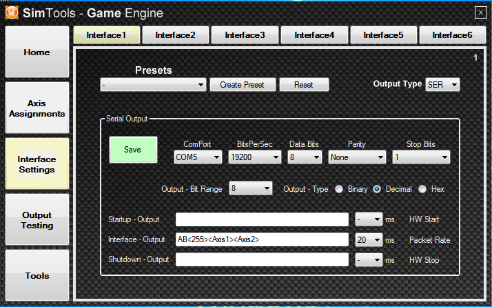

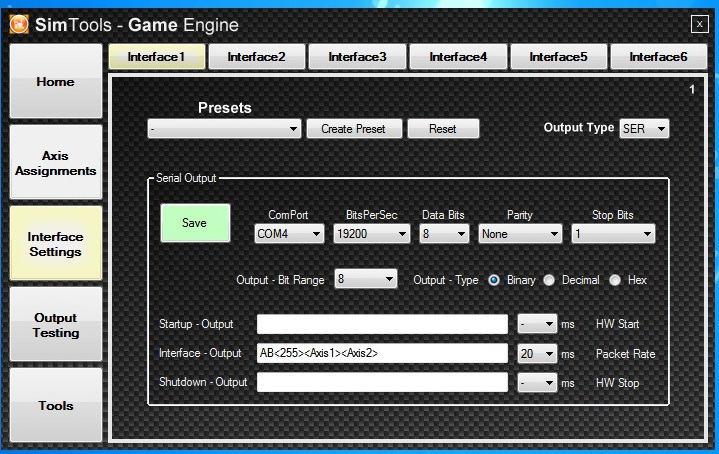

    It's very strange. Yes, I found problem in my firmware with SimTools compatibility. But new version works fine. Try with output type "binary".
    I'll try to create video later.

    In this video you can see Firmware (v3) worked with SimTools. I have not hardware yet, but I can controll PWM signal by oscilloscope.

    As you told me and I just did ,I could connect hardware with XsimCtrl2.2
    And simply transfer data but there was problem while connecting with
    Simtools, I think you are the one who knows how to deal with this bug and
    Wrap it up this for community...

    Yes, in previous software version I found ("with a little help from my friends" (c) The Beatles ;)) "bug"- incompatibility with SimTools. And I have fixed this bug. And I posted video with software worked with Arduino Duemilanove and SimTools (and LFS game). And I think it SHOULD BE WORK in your SIM.
    Please, check it again. You can find SimTools interface setting on my video.
    And I ask community - can anybody else test Ard firmware with SimTools?

    Now I post video with Arduino UNO test. There is no difference, both boards works fine with SimTools and firmware V3 (xsim_arduino_uno_v3_by_Ale_SimToolsCompatible)
