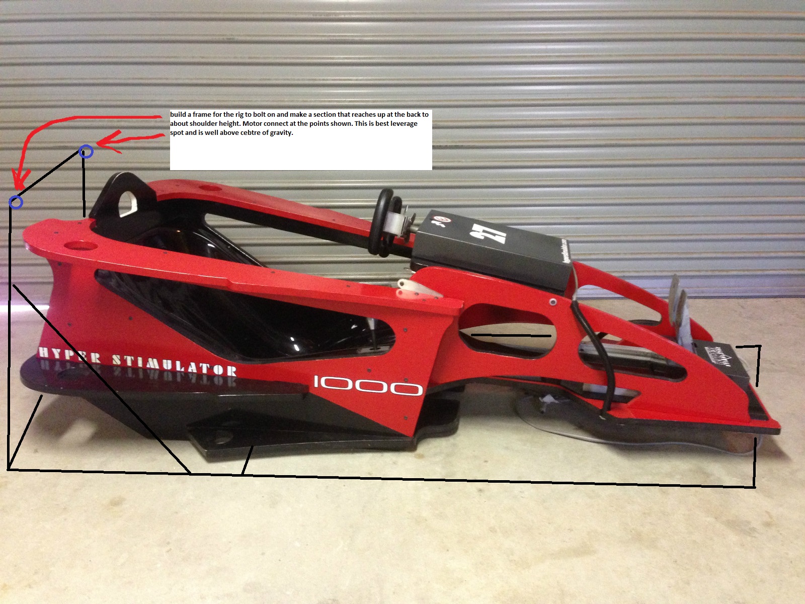

    Hello Igor and other members,
    I too am new to this motion simulators business. I am very interested in adding motion to a couple of Hyper stimulators I have happened apon which still need some assembly. I don't do much sim racing now but miss the years I spent racing karts and am looking for some way to renew my interest that doesn't require me to drag my gear to hot outland places in Southern California. I belive that for a sim to give you the real feel and trill of diving it must have motion. So here I am here hoping to find a way to acomplish this without spending thousands of dollars. I am an architect by trade but my hobie and first love is making furniture so building the rig and other attachements is no problem. I don't have much experience with programing or electronics but I still believe that if the knowlege is out there I can find a resonable solution. I appears to me that the cost of the base components will not be that prohibative its just about finding a source and learning the require expertise to put it together. I also don't have much experience with searching forums or sharing using this platform but I'm willing to give this a try.
    Oh and my freinds call me Chuck and the former Croation spelling of my sir name was Marovich, by the way my gradfather married a Surb he met here in the US back before the split. So I guess I'm ready to take this journey.
    So now a technical question why did you decide to use 2DOF with viper motors?
  18. Historiker
    2,162
    9,214Coins
    +2,170 / 19 / -1
    Welcome Chuck, good to see you here.
    There are lots of examples here of everything from seat movers to full motion sims.
    As to Igor's post, that was back in 2009 ;) He meant "Wiper motors" not "Viper Motors". Wiper motors are car windshield wiper motors. Good for simple seat movers but not enough "umph" for full motion sims.
    My 2DoF platform uses 12v winch motors to move me, the controls and monitor, etc. Noisy but fun. Others are using bigger worm gear motors at both 12v and 24v. Some are using hydraulics, others pneumatics, etc. Lots and lots of choices.
    Electronics include controllers like Arduino (I use that), SimAxe (Picaxe), Kangaroo, Pololu JrK, etc. Again, lots of choices.
    Just take a look through the forums and see what looks good to you and then start planning. Everyone here will help you, just ask. ;)
    Simtools will be released soon, it is a great tool for motion platform. Many of use have been beta testing it and it is a great piece of software.
    Again, welcome to XSimulator.net.
  19. bsft
    I have attached a pic of a suggestion for making a frame underneath, then sitting this on a pivot with motors at rear.
    Best use 12v boat winch motors for that.
    I use 12v big worm gear motors and JRKS, but the frame is lighter.
