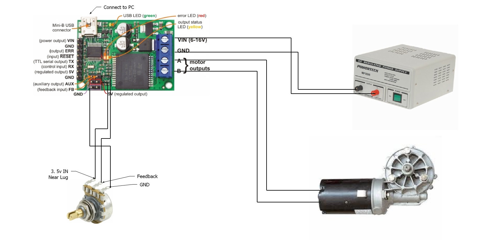

    My name is Kalab. I live in the state of Wyoming. I am interested in building a PVC style "joyrider" primarily for motion simulation with flight simulator x. I have done several full days worth of research on the subject (dont tell my boss please :blush) and I am still very confused. I would be plenty happy with just the standard 2 degrees of motion roll and pitch, but I would really like to add a yaw platform under the unit for a 3rd. In any case I am sure that a lot of folks have taken that same PVC design and motorized it, so rather than travel a lonely road, are there any guides, tutorials, or for dummys presentations on the subject? Particulary for the electronics and recomendations on motors and sources. I will openly admit at this point that I am cheap and will take shortcuts where I can to save some coin, but at the same time I dont want to be dissapointed in performance so I want to find the tolerable trade off. I exhausted the search function and found very little that made much sense to me. Thanks to all, and especially thanks for such an awesome website!
  6. eaorobbie
    20,506Coins
    +1,687 / 23 / -2
    I would use Jrks for simplicity and speed, but the Ard will do it just not as nice for motion.
    Sent you a pm with a link of some old tut that got removed by its owner, should help you complete a the project.

    12v 200 watt big worm gear motors and JRKS for sure.
    As for the rest, can be done.

    Hi @Dreamon and welcome to the forum!
    The jrks are really easy to set-up: three wires to connect the potentiometer, an USB cable to connect to the PC (and SimTools), 2 wires for 12 VIN and 12 VOUT. There is a lot of documentation in the forum here about how to set them up.
    You can buy them here: http://www.pololu.com/product/1393. 1 jrk for each motor/axis.
    For the motors you either take two 1'000kg winches or motors similar to these.

    @JBoogie Perhaps older; I am 32 yrs old. I also have the plans from acesim.com, they are very good. I am hesitating to start building becuase I want to make sure I have room from the chain cogs I am going to use to rotate on pivot points aswell as the position sensors.
    What can I use for potentiometers or position sensors with JRKs? I need 90 degrees for this type of build? Has anyone ever tried to use the steering wheel controller? In my case it will be a saitek brand flight yoke but it should have some sort of potentiometer type device already onboard. I also consider what ever I purchase being mounted to the yoke rather than at the pivot points. Is that a good idea or bad?
  20. eaorobbie
    20,506Coins
    +1,687 / 23 / -2
    @Kalab with the Jrk , you can set the max and min position easily in the Jrk software but in turn best practice is to use as much travel as possible.
    Using rc gears can help this if using 90 deg you need a 4:1 ratio for full pot travel, but because most single turn pots are 270 deg you will get a little less. This also can be done with a couple of wood pulleys you can make and a belt.
    Bad idea as you want the pot to feedback the position of the frame to the jrk so it knows how to act when a new target appears.
    Welcome @JBoogie , I too have a joyrider but no motion on it yet stuck playing with racing sims, must get back to flight.
    The Jrk offers a good solution for controlling 12v motor up to 30amp, with a heatsink and cooling, its a H bridge and micro controller in one and has been tested intensely , I have been personally building with them since 2009, now because of ease of wiring and ease of setting the driver up with the software Pololu provides they can be a good choice for a beginner, they are of quality , you get what ya pay for.
