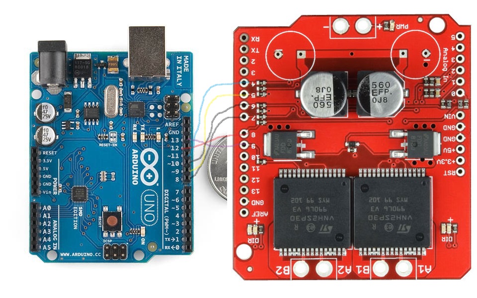

    AH it does just needs to wired correctly and not plugged onto as the shield was intended, he uses a different pin out. Was the first driver I tested on it. Unless something has changed since I tested it, I do try and test them all, still nothing has come up to match the Jrk yet.
  2. Historiker
    2,162
    9,205Coins
    +2,173 / 19 / -1
    As Rob mentioned; you just have to wire it correctly.
    Here is a diagram provided to me by Merchan-e who also uses Priliad's code:
    ARDUINO----------MONSTER
    M1PWM-----------PWM1
    M1DIR1------------INA1
    M1DIR2------------INB1
    M2PWM-----------PWM2
    M2DIR1------------INA2
    M2DIR2-----------INB2
    Arduino---------Motomonster
    Motor 1
    pin 8 ------------D7 Dir1
    " 12------------D8 Dri2
    " 9-------------D5 Pwm
    Motor 2
    Pin 11------------D4 Dir1
    " 13------------D9 Dir2
    " 10------------D6 Pwm

    Thank you to both of you for setting me straight. I'll give it another go tonight, hopefully I will have motion.

    Thank you, that's a huge help.
    Just one more question..
    Does the Moto monster shield need to get 5v and gnd from the Arduino also?

    @DDU : Yes, just connect the +5v and ground from the Arduino to the Monster Moto. Don't forget to connect your potentiometers to the Arduino ;)

    Got it all hooked up tonight on the bench and it works well. It was so easy, I almost feel guilty. But it was only easy because of the wiring help I got from you guys and especially Priliad's hard work in writing the code. So a big thank you to all :thumbs
