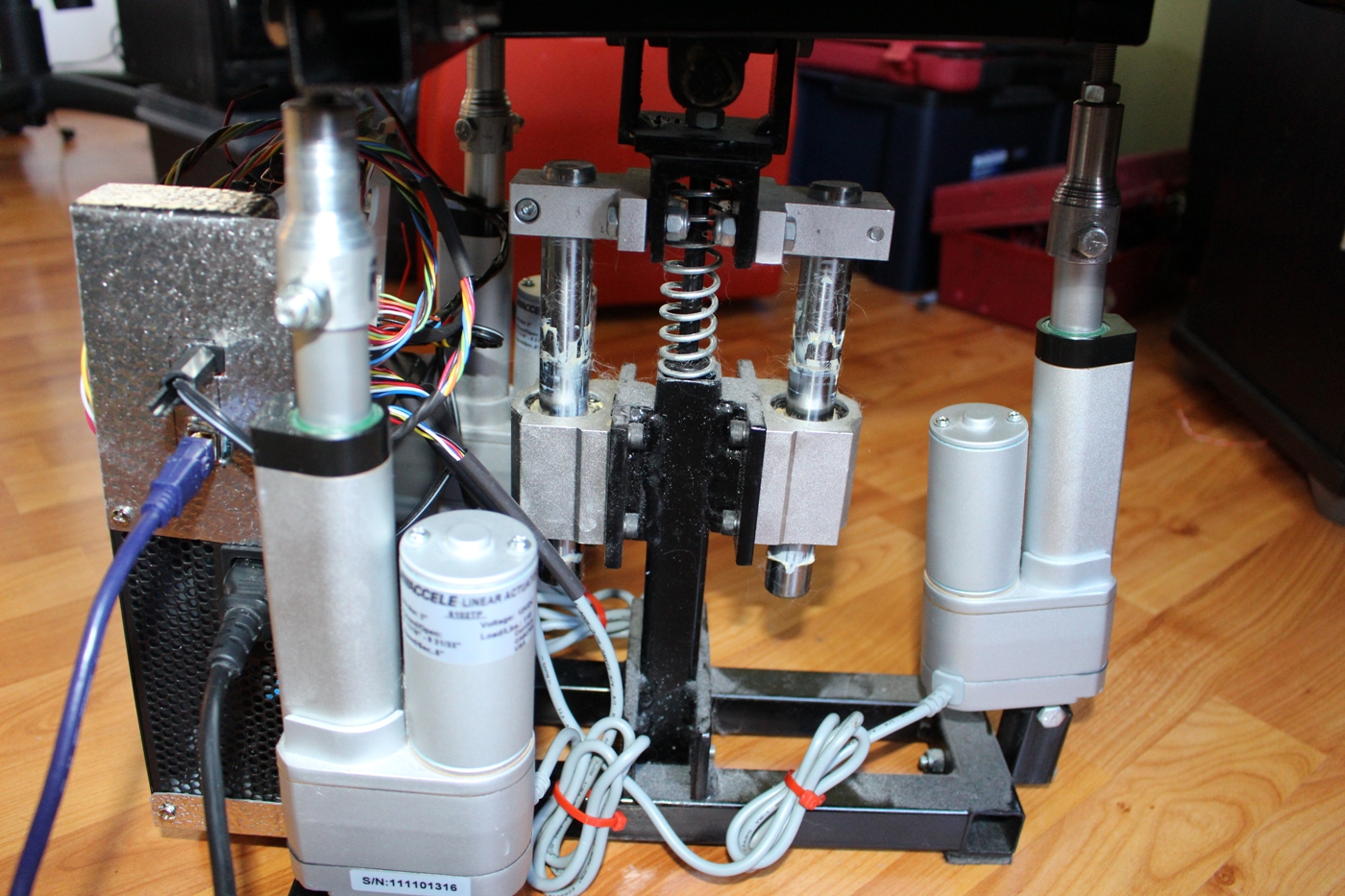

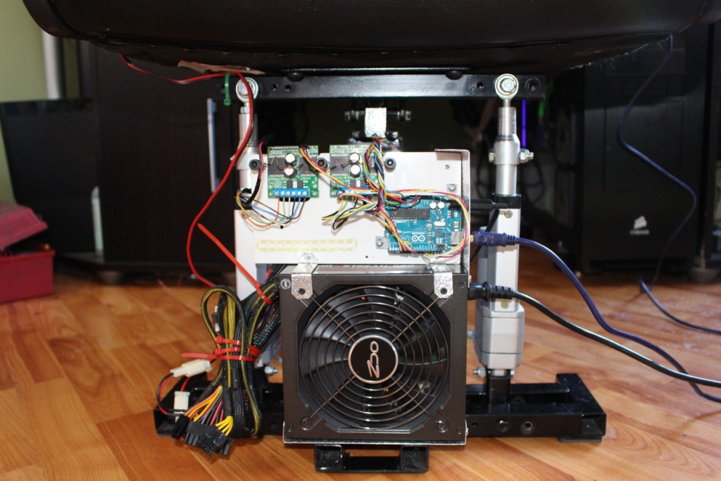

    Hi Sim community,

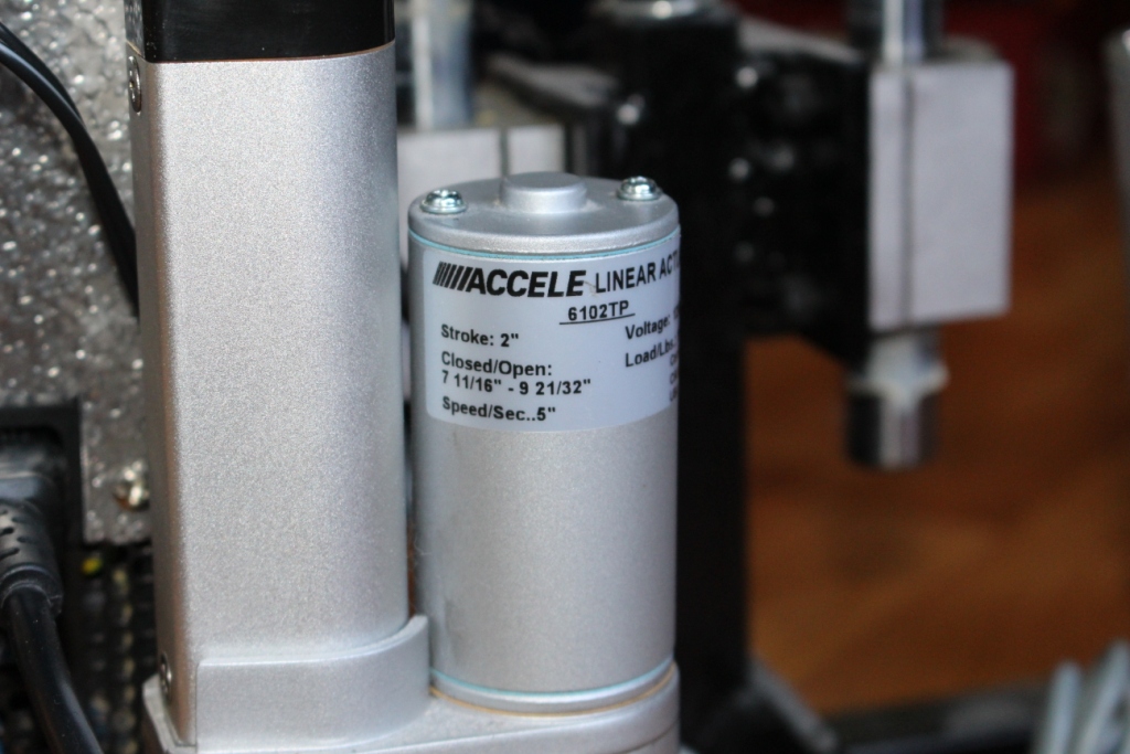

    I've been following Tanos since a long time now and was working on a simple 3 DOF sim. Now it is almost completed but it is not a sim that will take your pants off. Since i do not have lots of place, i had to do something small so i decided to modify an office chair as a simultator. It is a 3 DOF sim though but quite slow compared to the sims with the SNC5. But as you know, it is not easy to do a 3DOF with Heave movements. The actuators are only .5 inch a sec but you still get a feeling for the type of sim. The steering Wheel needs to get off most of the time since this is the family computer therefor it is set on the desk. This gives a sensation that you get further from the steering Wheel in accélérations. Have some more work to cover the base of the sim with an ABS sheet to cut some noise from the motors and hide the mechanisim.
    I've posted the 3 DOF Arduino code that i modified from the 2 DOF. It may not be perfect since the chair gets wild some times when the i move the slider at the maximum of the line in the Output test bench of Simtools. Also cant get the actuators to move slowly it is kinda jerky.
    Well That it folks, hope i did not took too much space on the Forum.

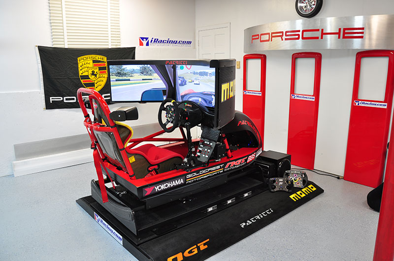

    Hello my name is patrick . and i love sim racing . i work every day on real race car . my company manufacture composite parts of porsche race car . i build the last couple year my on racing rig . started with Frex motion . seat mover . then modified it to run on simexperience . like CXC seat mover . then when to the next level . and built my self a simcraft
    where the entire rig move . then build my own . run with simcraft and simexperience software .
    here a link of my prorsche GT3 MOMO racing simulator on vimeo .
    next i want to build a 6 dof F1 simulator . so i hope i can use simtools . but i have no knowledge of programming

    I will have to drag @eaorobbie into this as he has some figures. I know with big motors at 16 amps they are 20 nm torque at the gearbox shaft, real world figures, but as we overdrive them, more like 30-40nm torque. They are faster in linear speed, about 500 mm per second. And thats under load of 10 kg, I think

    Look at 0:46, i have put the streering Wheel and pedals. The first 46 sec. are with the mice. You can see the mechanism at work at 1 min.

    @darkmold9 , well done, a desk racer chair.
    Thats my next planned build. But a 2DOF
    Do you have any more specs on your build?

    @darkmold9 : very smart and compact setup! Congratulations!!
    Please open a dedicated post: i'm sure many simers would like to get some advices from you!
