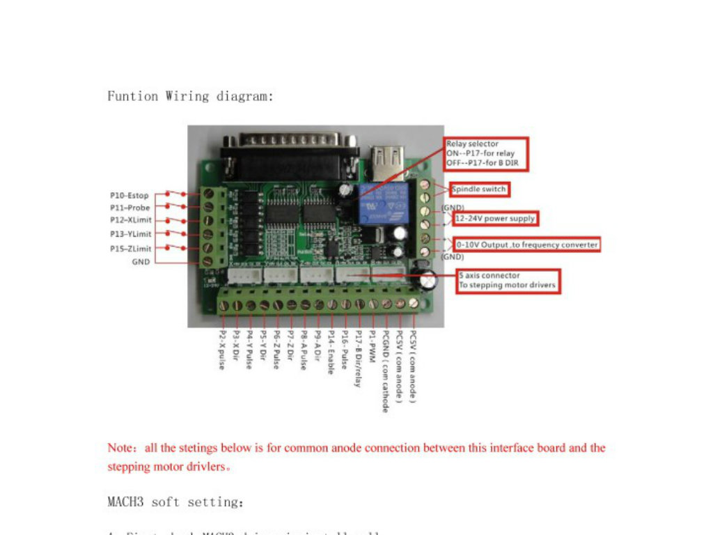

    @RacingMat
    I am completely new to this so I'm not sure what drivers are good. I have a mach3 cnc interface board that my teacher had lying around, and as for the motors my teacher's getting; he's waiting on me to get information about what would be good to use. So if you know of what would be good but still not super expensive I'm all ears.
    this is it here
