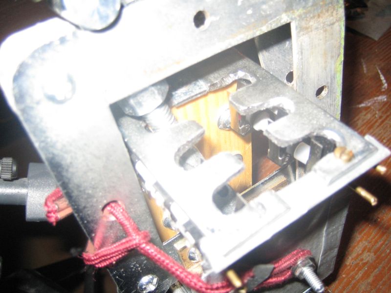

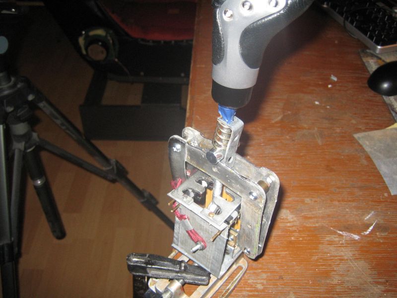

  11. fredspeed
    fredspeed New Member
    Sep 1, 2009
    263
    Northern Norway
    418Coins
    Waiting for parts for a new h-bridge and Mjoy, I desided to make a h-bridge inspired by the ideas from diy-h-shifter-by-willynovi-working-t2323.html I have used stuff that was laying around. so the design and finnish could be better, but it feels pretty realistic. I have mounted microsvitches and hope to build a Mjoy usb controller to make it work in my sim.
    http://www.youtube.com/watch?v=mxbpnQsyICA IMG_0008.JPG IMG_0022.JPG
    Fred 8)

  15. whaleman
    whaleman Member
    May 15, 2010
    30
    Finland
    7Coins
    New topic for Pololu is a great idea, I'll do that. And good luck with new components!
    About your mechanics, looking very good so far! I really liked your tornadoblu style design. It's not a bad idea to make something a bit simpler and then make evo II sim later if required. IMO adding a yaw axis to tornadoblu style design would be very tempting as there wouldn't be problems with monitor's position like in fixed monitor setups.
    I can see you have put effort in that H-shifter of yours. Little bit of fine tuning in the exterior side and it will also look great. :thbup: Much more complicated mechanics compared to mine H-shifter, but I bet yours feels more realistic. I'll post some pics of mine in my topic some day.

  16. fredspeed
    Sep 1, 2009
    263
    Northern Norway
    418Coins
    The h-shifter is not very complicated to make. i used a simple metal-saw and a grinder, some iron angels, one hinge and stuff laying around. Its compact, so i will try to use a gear-rod-cover (if that is the name) to cover the mechanics. If a standard dont fit, i make one myself :yes:
    Fred

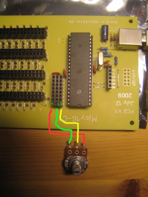

  20. fredspeed
    Sep 1, 2009
    263
    Northern Norway
    418Coins
    I have learned that its never a bad idea asking questions. I bought a finished Mjoy from our friend Frakk here, and it looks very pro! Now I want to be 100% shure to not doing anything wrong with it. so here is the questions: Is there a risk connecting pots wrong besides burning the pot. i think i know how to connect it but must be shure.
    OK?
    Fred
