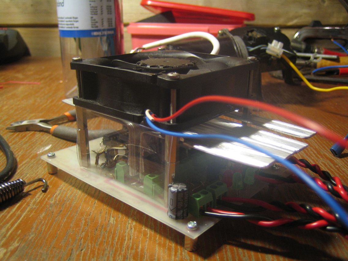

    I am starting this year finishing my second h-bridge, and today I am planning to test it. Things I have done since I destroyed my first:
    The motors and pots are mounted so the motors can run unlimited without breaking the pots. I have done this to avoid the motors to stall and burn fets. The pots is connected to plattform not to motor.
    I have connected amp-meter and volt meter. When I test motors on battery the ampmeter peaks quikly to 30 amps, but is stable at 5 amps whith no load. When starting both motors at the same time it peaks up to near 60 amps very shortly, and its stable at 10 amps. When I but some load at the platform the ampm does not rise more than a few amps. seems to me that starting motors draw most current even without load. Guess this is basic to most of you, but does this seem ok.
    I have made som bigger heatsinks
    A friend of mine recomended thinner cables because they could limit some of the peaks. Is that right? I am also twisting the cables as recomended somwhere in this forum
    And ofcourse now I am using logic level mosfets...and small fuses (7,5 amps)
    I will also follow the starting sequense R-eng posted at page 9.
    Anything else I should consider??? I hope not to make any fireworks today because there was enough fireworks last night!!! :cheers:

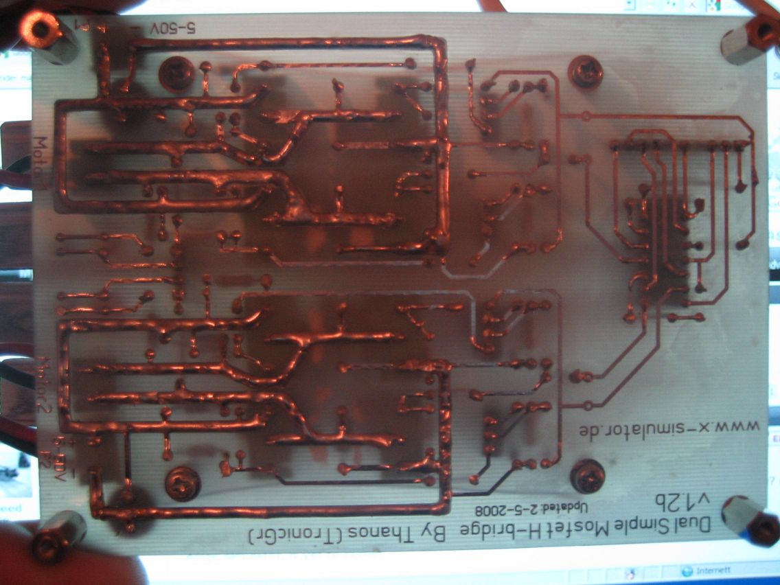

    Seem to me I am not able to build functional h-bridge. Status now: i have build two h-bridges. One is working at motor 1 and the other only working on motor two. Both of them seem to have a shot thru, i did not even get time to try the last one with load before fuses burned. No heat on the heatsink either, so I really dont know if the mosfets are gone, but the fuses burn even with no motor connected, so i guess the are. Frustrating to almost have made it, but I think i must deside to cancel this project, at least with Thanos h-bridge. I think I need a break, and when i get motivated for this again i will look at the progress in other solutions here as the polulu and welleman.
    Fred

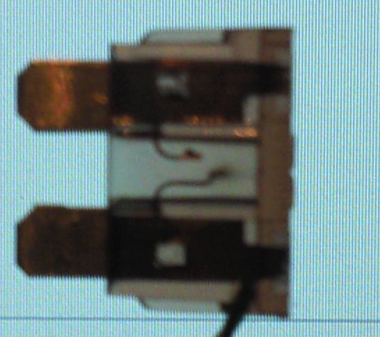

    Well well,,, Cant ceep my hands from my project while i have available time. Now i am waiting for part for a relay-motor driver,and while waiting i had another look at my h-bridge. Testing it with a small dc-motor (without fuses) both sides seem to be ok. That leads to some questions:
    Why does it work with small dc, and burn fuses with my viper-motor?
    I guess there is no shoot-thru/burned mosfets if it works with dc-motor?
    can it be something wrong with my vipermotor, though its is working fine connected to battery?
    I am using 7,5 amp fuses.
    maybe there is still hope for this bridge!?!?!

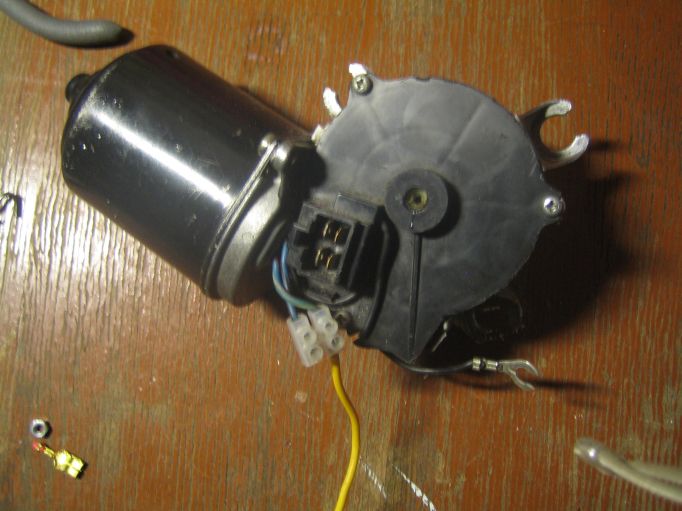

    My vipermotors have a cable that vas connected to the housing/mounting bracket. and two cables - and + I have been using those two cables. In the picture you see the gnd-cable to the right, and the cables I used is to the left with the socket on. Search engine here dont work well, but i will find that post about isolating. i believe i have read about it somewhere :yes:

    And here is a couple of pics of my h-bridge, in case you wonder how my work looks like. :D h-br-b.jpg h-br.jpg

    You have to use the black cable as well!
    Connecting both cables from the h-bridge to the socket is wrong.
    I cant tell just from the picture. But Imho the two wires on the socket are + for slow and full speed (when mounted in car). I just dont know if the motor has full spead with either one of the wires connected, or both together.
    But for sure is, that the motor must not move, if you connect one of the power supply wires to the housing.
    I couldnt find the thread either, but here is a german one with lots of pics.

    So I have learned something today also! still not tried with h-bridge, but connecting one of the wires to black and housing turns the motor. So if I connect both the wires on the socket there will be no sparcs only more speed? must take a deep breath before I try :lol:

    egoexpress is right, the 2 connections of the socket are the (+) high/low speed, and the casing/ground is your (-).
    The case doesn't have to be isolated, you just have to make sure it doesn't touch anything conductive.

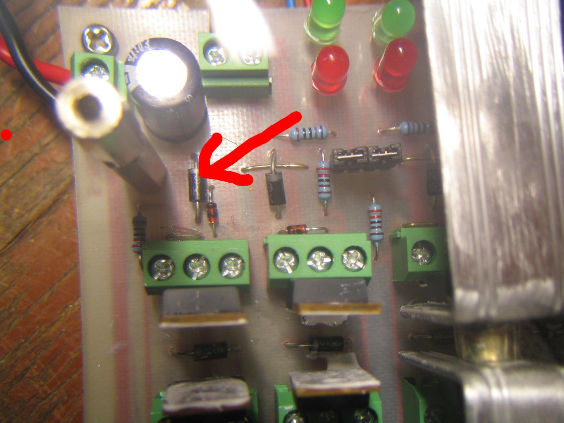

    30 min. with my project today... I do not know what is the best way to use the multimeter to test components on my h-bridge (Still waiting for relay-driver parts) but i checked resistance on the diodes today and compared them. The diode pointed out on the picture shows 2k, but the other diodes, showing 6k. On my other bridge where this side is working, the diode also shows 6k. Could this be the reason this side of the bridge do not work. I guess its a faulty diode? happy for any feedback on this and tips on checking other components too.
    Regards Fred

    418Coins
    Strange... When the diode I pointed out is replaced, it still has a resistance of about 1,9k. When the diode was unsoldered, it shows 4,8k and the same diode on my other h-bridge also show 4,8k. How is this posible? also replaced the capasitor next to it, but no change!
