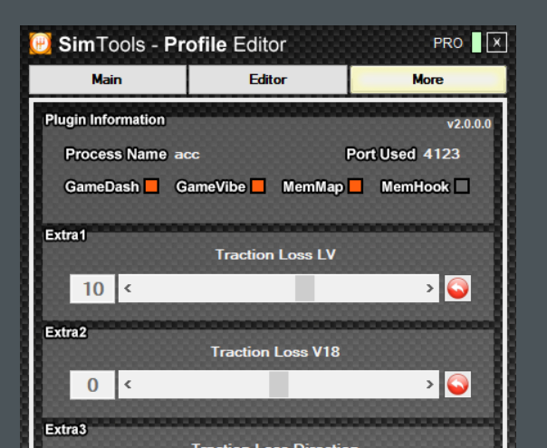

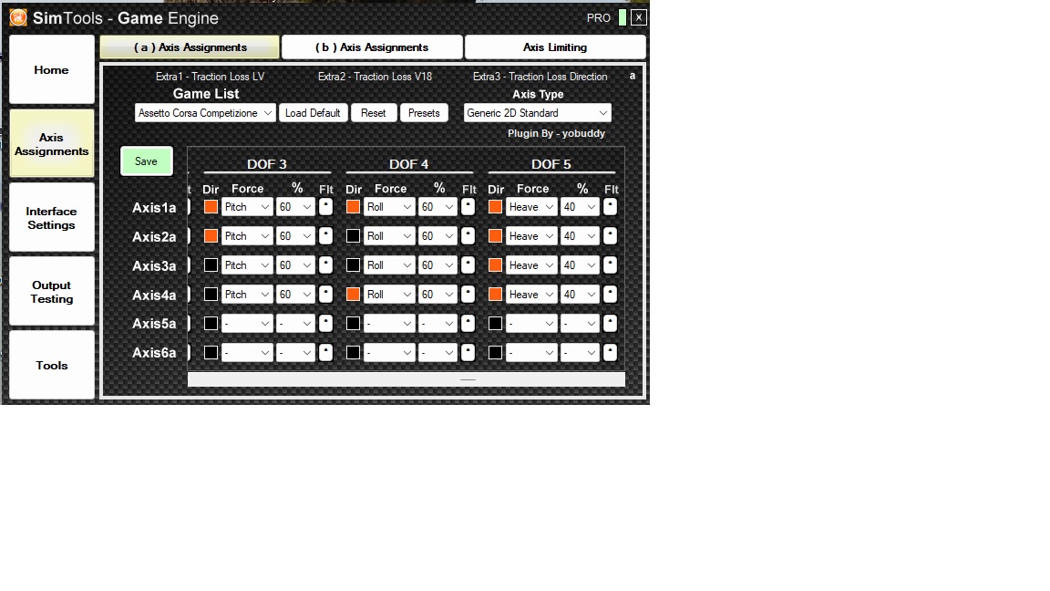

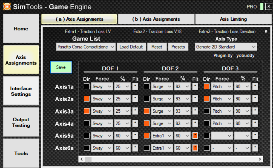

    In axis 5 it's for the front actuator, and the front traction loss, it's extra 3, axis 6 for the rear. All it depend of your feeling, you can choose extra 1 or 2.

    Thank you for this plug in but I have a question, the turns are not reversed, i.e. I follow the curve of the turn instead of going in the opposite direction with the centrifugal force and I can't increase the surge effects
    Thanks for your feedback

    Hi @yobuddy,
    Because it was very easy to use 6 axes with SimTools 3 and 2 additional axes with SimTools 2, I was able to control all 8 actuators individually.
    Question:
    I changed the SCN ID from 0 to 1 and entered Interface Settings > Assigned Axis 1b. SimTools 2 works, but I couldn't get it to work with SimTools 3.
    Question:
    How can I set different speed and acceleration for 1a and 1b using a single menu?
    Thank you in advance.
  15. yobuddy
    51,704Coins
    +5,204 / 19 / -0
    Hi @Shige Tanaka,
    SimTools v3 will allow for 18 individual axis to be configured and assigned as needed.
    In SimTools v3, we can go to B Axis Assignments, and set the Min/Max input source to Set #2.
    Then under Min/Max Tuning, we can select Min/Max Set #2, and adjust the settings as needed just for our B Axis Assignments.
    The v3 SCN interface was built from the v2 one, so I can't think of why it would not work off hand, so I will take a look at the SCN v3 interface and see if I see any problems.
    Unfortunately the settings on the form are for all of the actuators attached to the interface. Most people need 2 scn's to built a chair, so this has not been a problem. So ror now, you would need to use the SCN on its own usb adapter and Interface setup for different settings. A custom SCN interface could be produced for separate settings in the future should it be needed thou.
