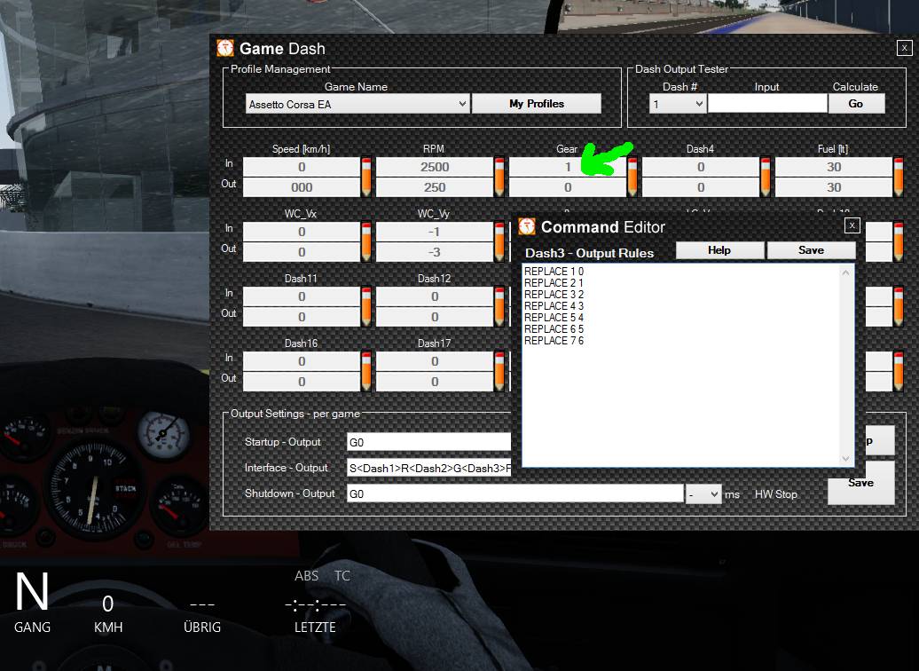

    3DOF, DC motor, Arduino, 6DOF
    i used plugin 3.0.5.0 with rc 1.0.6
    in gamedash the gear is one higher as in game. i replaces the value in gamedash but his is not the best solution.
    any ideas ?

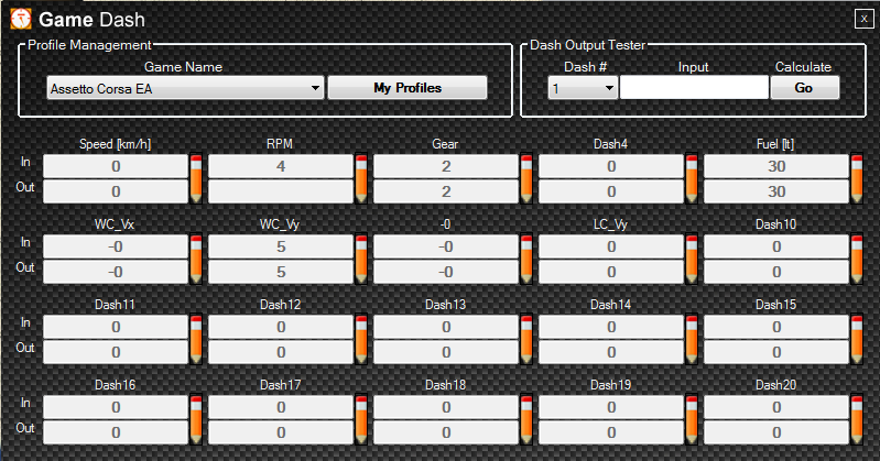

    now i test rc 1.08 with plugin 3.0.6.0 but the same error:
    • gear is 1 higher as in game
    • no data for shift light, fuel %, car model and trackname
    anyone have ideas ???
    DashApp Data:
    Speed [km/h], RPM, gear, shift light, fuel [lt], fuel [%], car model and track name. Additional values are feasible, yet not implemented.

  16. RacingMat
    2,234
    21,099Coins
    I have the same behaviour: shift is offset +1
    Maybe du to the new version of AC
    Let's ask @value1 if he can fix it?!

    Could it be that this was the case from the very beginning? Reverse = 0, neutral = 1, first = 2, etc.?
    I was too lazy to check the proper implementation of the new wchars in the plugin (end of August). So there might be a bug that needs fixing…
  18. value1
    Jan 9, 2011
    2,192
    Zug, Switzerland
    14,294Coins
    +3,363 / 13 / -1
    I checked the old Assetto Corsa Tech Preview v0.9.9 and already there it was like Reverse = 0, Neutral = 1, First = 2, etc.
    The car model and trackname, etc. will be fixed soon.
