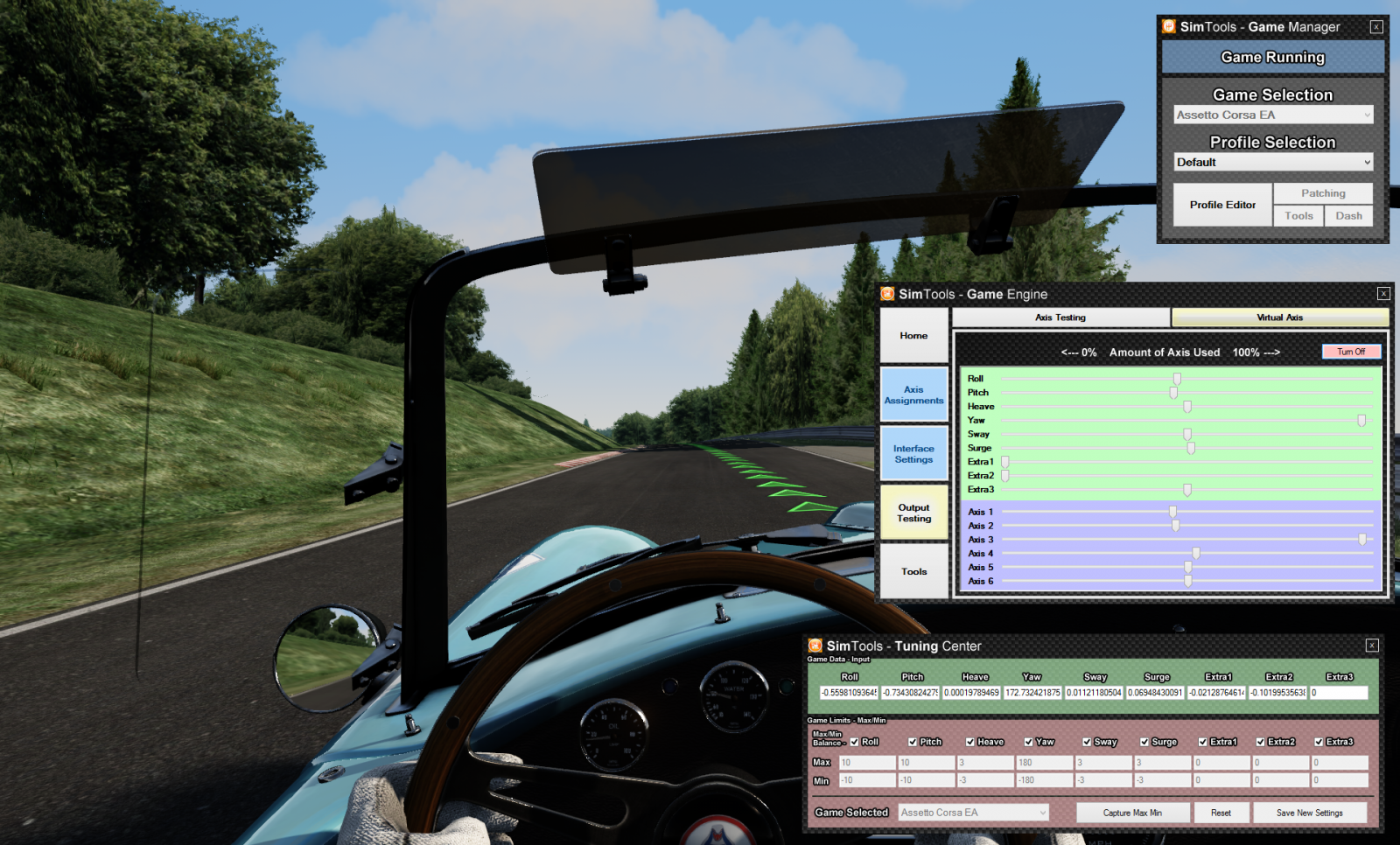

    Hi everyone, just got back to the simulator after a couple of months and am experiencing some strange outputs in AC.
    When the game starts everything initializes ok, that is both axis power up and centre. When you go to the track and the car loads the sim leans to the right and all subsequent motion is done from this angle.
    My first reaction was to go to the tuning centre and have a look at the settings, roll axis was set to +5 max -5 min, however the data was coming in at -3.5 which explains the lean to the left.
    To make matters worse I am only getting outputs from the program on roll, pitch and heave, everything else steady on zero output.
    I have unpatched and repatched as administrator but no luck. A similar thing has happened with Project CARS except there is no movement or data at all in the tuning centre.
    Now whilst I can appreciate that both of these are Steam downloads and always seem to be updating, this has not happened with F1 2013.
    Other programs that have been running reliably are LFS (ever reliable) and Dirt 3.
    I dont know whether it is related to the Steam updates or a conflict with the plugin. The two plugins that that are at the centre of the problem are also two that I can't seem to find on my PC. I'll have to look harder or save some more coins before i can download again.

    @shanothegreat: Everything fine here with V1.0
    You may want to increase the Min/Max values of pitch and roll. A roll/pitch of ±3° is very comon on a track. So increasing the Min/Max values will decrease the movement of your sim.
