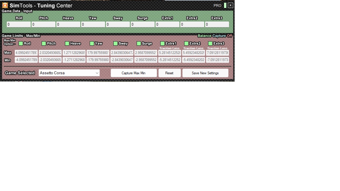

    Motion starts in an actual race, can you please post pictures of all off your SimTools settings for AC, including the Tuning Center while AC is in a race.

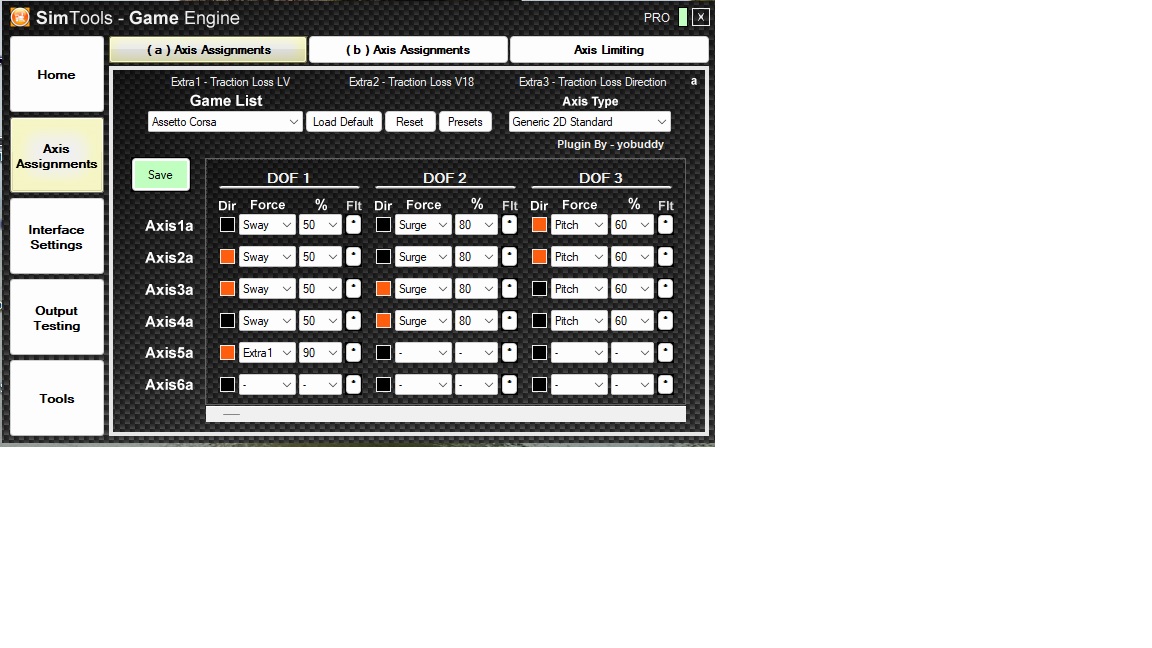

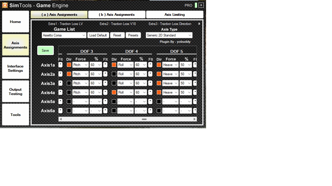

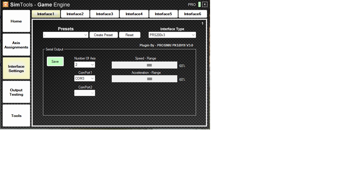

    Thanks for this plug in but I have two questions I can't seem to lower the surge for braking and increase the roll for turning.
    On the other hand, when I'm in the garage before taking the cricuit there is a big blow with the jacks and it is not very reassuring
    Any idea ?
    Thanks for your feedback

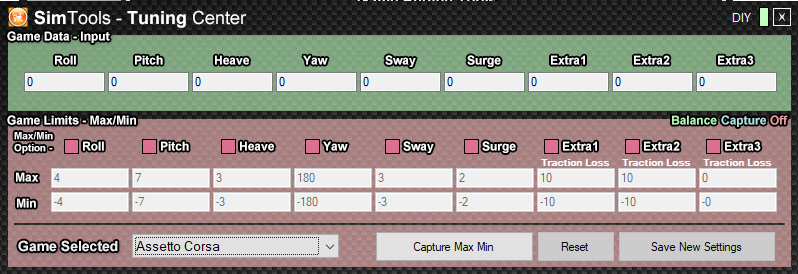

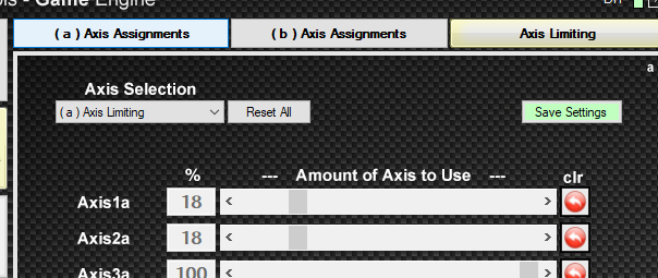

    my rig get more and more roll to the left after some turns, even if i'm running on flat road.
    The strange thing is that's not the case in other games.
    Even in virtual axis it shows the roll is on the left side even on flat surfaces.
    Do anyone know what's happening?

    [​IMG] [​IMG] [​IMG]
    TIA

  18. dgworks
    dgworks New Member
    Oct 13, 2021
    12
    - 56Coins

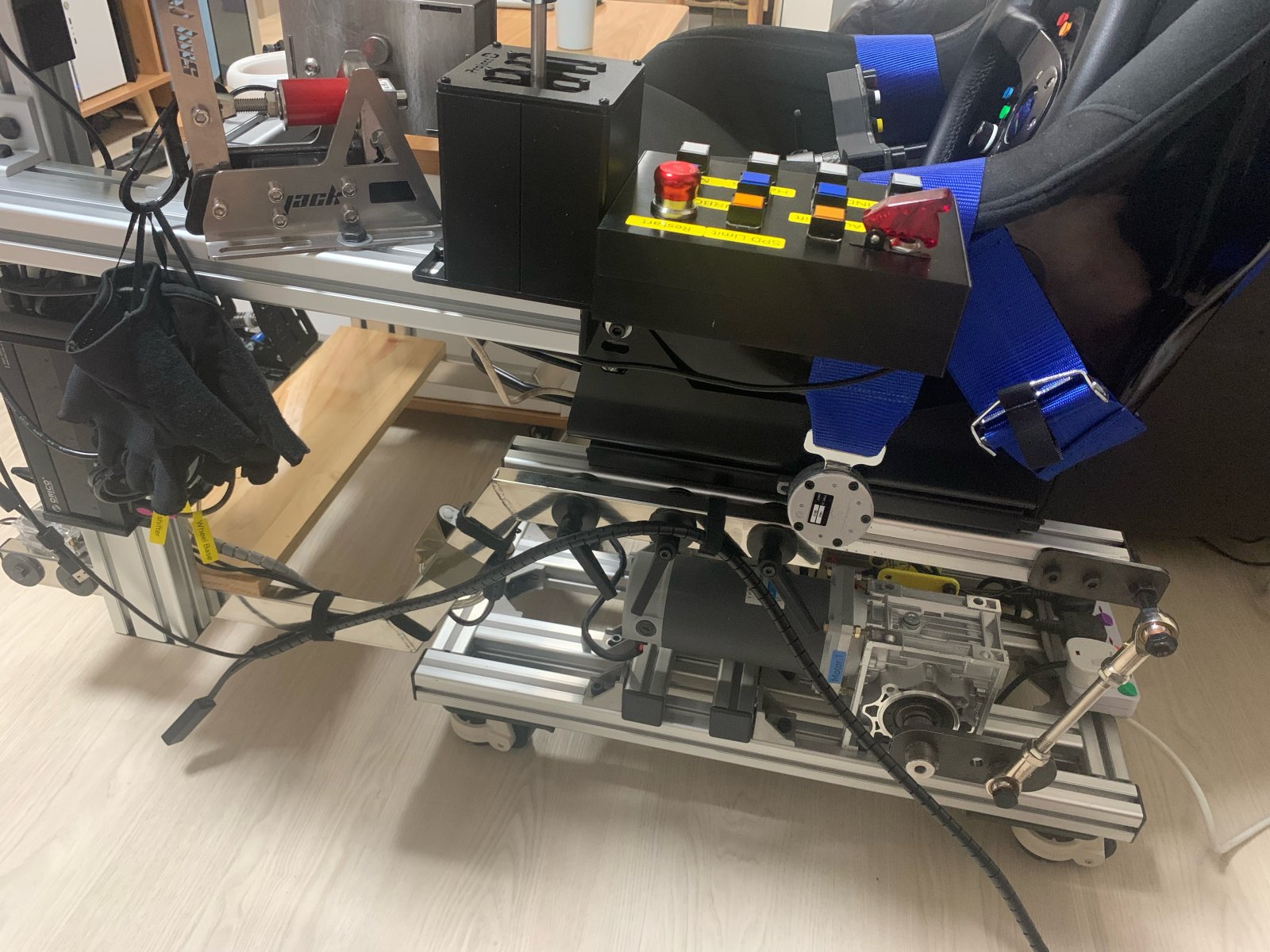

    My rig is kinda strange, the base is not that stable and i don't want it moves more than 60 degrees.
    that's why the limits

    I also noticed this when experimenting with pitch and roll. Pitch was fine and always recentered, but I found roll would not. Visually it looked like the track was flat, but virtual sliders showed quite a bit of roll. Possible bug?

    Best to set limits on the hardware control side.
