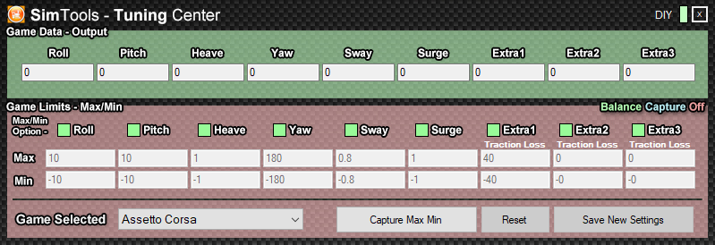

    Hello! Today I realised that something is not right with my motion. Is it the plugin? I can show You what I mean:
    Video1:
    Video2:
    I use only Kunos staff for the tests. Video 1 You can see car with medium hard suspension and quite smooth surface. Video 2 is presenting hard (more stiff) suspension car on the more bumpy surface. I've been driving slowly along the track. In my cockpit I use only sway and surge. Now take a look on the output test in the simtools. Sway and surge are really not smooth. Even if i'm not pushing the throttle or brake at all. It causes strong and short moves of my platform and with Oculus it is really bad. That is why when I started to use Oclulus I turned off Heave effects. I didn't want to have any bumpiness. Now they are back with Surge and Sway... something is wrong but what? The plugin, or something else?

    Post your Tuning center and Axis assignments please.

    Yes, of course:
  10. Nick Moxley
    17,057Coins
    +2,507 / 30 / -2
    Axis 3 and 4 .....on a 2dof ? umm what o_O
    And for running 2 forces, you sure have the Axis % turned down a lot and a rather small tuning center window, making everything rather jittery.
    If you want to monitor the Axis while racing, and your not using any of the other forces, Make them 100000 in the tuning center, That will tune out the actual movement of the sliders in the axis, Making it easier to see which Axis is acting up. :cheers

    Axis 3 and 4 are for my G-seat. But they suffer the same thing - they rumbling too much while car is going straight with same speed. "In the Axis Limiting" tab I've got everything at 100%, but I limit the Axis in the Axis assignment window if I'm right. That is why I have Axis limited to 17 and 15%. The moves are ok if we talk about limiting. I tried to put larger numbers in the tuning center for surge and sway. That made things better, but - the seat is no to dynamic as I want... The same thing if use smoothing filter. Is there no way to have dynamic moves with axis limited? Is algorithm of the plugin ok? Can I see somewhere how it behaves with other platforms?
    I'll prepare You next video with other forces put to 10000. Just the sway and surge.
