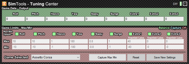

    Do a video where we can see the movement of the sim and game play at the same time.
    I am guessing that your Tuning Center values may be too low and your Axis Allocations could be higher.

    Making video will take some time. I did some quick tests and - if I put larger numbers in the tuning center jittering of surge and sway is gone but... my platform barely moves, so this is no solution.
    I tried also to put lager values in the axis assignment smoothness filter (abot 30) and it helps. Moves of the platform are not so direct but will do.
    I'm still wondering why road bump have influence on surge and sway???

    Hello, try the following:
    Put the axis assignments at 100% and in the tuning center you set it high enough so that with an F1 it does not pass the total movement that it had before, you can use boundry to limit the total of the axis and eliminate an excessive maximum movement, in emerges I have put 8% of smoothing and sway 20%, the movements are very direct and almost all the nervous movements have been eliminated.
    If you want to use heave I have put 100% and boundry to 94%, in the tuning center put a high value, I am 15, with that you have very soft tremors on the track and the pianos and potholes are strong, the track exits They are strong too, but you can drive very well with oculus.
    Try and tell me how you are doing.

    OK thx, I will try it. Can anyone tell me what is the difference between limiting axis with:
    a) Axis assignments window, % parameter near force name
    b) with boundary filter
    c ) using Axis Limiting window
  13. evolaco
    evolaco Member
    Sep 27, 2015
    264
    Spain
    694Coins
    +30 / 0 / -0
    with the limit of axes we limit the maximum useful route that the motors have, with the assignment you indicate how much of that route is going to be used in that force and with the filter it is limited but it does not reduce all the movement, it continues to move the same but when it reaches the % that you have marked does not move anymore
